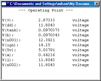

Hi Mike,
Put the circuit together but the needle only moves just above the E mark! I did use pots for R1, R2, R6, R8 and set the resistance to the values on the schematic and placed a 70Ω resistor across the tank and ground.
Not sure where to go from here!

Hi Mike.. FYI: looking back I see you used (2) LM358 chips to where I used one! I combined U1 and U2's pin layout thinking it was one chip. could this be my problem?

Hi, I missed these posts until today. The **broken link removed** with shared power pins; you only need one to drive the meter; the other is used to light the LED near empty.
Do you still have the unit set up?
Is the sender out of the tank or are you using a pot as a substitute for the sender?
I added node names (labels) to all of the critical nodes in the circuit. I used LTSpice to compute all of the node voltages if the sender is replaced with a 20Ω resistor, and again if it is replaced with a 100Ω resistor. These correspond to empty and full. Look at the two tables of voltages.
With the table of voltages at all of the nodes in hand you should be able to tell what is not working. Note that I did not intend for you to use pots for R1, R2, R6 and R8. If you had used the 1% fixed resistors, the only one you might have to tweak is R6. If you just put pots everywhere, powered it up, I dont think you can set them to the correct values after the fact. If you preset them to within a % or two within the value on the schematic, you might stand a better chance.
