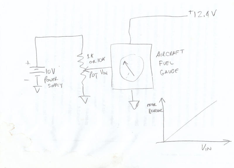

If the resistances that Scopeman reported are correct, then the gauge is expecting a voltage input (not a varying resistance to ground). That was the open question, and so now I would like Scopeman to connect a 1000Ω pot (wiper to the gauge input, top end to 12.4V, bottom end to 0V) and plot gauge reading vs voltage at the pot wiper. Start with the wiper at the ground end, and ramp it up slowly, record the gauge input voltage corresponding to E, 1/8, 1/4, etc.
For the sender, I recommend making a voltage divider consisting of a fixed 1% resistor (say a 1000Ω) connected between 12.4V and sender terminal. Connect the sender ground to 0V. Record the voltage at the sender terminal vs number of gallons added to the tank. This will give a plot of voltage from the sender and let us assess the linearity.
With a plot of gauge reading vs voltage in, we can implement the required gain and offset to fit the end points. If the linearity is too far off, we can add a diode network around the opamp to "bend" the transfer function to get at least a three point fit (middle and both ends).

I drained the tank and drew up this schematic. is this the test point (TP) to obtain said voltages? don't want to blow myself up on what fumes are in the tank!! He He..
Thanks..
Kendall
Yes, that is the test configuration.

It may not have been clear several posts ago, but in addition to the fill test, I want you to do a separate test, as shown below:

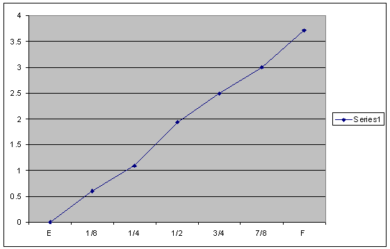

Hello Mike, did some test with the meter!
using 10v thru a 10k ohm pot I have voltages at locations needed:
E=ov
1/8 = .6 v
1/4 = 1.09 v
1/2 = 1.94 v
3/4 = 2.5 v
7/8 = 3 v
F = 3.72 v
been very cold here want to drop the tank and replace the sending unit with a new one I had and start adding the fuel!
now I don't know how accurate the power supply is and the digital meter but I will make the test with my other meter as well.
Looks good in Excel.
Ken

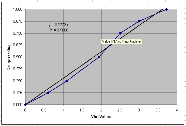

Looks good, but get the voltage for 3/8 and 5/8. Here is a straight line fit.
Be sure to use the same voltmeter when you do fill-tank-a-gallon-at-a-time test
