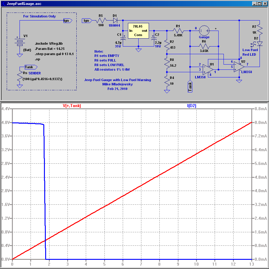

Try the test I posted. Hook +12V to +; Hook 0V to the instrument case; Hook the wiper of the 1K pot to (); Hook the ends of the pot to +12V and 0V, respectively. Slowly move the pot up from the ground end while recording the voltage between () and 0V. Make a table of gauge reading vs the voltage input.

Hi Kendall,
Ok, just to confirm, the Power supply was set to 12V. right?
The connections to the gauge were like this:
Power supply +12V to Gauge Plus terminal
Power supply 0V to Gauge Can
Middle terminal of 10K Pot to C
One end of 10K Pot to +12V
Other end of 10K Pot to 0V?
Confirm these connections

Kick me for being stupid. I went back and re-read the entire thread and I see that I confused the entire issue by thinking that the gauge had an internal connection to the Can, which is how car and aircraft usually work. Your Ohmmeter test indicates that there is not a connection to the can in your gauge!
However, there is obviously something else inside the can beside just a simple D'Arsovol meter movement. This is indicated by the very high resistance (825K) from + to C.
Without opening the can to see what is inside, here is my last ditch suggestion: Set the DC supply to 14.25V, which will be close to the Jeep's system voltage with the engine running above idle. Connect +14.25V to Gauge +. Using your 10K Pot as rheostat , connect wiper to C and one end of the pot to 0V.
Turn Pot until needle just moves off the empty stop (so the needle is noticeably above empty). Connect your DMM in DC voltage mode and read the voltage from C to 0V (i.e. across the pot). Record the voltage. Without disturbing the Pot wiper position, momentary disconnect the C connection from the pot, and read the pot Resistance.
Repeat this for 1/4, 1/2, 3/4, and just barely short of Full Scale.

Looks like it is a fairly linear voltmeter, ~870Ω/V, requiring 4.5mA through it or 3.95V across it for full-scale,

The Final Circuit
Ok, here is my circuit. It uses the sender model developed earlier (see the previous postings where EXCEL is used to develop the Sensor Resistance vs Gallons equation).
A 78L05 voltage makes a reference voltage of ~100mV, which appears across the Sender. As the resistance of the Sender changes, the Sender current is a fairly linear representation of the float position. The Sender current also flows in the feedback path around U1 LM358 opamp, where some of that current flows through the gauge. Resistor R6 shunts the gauge to calibrate the FULL reading. I simulated the gauge reading with the input voltage at 12V and 14.5V, and the 78L05 regulates so that there is no discernible effect on the gauge reading. The input network should protect against transients found in automotive electrical systems.
Since the resistance of the Sender is not zero when the Tank is EMPTY, it is necessary to inject some current into the non-inverting input of U1 to zero the gauge when the tank is EMPTY. Resistor R1 sets the EMPTY reading. Bad news is that R1 and R6 interact, so if one is changed, the other will need to be changed, too. I suggest that you buy 1% resistors as shown in the schematic. That way, no adjustment of the FULL and EMPTY readings should be necessary.
Since the LM358 comes two per package, I used the second one as a comparator to light a Red LED when the fuel level drops below about 2 gallons. Look at the plots. The Red trace is the voltage across the gauge as a function of the number of gallons (Xaxis). The Blue trace is the current through the LOW FUEL LED. I would use an ultra-bright Red LED for good daylight visibility.
This has been a fun project. I would appreciate some feedback on how it works out.
