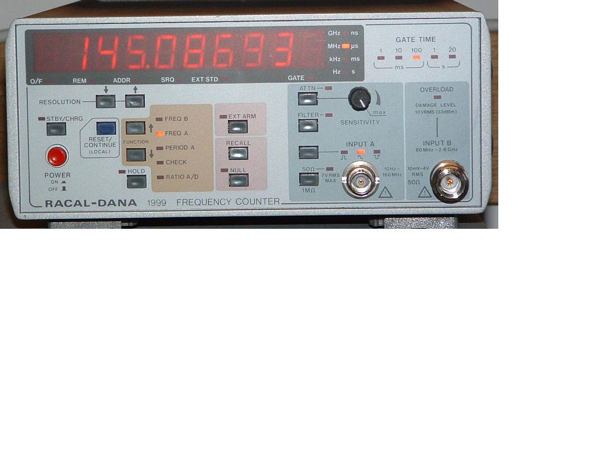

My frequency counter (see attached piccy) has two inputs, Input A which is rated up to 160Mhz but will work to 250Mhz if you ask it nicely, and Input B which is rated to 2.6Ghz but will go to over 3Ghz.
Input A can be selected to have either a high impedance input (1Mohm) or 50 ohm.
Input B is fixed at 50 ohm.
One of the reasons for the 50 ohm impedance is that many of these counters are used in RF applications where 50 ohm is the standard for signal sources, loads and test equipment.
Using a high impedance at a high frequency is a bit of a non-starter because the stray capacitance, and the capacitance of any connecting cables will swamp the circuit under test and kill the signal you are trying to measure.
Your idea of using an emitter follower probe is a good one, but better still use and FET as a source follower, that way you can have a high impedance input and a long cable (with lots of capacitance) connecting to the counter.
Another thing to consider with "long" cables at high frequencies is standing waves.
If the cable as a quarter wavelength long at the frequency of interest, it is possible to have a short circuit at one end of the cable and the other end will appear as an open circuit.
Yet when the length is a half wavelength, a short circuit at one end shows as a short at the other end.
Weird stuff until you have seen it a couple of times.
Which brings is back to the 50 ohm inputs. If the system is properly matched to 50 ohms throughout, no problems.
