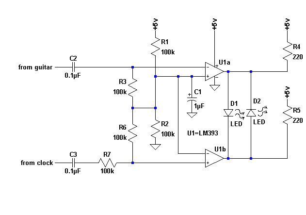

rite... im trying to build a guitar tuner and ive come across a problem....
i need to compare two frequencys.... one provided by an oscillator and one provided by an external source (a guitar and mic).....
i need an output from the frequencys so i can turn an indicator on when the frequencies match as much as possiable....
ive thought about using beat frequencies but im running into a problems :( so i need some more ideas to consider....
so ne suggestions.....?????

Mount the LEDs right next to each other. Tune until the beat frequency stops. If you don't have 5 volts available, select the values of R4 and R5 to give you about 10ma in each LED when it is on (the comparators can only sink about 10ma each). Otherwise, it should work on any voltage from 5 volts to 30 volts.
The LEDs have no individual significance. We could use one LED and a diode bridge, but this seems simpler.
Thanks, Claude. What if it doesn't work. :oops:

I wanted to put a small incandescent bulb between the clock and the guitar comparator, but considering the amount of bidirectional current required (requiring push-pull emitter followers or some other contrivance), I decided the two LEDs were simpler.
