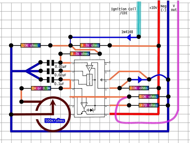

Hello, I have a source (wire from cdi to coil) with 100-250VAC with frequency from 150 - 700Hz depending a rpm on my bike. Im trying to do something like a shift light with one turned LED on some rpms.
I tryed with LM2917 and several options, but it doesn work :confused:
Do you have a any suggestion please?

The circuit you posted with the LM2907 tach IC does not work because the input (pin 1) of the LM2907 needs a DC path to ground, usually provided by a magnetic pickup.
Try the circuit after adding a 100k resistor from pin 1 to ground.

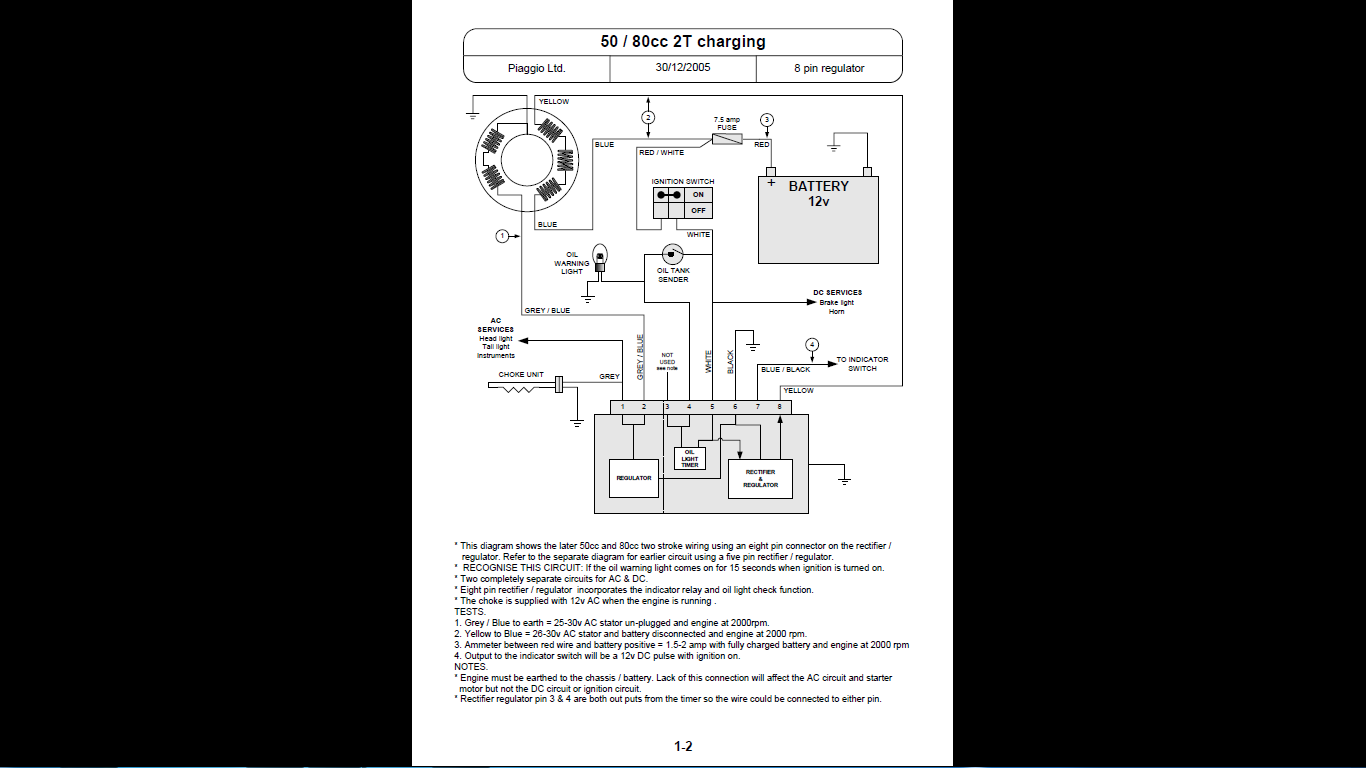

OK, now i will show you a service manual for bike, I tryed to take a signal from green wire primary (i tryed from pickup too): http://www.dropbox.com/s/cdtp9i3wpnantf6/Screenshot 2014-05-28 11.29.00.png

Here is a frequency result from green wire to ground, voltage is from ~150V - 200VAC
2000rpm - 150Hz
3000rpm - 250Hz
4000rpm - 330Hz
5000rpm - 450Hz
6000rpm - 500Hz
7000rpm - 600Hz
8000rpm - 700Hz
9000rpm - 1300Hz

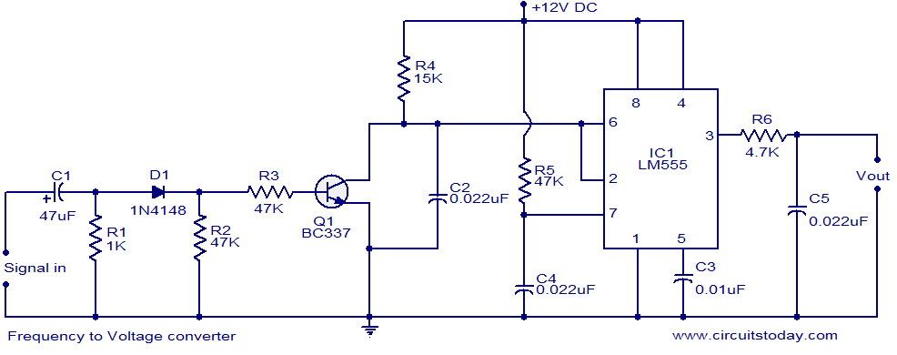

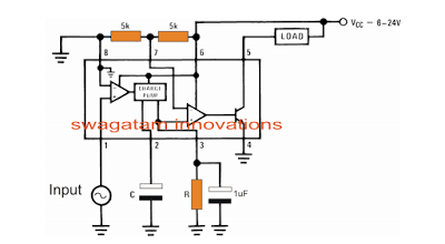

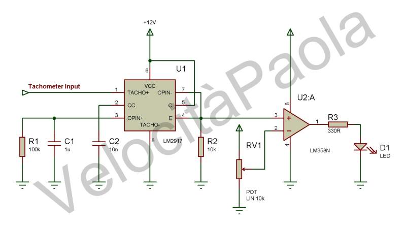

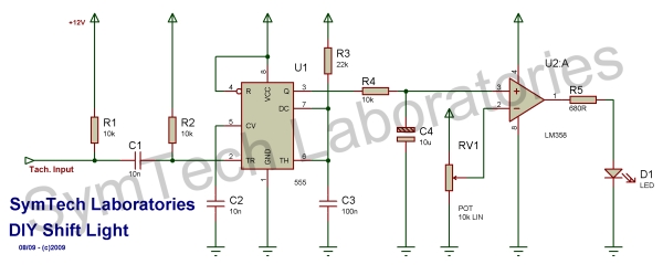

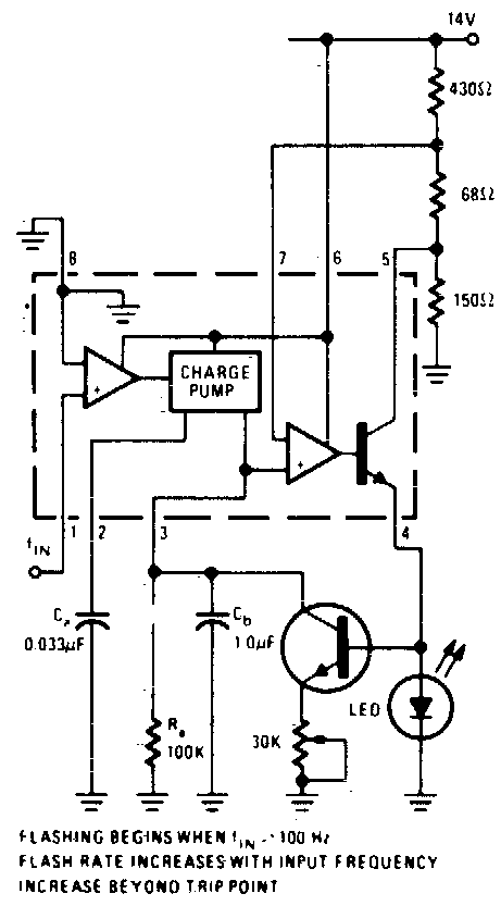

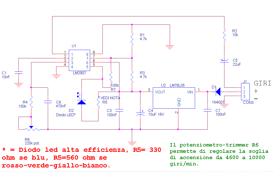

And These are schemes by which I worked:
http://www.next.gr/automotive/automotive-circuits/overspeed-indicator-l12548.html
http://www.piergm.com/elettronica/shiftlight.htm
Now Im trying to do it this:
or this:

Please attach your schematics to your posts HERE instead of over at UPLOADS where we cannot open or at PHOTOBUCK that takes a long time to open.
Did you try adding a resistor to ground on the pin 1 input of an 8-pins tach IC so that it has a 0V DC reference voltage? The other input is pin 8 which is connected to ground so its DC reference voltage is 0V.

I tryed with this, 2x 10k from input to ground.
Voltage on exit from lm2917 is same like on power supply (+12V), no changes. I know that voltage on exit must be variable, depending a freq on input.

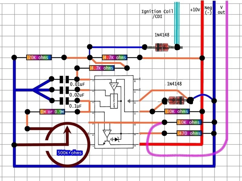

Today I worked with this schematic (IC is lm2917, 14pin version, a second diode (zener) is 1N4148):
pcb_lm2917-jpg.86514
Nothing happen again, 0V on out is always, but between input (ignition coil wire) and ground is 1.6V.

Since you used an LM2917 IC in an 8-pins case, its 7.5V zener diode was blown up since you connected it to a 12V supply. The heat might have destroyed the IC.
The circuit layout posted in post #10 shows an arrow instead of a 1N4148 diode at its input. It also shows an arrow instead of a diode at pin 11. These diodes might be backwards.
Please post the schematic instead of the circuit layout.

I do not know what are the voltage levels of the pulses from your ignition coil.
I do not know which end of the 1N4148 is the cathode since it is not the symbol for a diode. It seems to be backwards.
I do not know if the other diode is a zener diode and I do not know its voltage rating. Again I do not know which end is which.
From 150 to 200VAC.
Both diode are zener diode, and both are 1N4148.

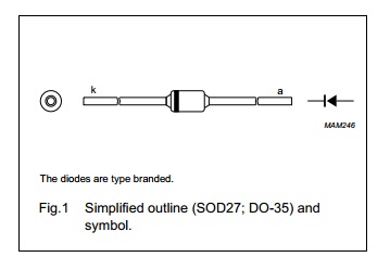

A 1N4148 is not a zener diode.
From 150 to 200VAC.
Then you have destroyed the LM2917 because its datasheet says its maximum allowed input voltage is only +28V.
The diode at the top is connected backwards so it passes the high voltage to damage the input of the IC but it blocks a logic low so the IC will not work even if the voltage is reduced and the IC is replaced.

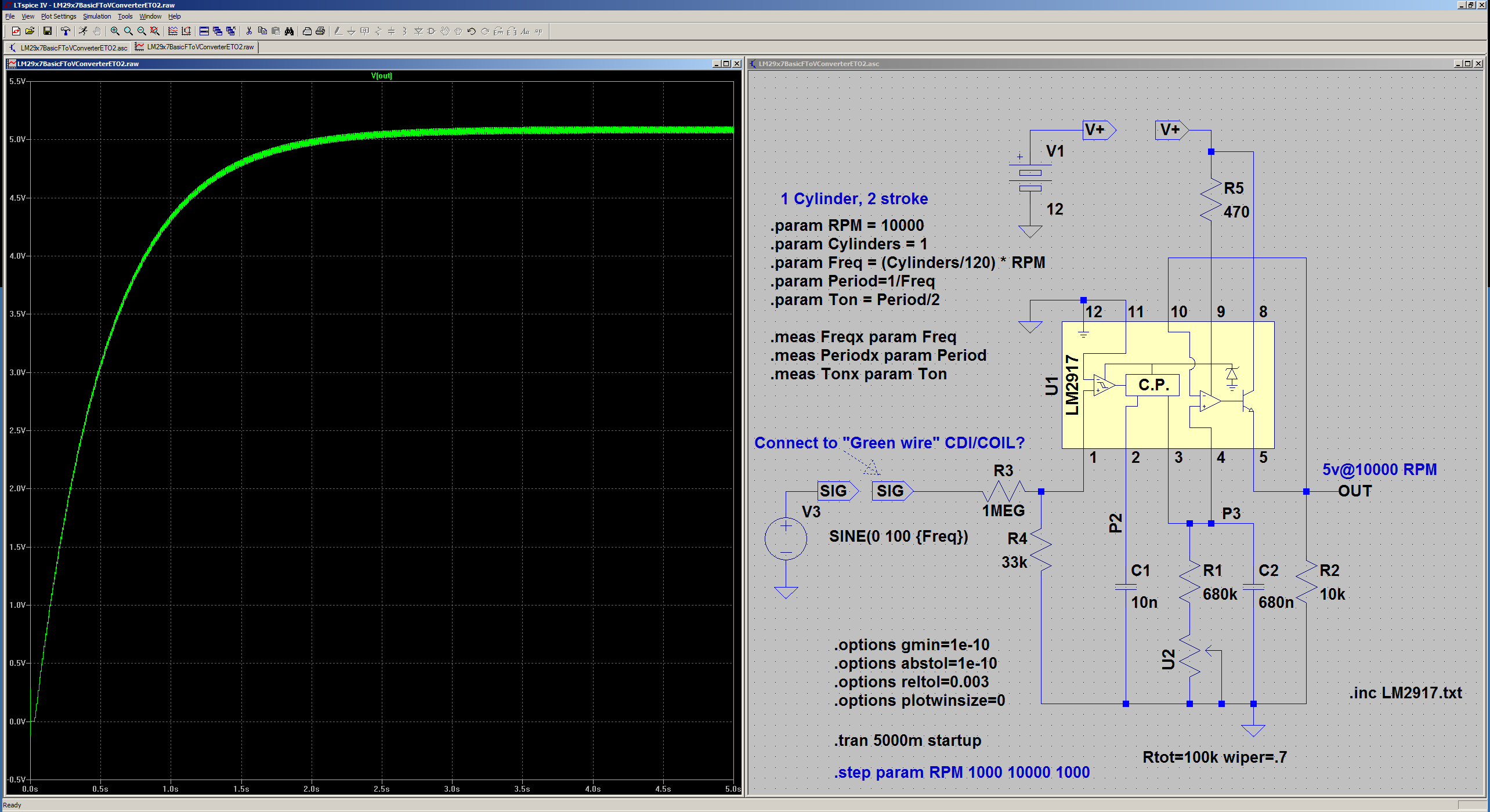

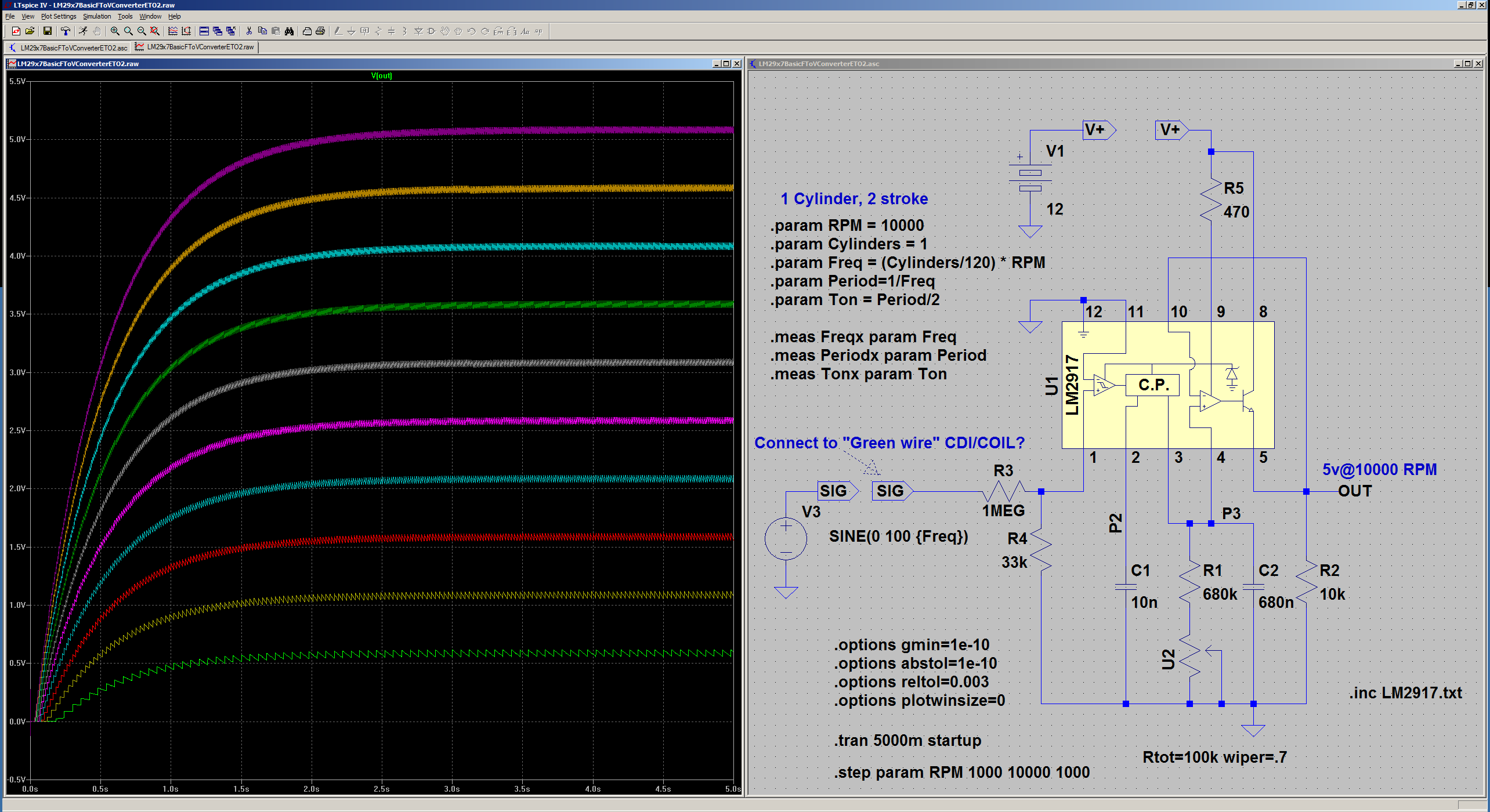

Hi
Here's something I threw together.
I'm still not sure what the OP wants for LED indication. Just light up between a certain voltage range?
Output is ~500mv per 1000 RPM
One image at 10000 RPM
One image stepped 1000 thru 10000 RPM
eT:)

He is making a "shift light" that lights at a certain engine RPM when the gears should be shifted to avoid over-revving the engine.
The datasheet for the LM2907/LM2917 shows a "normal" engine application but the inputs are a magnetic variable reluctance pickup or breaker ignition points for car engines.
