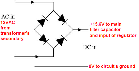

Here is how the bridge rectifier should be connected:

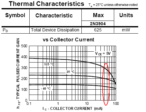

Please don't base your assumptions purely on the typical values listed on the datasheet.

Yes 200 is typical but what if it's the maximum which is 300?
That's 52.3mA giving a power dissipation of 471mW, causing the transistor to rise to 119.2°C (assuming 25°C abient and a rise of 200°C/W given on the datasheet).
audioguru said:
If it is at its max temperature then its gain is 280 and its dissipation is only 430mW. Its max rated dissipation is a lot more at 625mW so it is fine.
So the at the higher temperature gain has increased by 40%, the gain will go up to 420. Now it's passing 73.3mA, giving a power dissipation of 659.5mW causing the transistor to rise to 131.9°C which is above it's maximum rating of 125°C and given you're supposed to derate by 5mW/°C the transistor is toast!
That is at a collector current of only 10mA. The gain drops at higher current.
It is rated to have a dissipation of 625mW in an ambient temp of 25 degrees C. So its current can be 625mW/8.8V= 71mA then its current gain would need to be 413. I don't think any will have a current gain so high at the high current, even when hot.
No, most transistors won't but some might, it's the same old story, typical values on a datasheet aren't reliable especially when a transistor's gain is concerned.
