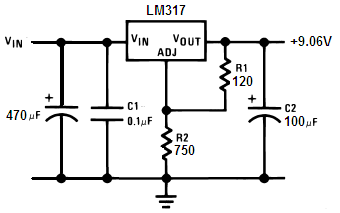

What type of transformer should I use for 9 volts regulated supply for the FM trasmitter and receiver? I know 12v-0-12v but how many VA? 8VA? I want it to be small.
That will be fine, either use half the windinng and ignore the centre tap or use two diodes to make a full wave rectifier. You'll also need an LM7809 or LM317 regulator to get the 9V supply.

My FM transmitter draws about 60mA from 9VDC. For a 12VAC transformer to give 60mADC it needs 12VAC x 1.414 x 60mA= 1VA from the transformer. You probably won't find a mains trasnsformer as small as that.

LM317 is an adjustable voltage regulator, I've just simply gone through the datasheet, this is the way to calculate [latex]V_{{o}}=V_{{ref}} (1+ {\frac {R_{{2}}}{{R}_{{1}}}) [/latex] and it says that the product of adjustment current and R2 can be neglected.
So can I just do calculation to get 9 volts?
The dropout voltage of an LM317 regulator is when it is no longer regulating and its output has dropped 0.1V. Most of them have a dropout voltage of 1.6V at 100mA but with others it is higher but how high is not shown. They have their spec's listed with an input voltage 3.0V and 5.0V higher than their output.

So, if I use a 9-0-9 transformer, it might not be working for current higher than 100mA?
If you use a 9-0-9 transformer then the peak is 12.7V and the voltage at the main filter capacitor is 12V. There will be a little ripple but the transformer's voltage will be higher than its rating because it will not be fully loaded. Then there will be plenty of extra voltage to avoid dropout.
Make an LM317 circuit with 470uF for the main filter capacitor for a 100mA load. Use 1000uF or more for higher load current. The 100uF capacitor at its output is already in the transmitter's circuit.

Oh, then I can remain the 9 volts transformer, with center tap rectifier. Is 100mA enough for FM transmitter, super regenerative and PIC microcontroller?
Is protection diode needed as shown in the datasheet?

The datasheet for the LM317 says that a protection diode is needed from output to input since the output capacitor is big, to protect in case the input is shorted. Add it if you want but I don't think anything is going to short the input.
Okay, thanks.
