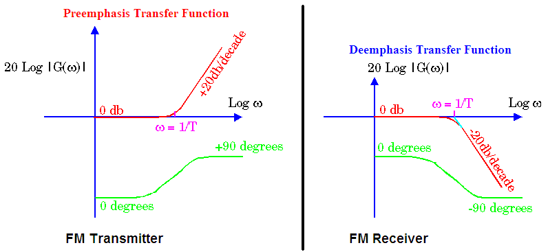

Now getting back to over deviation. Even without pre-emphasis the high frequencies will drive the frequency swing harder at high levels. That is why if you don't use pre-emphasis a typical voice signal will sound tinny. So once again you have it backwards. It's a low pass filter isn't it? So it is designed to reduce the highs in a transmitter but any frequency that deviates more than 75 Khz in the transmitter will sound like trash in the receiver. In fact the receiver quality will have alot to do with it. I've noticed that a cheap receiver will be forgiving because it does not have as sophisticated filtering, though you may hear your signal cut in at the next channel up or down.
Nope, you have it backwards. If you don't use pre-emphasis then a voice will sound dull and muffled, not tinny.
Pre-emphasis emphasizes the high frequencies in the transmitter then cuts them back to normal in the receiver, and also cuts hiss. It is used to increase the signal-to-noise ratio since high audio frequencies are at a low level in music and speech.
It is very difficult to design a stereo FM transmitter that boosts 15kHz by nearly 20dB then cutting audio at 19kHz down to nearly zero to avoid beating with the 19kHz stereo pilot.

mr.gone said:
That's what de-emphasis is for
All FM broadcast band radios have de-emphasis (treble cut) to cancel the pre-emphasis (treble boost) done during transmit and to cut hiss.
