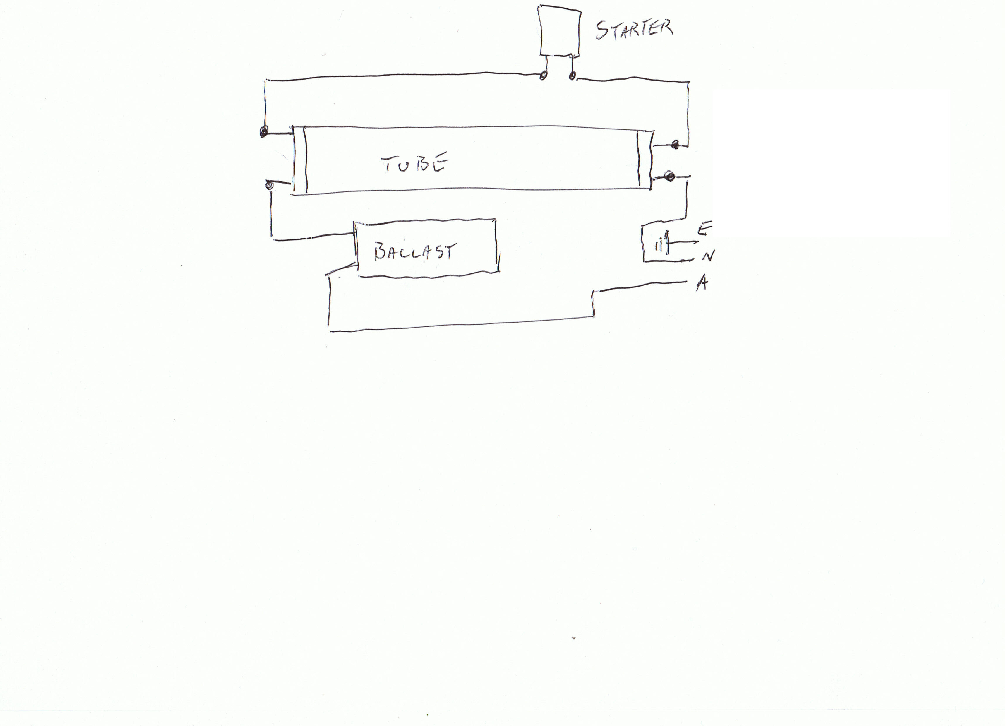

From the size of the screen you took apart, I would assume that tubes would be in the vicinity of 11W-15W. They should hook up the same as any other tube. Apology for the crappy drawing. Haven't learnt Multisim yet. Be sure to earth the chassis of the light you assemble as the mains can be fatal and the HV of the ballast as well. Haven't taken a screen apart myself, but the tubes should be just low wattage for backlighting. Hope it helps. flouro.jpg
