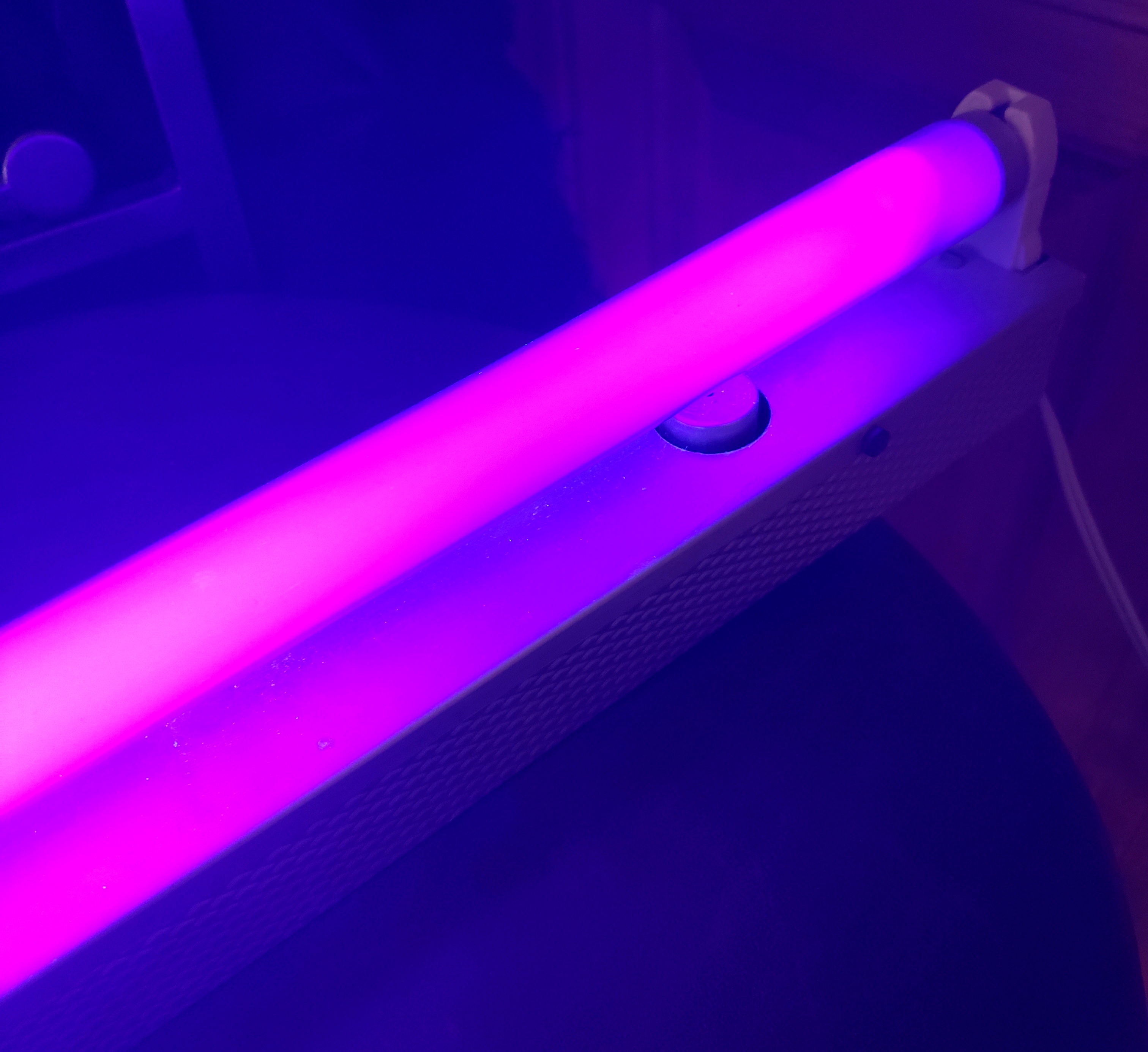

I made this when I was 9. Still works. And I'm old.
Black Light Project 1977

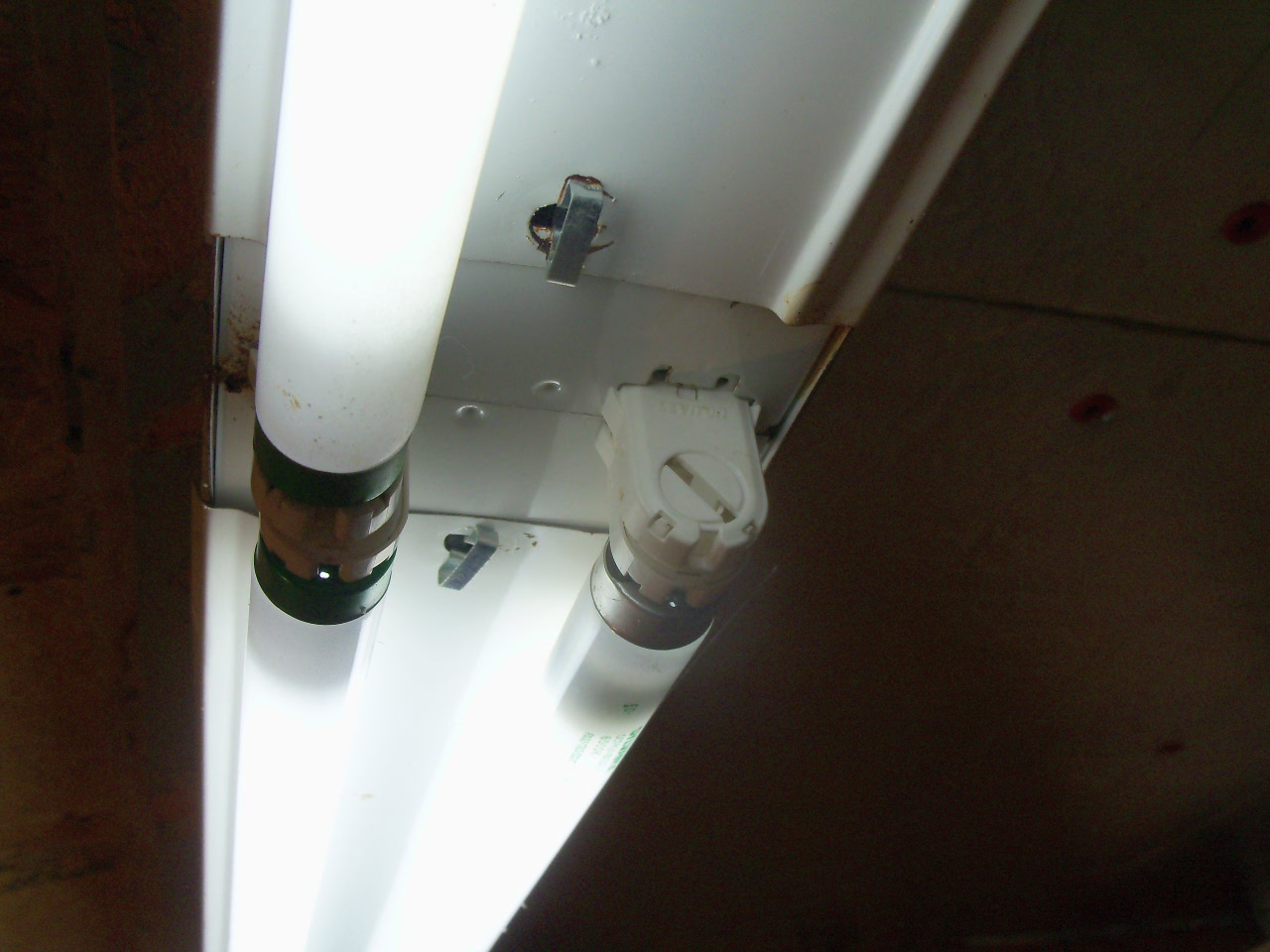

I have the new type lights in my work shop they were here when we bought the house 6 years ago. I have 2 of 4 light fixtures stop working. When I tried to buy bulbs 6 years ago they were $18 each bulb. I hope bulbs have gotten cheaper in 6 years. Bulb in picture was so hot on 1 end it burned paint off the metal and what ever use to hold pin straight burned away too. When bulbs are remove the center of the sockets never returns to the correct location I have to manually rotated center to line up so bulb pins slide in. I'm not sure if these are the best bulbs & fixtures or not??? Bulbs say, LONG LIFE what ever that means. 1 bulb was not working when we moved here 6 years ago and now 2 bulbs not working but I never spend more than 2 or 3 hours a day in my shop 4 times a month only in 70° weather, 6 months per year, no heat it has been 12° in the shop in winter and summer thermometer says it gets 147°F in here some days. Today I need to buy, door knob, and sink water faucet so I look at light bulbs too.
