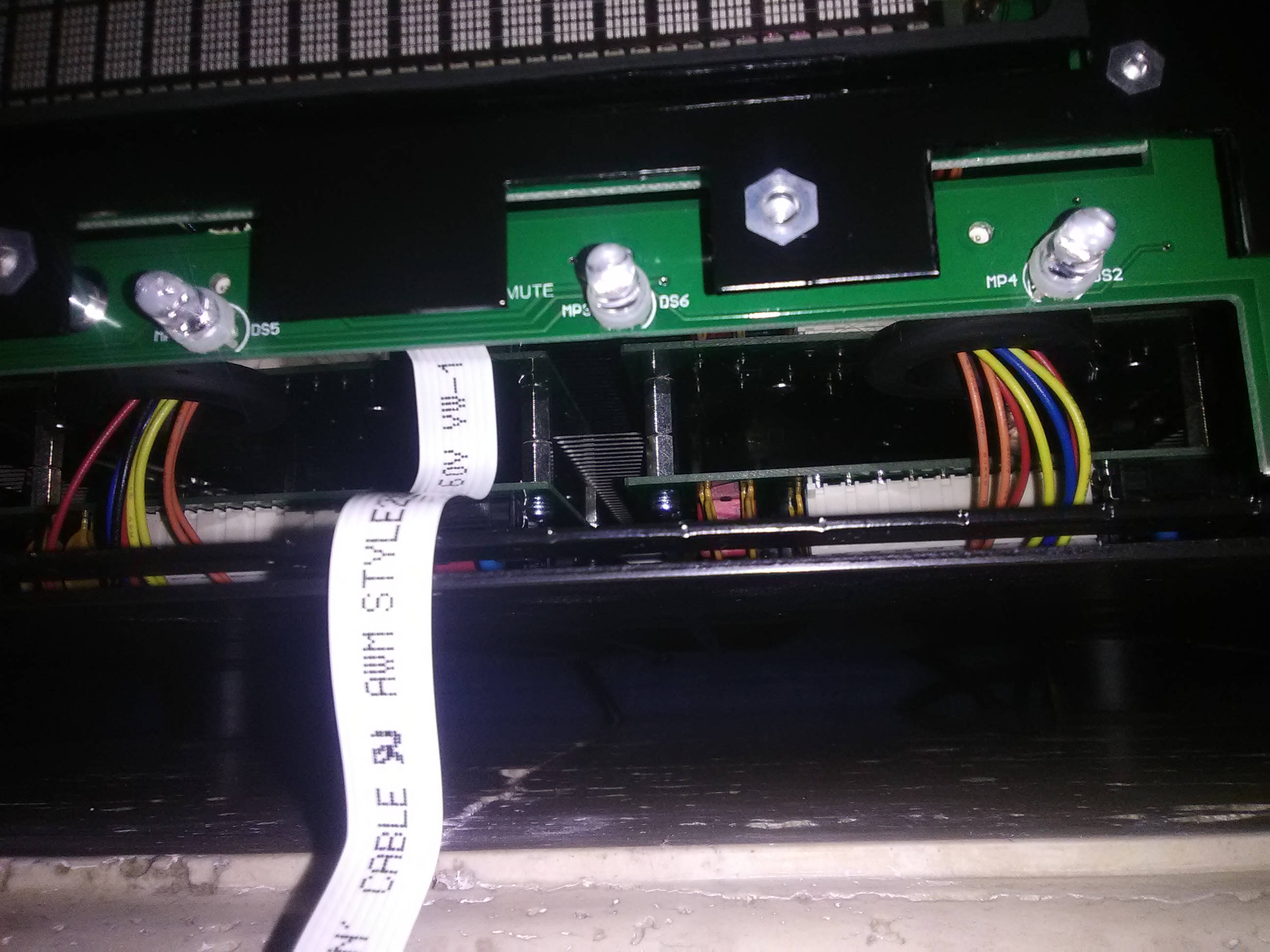

Hello, I have a very annoying occasionally flickering Mute button illumination. It will do a while and then stop for a while. I called McIntosh and they are not very helpful other than sending it to them which will cost at least $100 to mail to them and then a bunch for them to repair. I just got back another component back from repair and it cost like $400 to repair and all that happen was the internal battery went dead and the memory got erased so they had to reinstall the operating system. My question is 2 part. Can the LED be replaced on the board and what are the chances that it is just a bad LED?
Here is a pic of the board/LED

Yes, it is on when the unit is on. It is supposed be continuously illuminated to let you know that switch/button is for the mute button. If you press the mute button it has it's own light to show that the unit is muted. I asked McIntosh service if I could just send them the board and save on shipping the preamp as it weights about 45 pounds but they said no as it may not be the LED alone. I asked for the price of the board & it is $500.
If it's a white or blue LED, if you solder a red LED in parallel, the red LED has a lower forward voltage so all the current will flow in that. If the red LED flickers, the problem is the driver circuit. If not, the problem is the LED
Model? it's possible the service manual is online. Particularly on hifiengine. Not knowing anything, I'd suspect a loose connection and it could be the LED.
It is a c1100, I could not find it there. It is a fairly new model so maybe the only source is the manufacturer. I am not familiar with soldering so I can probably get a new LED bulb from McIntosh and take it somewhere to have the LED replaced locally. I could try myself if I could find some good info on-line on how to do this correctly (i.e. removing old LED and soldering new one on). Any thoughts or recommendation on this?
it looks like a double-sided plated through hole board and it might be tough without having the right equipment. It's likely the solder does not contain lead and therefore it melts at a higher temperature and the LED leads have a large thermal mass. A lot of times in the wave soldering process, large components don't solder correctly.`

LED's have polarity. Those LEDs probably have a flat near one lead. New LED's will also have a lead that is longer than the other one.
the leads could be square in a round hole.
Try pushing on the LED in various directions when it flickers and see if it stops. That a novice can likely fix.

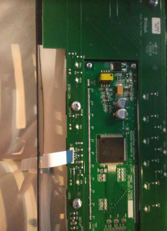

Here is a pic of the back of the board. McIntosh
told me I can get a copy of the service manual from parts so I sent them an email. It also seems that once the unit gets up to full operating temperature is seems to flicker a lots less and at times will stop completely.
Also, as u can see this pic is actually 2 boards, one with the LED and control knobs and another with the LED screen readout and microprocessor.

The top LED pin looks bad. There "LOOKS" like a separation between the lead and the solder. Freeze spray is used as a diagnostic tool. See https://www.chemtronics.com/ultimate-guide-to-diagnostic-freeze-spray
In two basic ways:
1) The spay can cause an intermittant to become solid. Like you said, it warms up and mute doesn't work. If freezing the joint causes the light to work, then there is a good chance you found it.
2) watching the spray evaporate exposes cracks. They take longer to dissipate.
