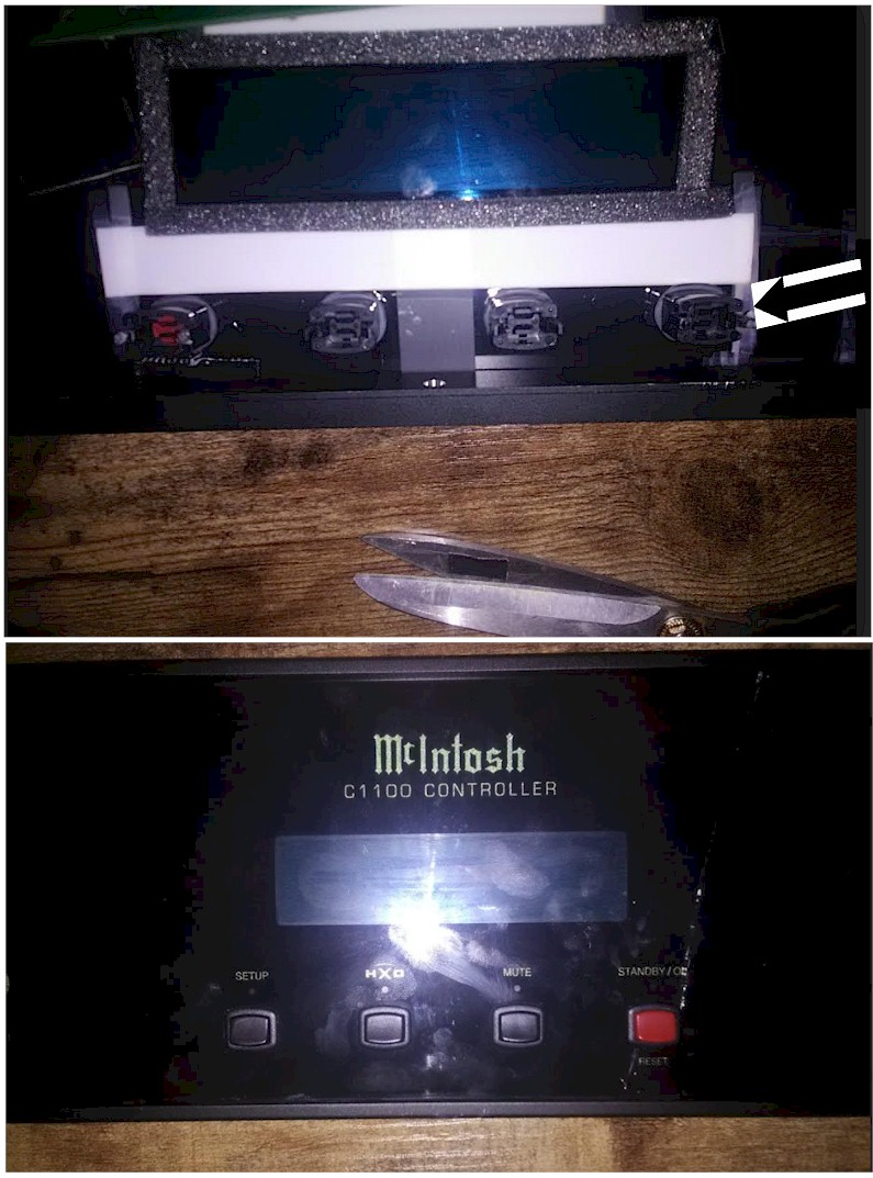

Flickering mute illumination LED on 4 yr old McIntosh Preamp
A loose connection/bad solder joint seem the most likely. The one joint looks suspicious even though the picture isn't great. It's hard to take a macro picture even with a MACRO lens and good lighting.
EDIT: This https://www.jst.co.uk/productSeries.php?pid=121&cat=22 could be the connector. Looks like the cable inserts easy and is hard to get out. A shim might help. e.g. https://www.mcmaster.com/shim-stock/shim-stock-6/

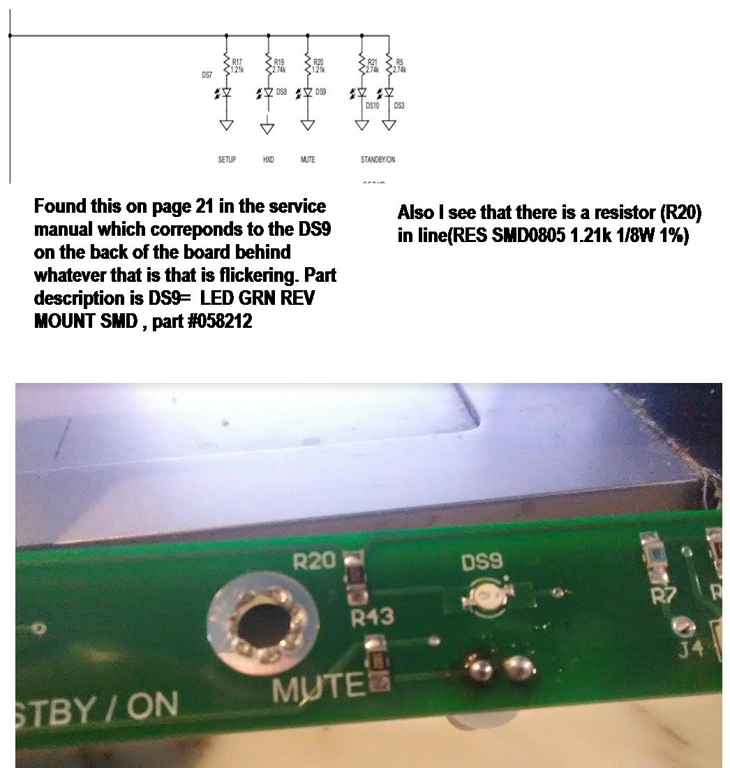

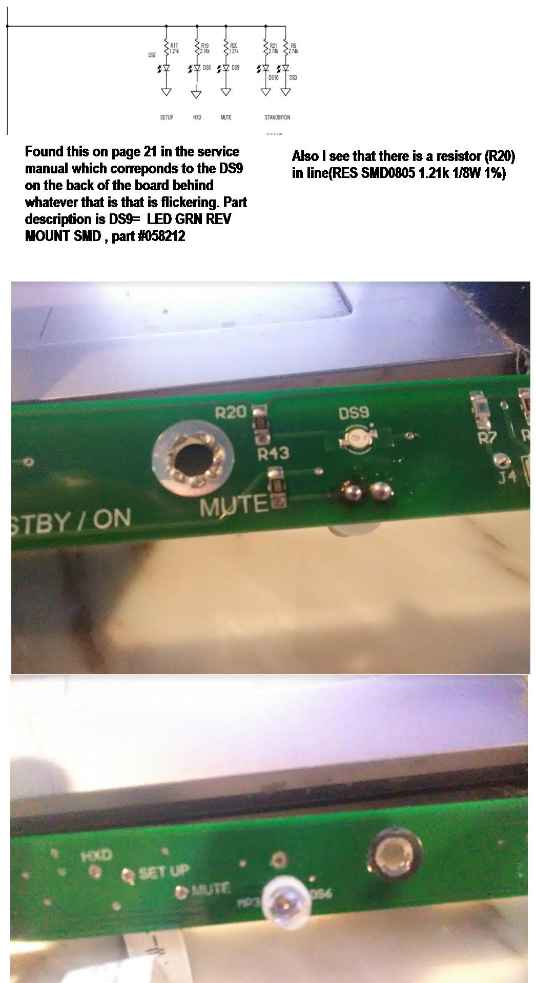

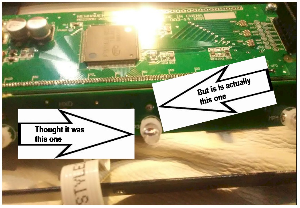

OK It looks like I have been chasing the wrong culprit. The LED bulb that sticks out only illuminates when the Mute button is pressed. The culprit that is actually causing the issue is something recessed in the board. See pic. Is that an LED inside the board??

The LEDs tied to a resistor likely go to power unless there is a dimming circuit.
It appears that you illuminate the button or around the button and then illuminate the function. i.e. When mute is activated, that LED is on. When power is on, The mute button probably has an aura around it all the time.
"REV MNT" suggests the solder pads are on the other side of the board. Without real part numbers, it's hard to tell.
The pic shows both sides of the board for the mute button light (which is the bulb that sticks out of the board) and the mute button illumination light which is the one that looks like it is a part of the board (this is the one that flickers) & is referred to as DS9 in the service manual and also on the board. Considering the circuit for DS9 in the service manual what chance do you think that this is an issue with the board as I cannot see a way to replace that LED as it is recessed into the board? Let me know what you think also are those LED replaceable when they are recessed in the board like this one?

There looks like a gap in R43 at the bottom in the pic in post #33. Too much heat while not holding R43 down and it will float away. I don't think it's the LED joint.
I wonder if I should just get a new board made by McIntosh but how can I be sure that this will solve the issue. It looks to me like all the LED's for illumination are on the same circuit so if there was an issue with something outside the board or the actual LED itself all LED's for illumnation would share the same issue. What are your thoughts on that?
If it is just one LED flickering and there are four others, each with their own resistor, but all powered by the same supply, it's really got to be that one LED or its resistor, or the connections between those.
