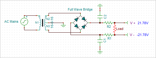

This is my interpretation of the circuit we're investigating (It is only a very basic circuit example, not the actual circuit):
The "bad" DAC appears to have a fault in the V+ side. Don't know why at this time.

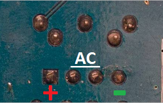

Sounds unlikely, but it does appear that the bridge (1/2 of it, anyway) circuit has failed. We'll start with the output of the bridge:
Check the voltages from ground to the points below:
Both under "AC" should be ≈16VAC, + ≈ +22VDC and - ≈ -22VDC.
On the plus pin I get 23.5VDC and on the minus -23VDC.

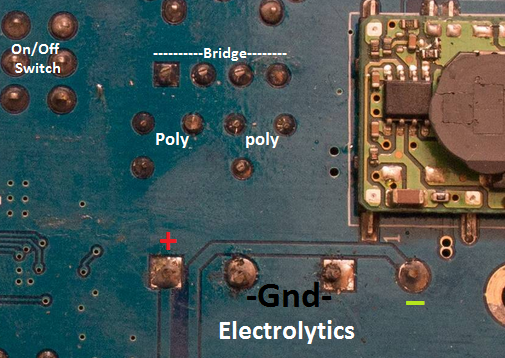

I'd start with the two electrolytics (silver top with the embossed cross, note polarization - gray stripe should be minus\Gnd) and the two polyesters (C33 & C34, red rectangles - NOT polarized).

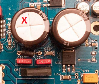

At the moment, I very curious about the cap above with the red X (the smoothing cap for the +22VDC side of the PS.
Don't forget that the negative VDC side of the PS seems to be working just fine.

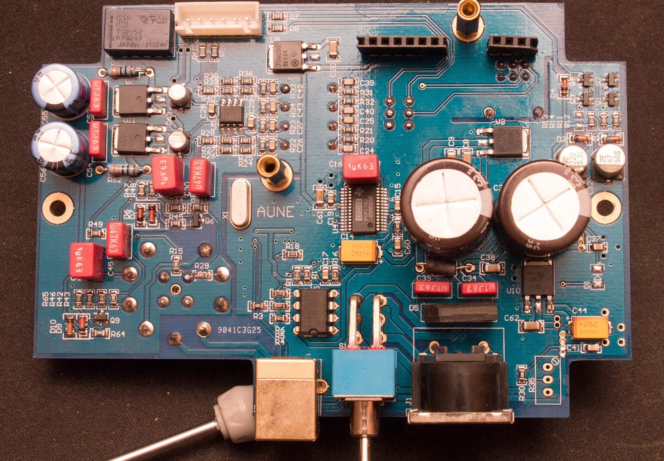

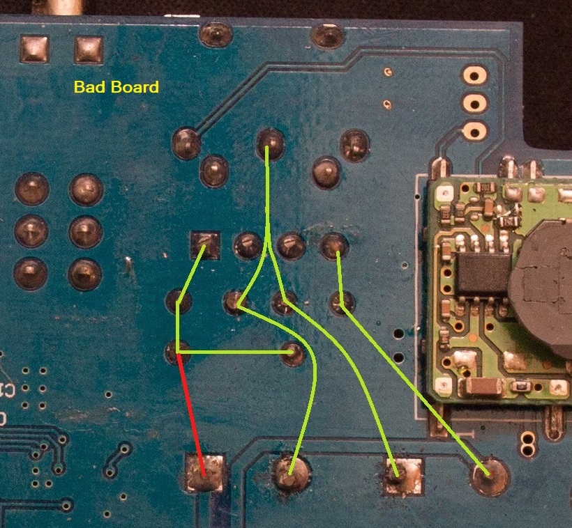

After one and a half years I’m back. I had some house related problems to deal with after which I haven’t had time and now I have time.
Long story short, I know very little about electronics, I have two boards of the same type mentioned throughout the thread, one fully functional and the other defective and I’ve just tested and probably, I think, determined cowboybob was correct in saying it’s a problem in the VDC PS so despite the time gap most, if not all, needed info is probably in this post. If anyone still wishes to help me that would be awesome. The tests/measuring results are below.
On the good board
Taking polarity into account I get about 21.5V on all the caps(the two big caps, C33, C34 and C38) as soon as the board has power.
On the bad board
I get about 22.5V on the big –cap and the C34 cap.
On the big +cap the electrical polarity is reversed (compared to what it should be acording the markings, the other cap and both caps on the good board) and it only slowly rises after power up, after 30s it’s still at -0.3V.
On the C33 cap I get 23V, however, unlike the other caps, the voltage drops gradually and very slowly after power off, whilst on the good board it’s at 1.2V two seconds after power off.
C38 does the same thing as C33.
The cylindrical part between the two poly caps and the big electrolytic cap is marked L3 so I assume it’s an inductor, I have no idead what it’s doing there and beyond measuring it's resistance, which is about 0.3ohms on both boards, I how or even if I should test it.
I also got a very cheap ESR meter. I’ve used it for some tests with the capacitors still on the board. For whatever reason I got 1.3ohm resistance on the leads but I got at least one ESR value for all the caps with the same value as the lead’s resistance but it did vary a lot between tests so I won’t mention it but I will mention the capacitance and vloss because even if they’re off by a lot they were fairly/somewhat constant between tests for the same part.
The big caps are 3300 microfarads, 25V, the poly caps rating is obviously not the one below but there are clear differences between the boards, maybe this will paint a clear picture for someone else because I thought the +electrolytic cap was bad but after I saw these results I have no idea.

This is the principal of that style of dual-polarity PSU:
https://qph.fs.quoracdn.net/main-qimg-225584e3f63ba8b4033f354824101c08

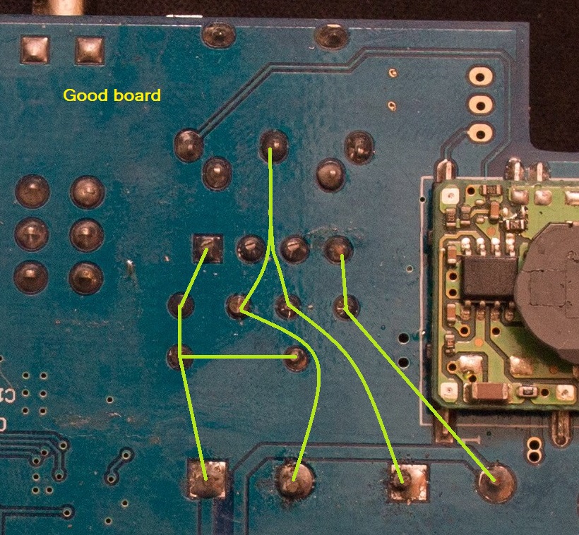

Check continuity from the bridge + & - outputs to one terminal each of the main caps. The other terminal of each should be the 0V or ground and the centre tap of the AC input.
If continuity is OK, replace the rectifier.

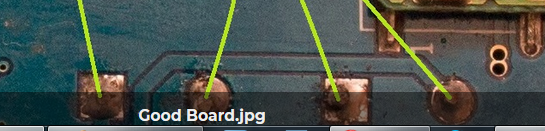

Continuity is not ok. I'll add two pictures with continuity in the area on both boards, green is continuity, red is no continuity. The small C38 cap on the other side has continuity with the poly cap on the plus side of the circuit on both boards but I could not show it because it's on the other side.
Could it be a bad trace or is it something else?

Did you find your solder plunger? Removing a 4 pin device ( the bridge) can be a bear and takes a lot of patience, especially if you don't have a soldering device that will span all four connections at once.. A "rocking horse" action (along the long axis of the bridge) is sometimes needed. And be very aware of surrounding components to avoid ancillary damage.
<EDIT> Just saw your new post (added while I was hen pecking my response...). Now I am flummoxed... :arghh:
Using a known, good circuit ground (from elsewhere on the PCB), what are the voltages present, on the good board, for the four connections in the below picture?
Then, if you would, please post the voltages for the same points on the "bad" board.
