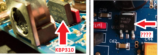

This is the best I can do right now. The big caps are 3300uF 25V and the small caps 330uF 35V. The KIS-3R33S is missing the top cover on both my dacs, I saw many online pictures with the cover missing as well but I attached one with the cover so you can see what part it is(they are all the same version of the dac).
After I desolder the Vin should I test anything else or just the plate voltage with no tube mounted?
https://i.imgur.com/Vjtet71.jpg
https://i.imgur.com/SlPHPub.jpg
https://i.imgur.com/NTO9spd.jpg
Just the plate voltage with no tube mounted, for the time being.
BTW, good pictures. Note below:
As I suspected, the KBP310 is a full wave bridge rectifier, apparently being fed by the AC voltages coming from the 6 pin connector. This lends credence to that area being the source of the ± ≈22VDC voltages. I cannot, however, ID the chip noted "???". Try googling the identifying characters and see if you can find a datasheet for it (I suspect it might be a voltage regulator, but ...).
