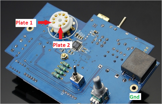

Hello,
I am new to fixing electronics by working on the PCB and I have very little soldering experience but I will probably manage with most of the bigger connections on the board I’m trying to fix.
The problem is the DAC board which uses a 6922 tube. When the T1 is powered on all it does is produce an audible buzzing sound, the tube never warms up. I know that the tube, the amp board and the power supply work because I have another T1 on which I've tested them.
On a visual inspection the board with the problem looks, as far as I can tell, just fine with no evident burns, blown up components or bulging capacitors.
Unfortunately I don’t have any schematics but I do have some stock pictures of the board which are probably more detailed then what I could get right now with mine.

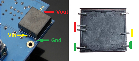

I'd start with checking the Vin of the KIS-3R33S PS (be very careful with your VM probe tips!!:
First, with NO POWER to the DAC, check for continuity between the large, tinned hole and the Gnd pin of the IC - if connected use the tinned hole for your ground. Otherwise, use the Gnd pin of the IC for your ground.
Now, apply power to the DAC.
Check Gnd to Vin. Should read between 4.75 - 23VDC (I'm going to guess around 10-15VDC).
If OK, then check Gnd to Vout. Should read between 0.925 - 20VDC.
Then let us know what you find.
If by the large tinned hole you mean the hole that looks gold colored then yes, there is continuity, but I only have a cheap multimeter so I used the 200 ohm function to test this and I got a value of 0.06 or 0.01 for a very short time then it went back to 0.06.
The Gnd to Vin is about 15.8VDC and the GND to Vout is about 1.59VDC.

With the tube the voltages are the same, Vin is 15.8VDC and Vout 1.59VDC. The buzzing seems to be coming from the KIS-3R33S, I couldn't say 100% but at worst it could be something right next to it. The tube never glows, there light does not come on and neither does the click.
Without the tube the light and the click sound come on in about 30s and so does the similar but much louder continuous shorting sound, the Vin starts at a bit above 18.1VDC and it slowly drops to about 17.8-17.9VDC after witch it drops fast till it gets to about 16.7VDC and then it slightly moves around that value, the Vout is 6.22VDC at first and the goes to 6.1VDC after the light turns on. The noise is so loud it's even harder to tell where it's coming from but it seems to be in the same area.

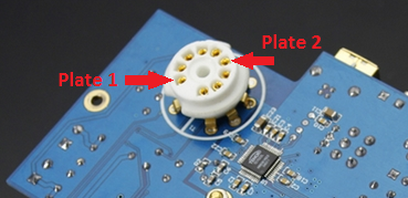

With the board powered up and the tube removed, carefully check and post the voltages on the tube sockets "Plate 1" and "Plate 2". I don't expect dangerous voltages to be present, but exercise caution just the same!
When done, perform all the exact same tests on the working DAC board.
Again, be very careful.
<EDIT> Plate 2 is mis-identified! Plate 2 is connected to Pin 6, NOT pin 9. Note correction in pic of Post #12!! Thanks to Les for eagle eye...!

I see in the first picture you also showed me the Gnd but I didn't get if you wanted me to check the voltages between the Gnd and each pin(1 and 6) or between pin 1 and 6 directly so I did all of them:). I did the tests without the tube and all of the results were 0.00VDC both at power on and when the light turned on. I also checked for continuity afterwards and there seems to be continuity between Gnd and Pin6 but not between Gnd and Pin1 or between the 2 pins directly.
Is there any conclusion to be drawn for this or the different Vout voltages?

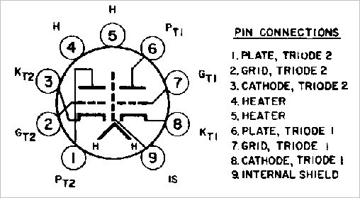

bittgata, I have committed a very rookie mistake, and I apologize.
This is the 6922 pinout, looking at the base (bottom) of the tube:
In transposing the pinout to the socket, I inverted the pin locations in my previous posts. Below is the correct pin numbers, looking at the socket from above:
So, please check, one more time, for the voltages present on ALL pins with the power on, of both the working and non-working DACs (tube removed). Use the same ground point as before.
The tube is, really, a secondary issue to your problem. From what you've provided to us, thus far, I'm, pretty confident that the KIS-3R33S power supply has failed.
But I am intrigued by the 6922's wiring. For instance:
Note how pins 1 & 6 (the plates) are tied together. Very difficult to use that configuration for stereo.
And pins 2 & 3 (grid & cathode of triode2) appear to be tied together. That would make that triode2 non-functional.
They do seem to have the filaments (pins 4 & 5), apparently, being powered from the USB port. That would explain the filaments lighting up.
