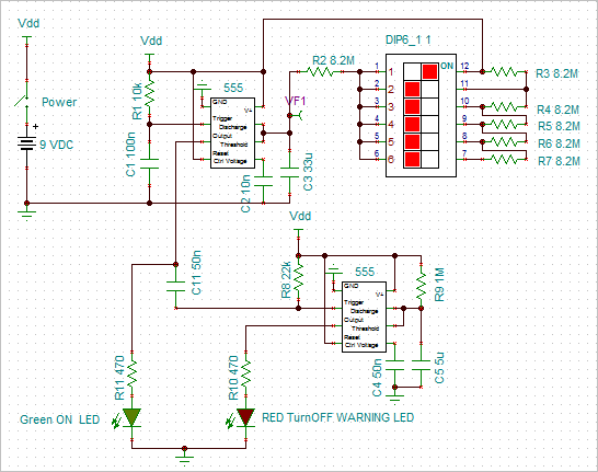

Here's a dual 555 timers rig that meets some of your design criteria:
Minimum time is 5 minutes with 5 minute increments selectable up to a max of 30 minutes. The DIP switch in the schematic is serving as your 6 position rotary (which my SIM lacks). As with ANY 555 timer, "spot on timing" is not possible (RC timer arrangements are notorious for variability) but, given the task, accurate enough. As a reminder, for this circuit, timing is derived from the formula: 1.1(R)(C)=seconds.
Note that I've only included 2 LEDs for timer condition, i.e., a GREEN ON for the selected watering time duration. at the end of which it turns off and immediately followed by a RED LED turning on for 5 minutes (approx) to let you (or your Mom) know it's time to turn the water off.
Your desire to have a digital timer readout component vastly complicates the issue. There's no real way to incorporate that feature without going digital in one form or another.
You might, however, consider adding to the RED LED circuit a small piezo buzzer.
The 555 should be able to supply power for both the LED and the buzzer I noted above without the need of a driver transistor (it could be easily added, however, if need be).
The whole point of this arrangement is to give you a circuit that will be relatively accurate, use components you have on hand and will count down for a selectable time period that, when reached, will display an alarm indicating the need to turn off the water.
Err, cowboybob? You missed the part about his mum really liking the 7 seg displays...
(Edit) Well I say "his". You never know with these people from the gas giants...
Didn't miss it throb, just ignored it under the circumstances. I know how Moms can be. I figured a little change in the "readout" (and adding a buzzer) might satisfy her "whiz-bang" need. Otherwise the project gets overly complex. In my book, anyway.
Could be wrong, of course. I can't tell, for sure, how much time/effort CKD wants to put into this rig. Not that I haven't over-engineered my share of projects... :banghead:.
