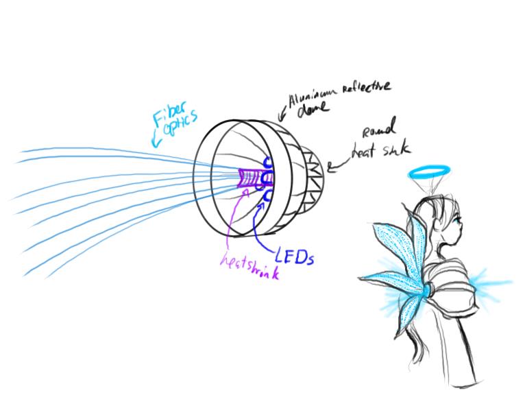

So I'm continuing a project I did last year where I created this costume for a convention. There is a 3D view on the page. We are going again so I am creating the shoulder pieces to go with it. There are ghostly wings that emanate from back LED and I was considering creating a wire fairy like wings with fiber optic fabric to attach to the back. However I don't know how I would go about constructing this since the back piece has its' own LED and how would I get light into the fabric from there. I'm not sure if I ought to like... have the Circular light board emanating out and use another smaller LED to shrink into the fabric?

So thinking about my design, I just wanted to throw up a sketch of a possible design and what I'm looking for....
Sorry for the shaky lines... my cintiq doesn't seem to like windows 8 lol..

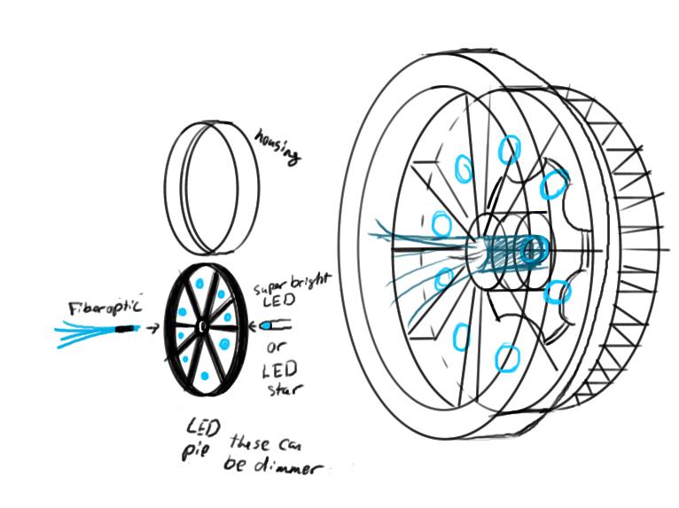

I like your idea of having multiple LEDs on a circuit board. I doubt I need 37 lol... I mean... how large of a heat sink are we talking? I hope that a little reflective dome would help enhance the light as well. As you see, the the shoulders are an encasing so tis why I worry about heat management... I guess a air gap under the device would help with air cooling. The LED that the fabric is going through probably has to be the brightest bulb just to light all of those fiber strands, but the surrounding ones can be dimmer. I also wanted to embed a small computer that had a fade animation.
I'm considering thick shoulder pads for the spaulders to rest on for comfort and a buffer from the heat...
With a good fiber cable there is vary little if not any light escape from the sides of the tubes, otherwise they would not work.
Raey, you do not understand that the bundle of optic fibers is small and a small LED shines its light in a very narrow angle into the end of the bundle. Then your multiple LEDs and reflective dome cannot be used. The Sparkfun demo video used an ordinary low power narrow angle (superbright) LED and the optical fibers in a darkened room appeared very dim.
I have never seen a high power LED with a narrow angle but some kind of focussing will do it.
Well, I certainly need to talk to a friend about this. I spent some time studying electronics, and looking for even more resources.
Getting a focus for the LED was certainly a goal. Are all high power LEDs flat and square on the star and have a 120 degree beam? Cause I might just use the Ultra bright LED since it is a 5000 mcd and seems easier to get a heat shrink around. I may end up using the Neo pixal ring from Adafruit for the surrounding LEDs. I updated the design too...
