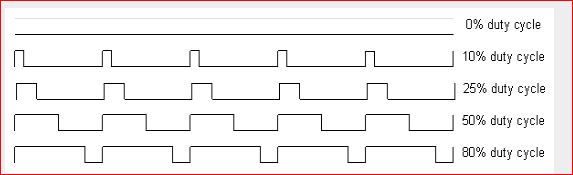

what actual signal is required into PWM so that Silver can get to know how to get the fan running. Is it a TTL level 1 or 0, or 0V or 12V for example, assuming a constant level will do that is?
In this case, and not knowing for sure exactly what DC level of PWM the Nidec can tolerate, He ought to be able to very briefly hit the green wire with 12VDC to test the fan. It should, very quickly, run up to max RPM.
This signal isn't the high current driving force of the motor. Rather it's the "enabling" pulse (usually driving a transistor switch of some variety) that allows the full 12VDC (from the Black and Red wires) to be applied to the motor's stator coils.
Silver, here is an example of what a PWM signal looks like:
Note the shape (a square edged positive going signal) that has a sharp rise from 0 - max VDC followed by a similarly rapid decline for varying lengths of time. This energizes the motor's coils for increasingly longer periods of time (0% duty cycle through 80% duty cycle) which result in increasingly higher RPMs.
This is not unlike the signal used to drive a servo.
