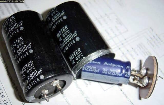

It seems to me the cost of making a fake capacitor like this will cost the same or more as making a real capacitor. I have seen winding machines that make capacitors it would only take and extra 2 seconds to make a 6800uf vs 2200uf. It will take much longer to put a 2200uf inside a 6800uf case plus the cost of extra parts and extra labor how can the manufacture not be loosing money.

I've seen this picture posted many times but never heard of anyone actually seeing one.
actually, i've seen at least 3 or 4 of these. i don't know what distributor they had been bought from, but there were 3 or 4 of these in a part bin at a place i worked at. if you picked them up the right way you feel a slight vibration. if you hit them on the side with a screwdriver handle, you can hear the capacitor inside vibrating. i got curious and opened one up, and what i found was very similar to that picture. you have to keep in mind, a few cents worth of difference between the two caps might not seem like much. it's when they sell lots of a million or more caps to distributors or equipment manufacturers that the slight price difference makes sense.

More likely a used/scavenged rubycon installed in that contraption thingy and being sold as a new 6800uf.
Or possibly a staged pic...for whatever reason - maybe a relatively-modern amp project, designed to look old-skool?
Can't seem to find much info on that image, other than 'untitled.jpg'.

As far as I'm aware it was a VERY common scam, with Chinese crooks selling such capacitors for high priced audio construction and upgrades.

i think that originally came from badcaps.com, or from the diyaudio forum.

Not really, if you're building adecent audio amp, then you need good quality (not stupidly priced) main electrolytics, and these are pretty expensive items - considering the Chinese crooks will relabel tiny IC's and transistors that only cost a few pence they will certainly make fake electrolytics that cost hundreds of times more. The same applies to power transistors used in audio amps, with vast numbers of pirate fakes coming from the Chinese crooks.
