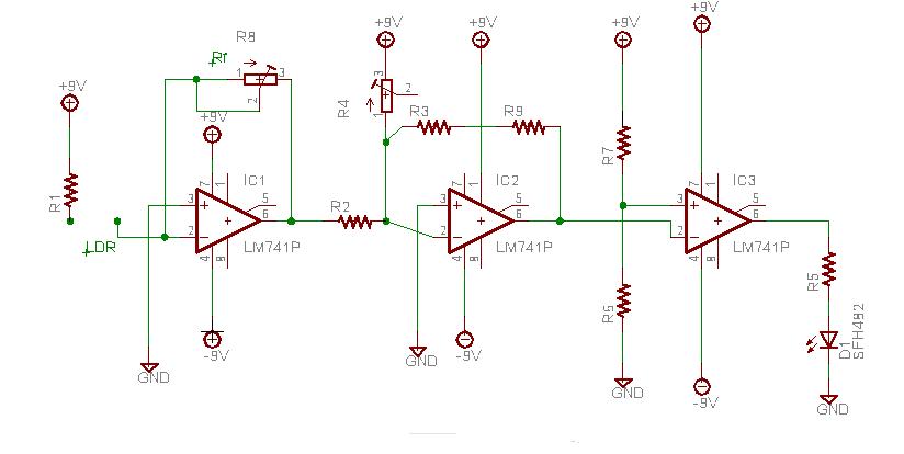

This is the schematic of my project (figure7)....but I don't know how to add display (ICL7107) using eagle, and how to power display .. how to connect the output voltage of stage2(second opamp) to the display? :shock:
anyway , take a look at this attachment!
best regards!
I don't know about Eagle.
You already posted a power supply for the LED digital voltmeter. This voltmeter's current is so high that little 9V batteries won't last very long. The 9V battery in my LCD multimeter lasts for years.
The linear output of your project connects to a voltage divider which feeds the input of the voltmeter so it that it scales from 0V to 200mV.
You mean that i have to add voltage divider to the linear output of my project, how can i do that , what are the resistor values to suit that purpose?!
If you can't figure out how to make a simple voltage divider then you could use trial and error until it works.

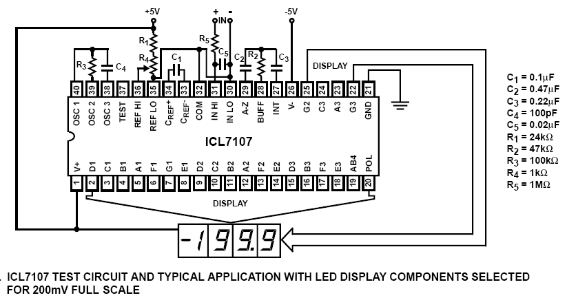

I've asked about IC7107CPL in electronic markets but they told me that it's available as ADC converter only.and i have to add display and other components that i need by myself .I shocked to hear that cause I thought that this IC contains ADC and display and many features also...
anyway i don't know what to say more but i really need your suggestions my friends :)
thanks in advance!
Didn't you look at its datasheet? **broken link removed**
Of course the ICL7107 is just a controller IC for making a digital panel meter with a separate LED display. Also, it needs a dual supply.
If you want an assembled meter, then buy one. LED meters are rare nowadays, most use an LCD display for low current from a 9V battery. Maybe you can steal one from an old multimeter.
Just a question about ICL7107 , Do I have to add the capacitors and resistors (as in the image above) externally to the IC ...I want to add LCD display as an output of ICL7107 instead of seven segment LEDS in order not to consume high current so that 9v battery won't last very long..
any suggestion will be appreciated !
thanks in advance!
You can't just replace LED's with LCD, they are completely different things, and driven in totally different ways. IC's were available to drive LCD displays, but would probably be difficult to find these days? - far easier to buy an LCD meter module (as Audioguru suggested) these are freely available at moderate cost, and include the LCD and driver IC joined together - they do everything you want!.

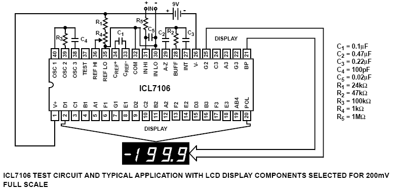

If you want to drive an LCD display, have a look at the ICL7106. That is designed to drive an LCD rather than LEDs.
4electros said:
Just a question about ICL7107 , Do I have to add the capacitors and resistors (as in the image above) externally to the IC?
Of course the parts must be used.
Don't you have the datasheet?
Don't you think you should use the right IC?
