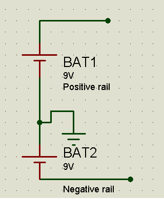

it's true... well i still haven't seen confirmation that circuit is powered correctly. are you using dual voltage and not just one and same 9V battery? did you measure 9V between positive rail and ground? how about negative 9V rail and ground?
I powered the circuit in this way:
4electros said:
That is fine. Are you still stuck?

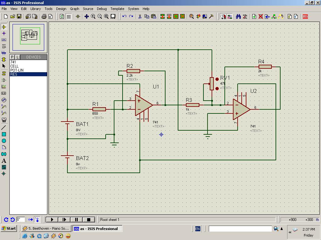

I've made my circuit as the figure shown below.
V1=3.29 v
v2=6.17 v
and other values
v1=3.11 v
v2=5.81 v
about the batteries I used , I measured its voltage with a voltmeter, one is 7.38v , the other's 8.93v
Your circuit makes no sense!.
Your first amp has an inverting gain of more than two times, and you are feeding it with a +9V input, so the output should be greater than -18V, this isn't possible, as your supplies are only +/-9V.
Likewise, your second amp has an inverting gain of about the same, so fed from the -9V odd from the first amp, it should output more than +18V, again impossible!.

Try using values that work!.
Where did you get the value of the first feedback resistor?, how about calculating it as the original website gives the formula for?.
The first amplifier should work as inverting amplifier, the website gave me the value of feedback resistor, it's variable resistor of 1k but i used 2.2k , why not?!
The important thing in the first stage is the law of inverting amplifier:
Vout=-Rf/Rin * Vin
Rin is the resistor connected to the inverting terminal.
So why did you double it?, giving twice the gain, and at the same time removed the LDR (minimum 1K) in series with Rin (giving 1K instead of a minimum of 2K, and maximum of 11K), doubling the gain again.
So your unwarranted changes give the circuit four times the gain it should have, rendering it useless!.
If you make Rin the 2k2, and Rf the 1K, it should then fall within working limits

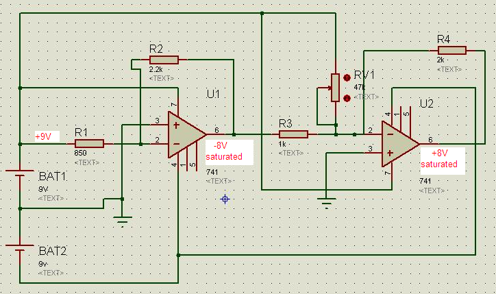

It looks like a couple of saturated inverters to me.
what does that mean? You meant that the wrong voltage values are resulted due to that..
4electros said:
1) You posted four V1 and V2 voltages but didn't say what they were measuring.
2) The voltages you posted don't say positive or negative.
3) You posted three sets of opamp output voltages. Are the batteries so weak that you can see their voltage dropping?
4) Your batteries are dead if a saturated 741 can't give its output about 1.4V less than the supply voltage. Measure the battery voltage when it is powering the circuit. I bet one battery is at about only 5V and the other is about 7V.
V1 is the output voltage of stage1(inverting amplifier that connects to LDR)
and V2 is the ourput voltage of stage 2 ( the second amplifier)
audioguru said:
V1 is negative but V2 is positive due to inverting terminals
yes, abit , but the changes is about 0.5v or 0.7v...maximum!
one is 5.75v the other is 8.52v
[/quote]
Your weakest battery is past being dead. The strongest one has a few hours of life remaining.
Why not change the resistors to be the correct values then try it with new alkaline batteries?
