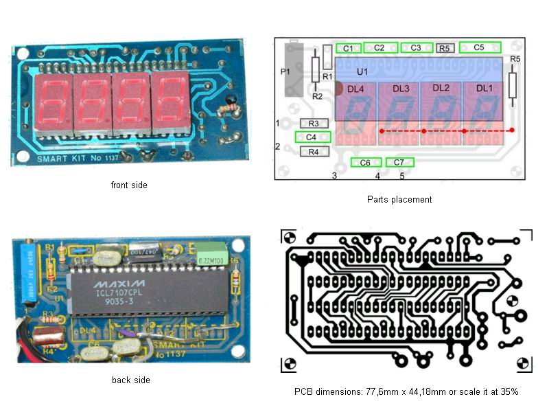

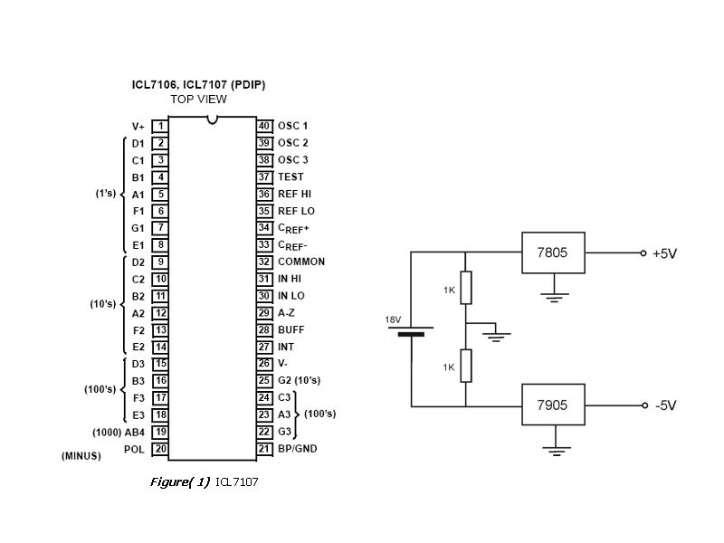

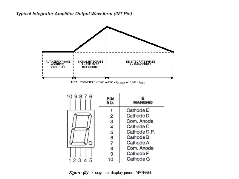

My friend, may be you didn't read the explanation of the project very well...the result must be displayed and the block"display" in the diagram assures that..and the required elements list is added also at the bottom of the page which i've posted... but the display element is not present here in syria so i need another equivalent element ...but first I need to learn in general how to display voltage value digitally by means of display(may be 7segment display)..I might add ADC converter and then seven segment display , i don't know....
I 've posted that i have some small problems in eagle software I hope that you do understand my sensitive situaiton in making this .
hope you can help me ...anyway thanks !
best regards!
Yeah, I see that the project uses an ordinary digital multimeter as a display of the amount of light that causes the output voltage of the 2nd opamp to change.
You don't have cheap and ordinary digital multimeters in Syria? Why not?
anyway see these attachments!
I got it from a friend of mine.
your comment?
Our professor at university wants me to do it with display tool not with orfinary digital multimeters cause I make this project for measurement material( analog and digital measurements) , that's it!
I'm not pleased to do it in such way , but I must :shock:
