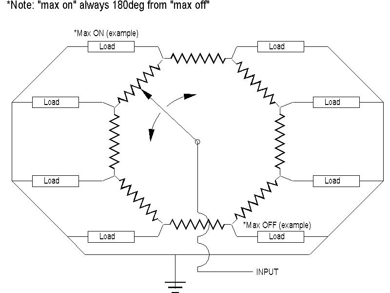

Is there a device i.e, an IC, processor, etc. that would act like a 360 deg turn pot with multiple taps (4 or 8) that would vary from highest to low/no resistance between the taps 180 degs from each other. Need to be able to vary the speed of "rotation" and the speed of "ramping up" to max "rotation" and "ramping down" to minimum rotation. this is and audio application so noise limitation is critical. I've looked at electronic sequential switching as in light "chasing circuitry but there need to be a smooth transition between the loads (as in riding on a sine wave). Please review the attached jpeg. Thanks for any help/suggestions.

Thanks for the come back and please excuse my ineptness (and spelling). I am familiar with optical encoders, and syncro/servos and the like but what I am trying to find is some sort of "chip" that will accomplish what the schematic represents. An input (audio bandwidth) with multiple (8) outputs in sequence going form max to min, with the one at the "0" degree of a circle at maximum and the output at "180" degree at minimum. Imagine 8 outputs in circle in a "stopped" mode. Position (1) is at maximum or 100% (volume of 10), position 2 is at 75%max (volume of 7 1/2), position 3 is at 50%max (volume at 5), position 4 is at 25%max (volume of 2 1/2), position 5 is at 0% max ( volume of 0), position 6 is at 25%max (volume of 2 1/2), position 7 is at 50% max (volume of 5), position 8 is at 75% max (volume of 7 1/2). the circular array would be able (electronically) to go from no rpm to a set rpm (say 500 rpm) at a linear or non linear rate and back down to a set low rpm or stop. Again forgive my inability to describe what I have dreamed up here.

Appreciate the suggestion but I need to explain futher. Imagine a potentiometer/ reostat (I think a reostat is a better example) . These devices would not have an "stops' and would turn 360 degrees freely. The resistance would go from none to high as the "wiper" goes around the resistance media (carbon, wire wound.etc.) and back to the start of continuity. Now take (8) of these pots with one continuous shaft thru all of them. Each "body" of the pot would be indexed 45 degrees clockwise or couterclockwise (either direction but same direction on all of them) in sequence one below the other.
Lets think of them as volume controls into amps. there would be 8 volume controls, 8 amps, and 8 speakers. lets number the assemblies as 1,2,3,4,5,6,7,8. in a circle (clockwise or counter clockwise, doesn't matter). No.1 would be at max volume and no. 2 at 75% of max , no.3 at 50% of max, no.4 25% of max and no. 5 would be at 0% of max or minumum volume , no. 6 at 25% of max, no. 7 at 50% of max and no. 8 at 75% max when the shaft s NOT turning. As the shaft turns each speakers volume would rise and fall from minimum to maximum SMOOTHLY sequentially 45 degrees from each other causing an effect of sound going around in a circle. Think of a light chaser with 8 LEDs in a circle going around at variable speeds (but thats just switching). I am looking from some kind of solid state device that would do this electronically as opposed to a mechanical device which are availible (and expensive).

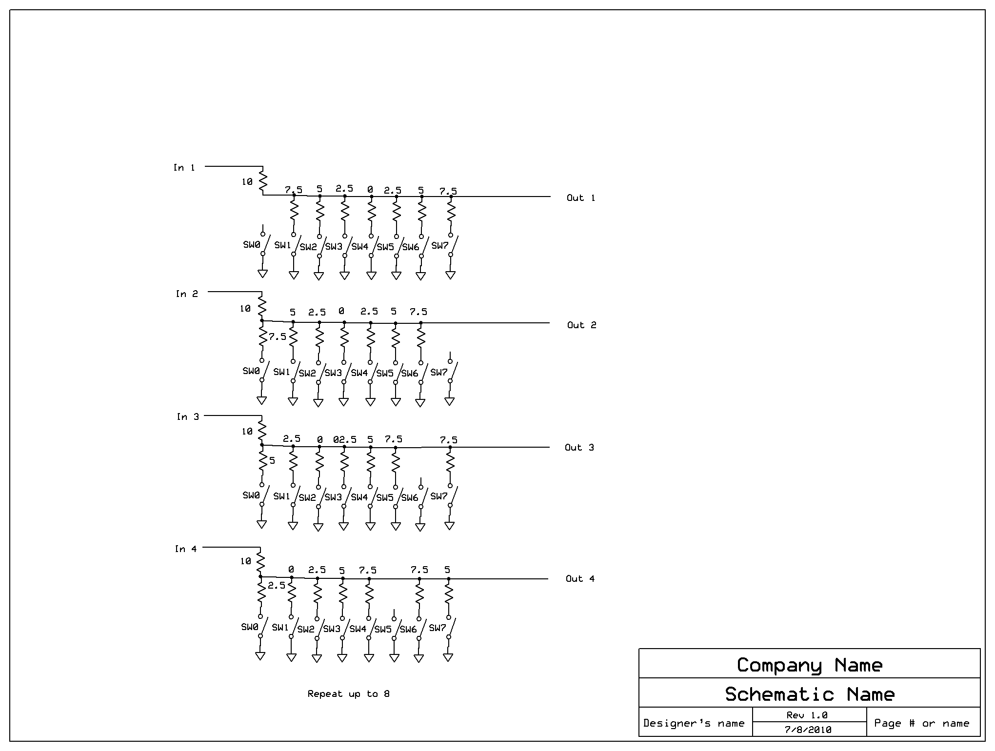

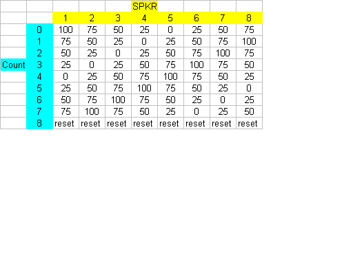

OK I think I got it. Here is the proposal:
1- Timer IC - sets the speed. (Adjustable)
2- Counter - Counts from 0 to seven then starts over.
3- Switches - These are logic switches controlled by the counter. (Counter 0 turns on all sw0's, counter 1 turns on all sw1's etc.
4- Resistor divider - Sets output from 0 to 100%
So the outputs will follow the chart.
The circuit would look like the schematic (only 4 outputs shown)
This should turn out to be less than 20 IC's and cost about $15 in parts not including a power source.
Did I get it this time?

I thought he said he wanted it to be continuously (or nearly so) variable and not stepped? Maybe you can make the steps small enough?
People can only perceive about a 3db difference so i think the one at 0 is the most important. The rest just kind of rotate. I'm guessing it is the location not the amplitude that creates the effect. But thinking about it an audio taper rather than a linear taper might be more effective.
