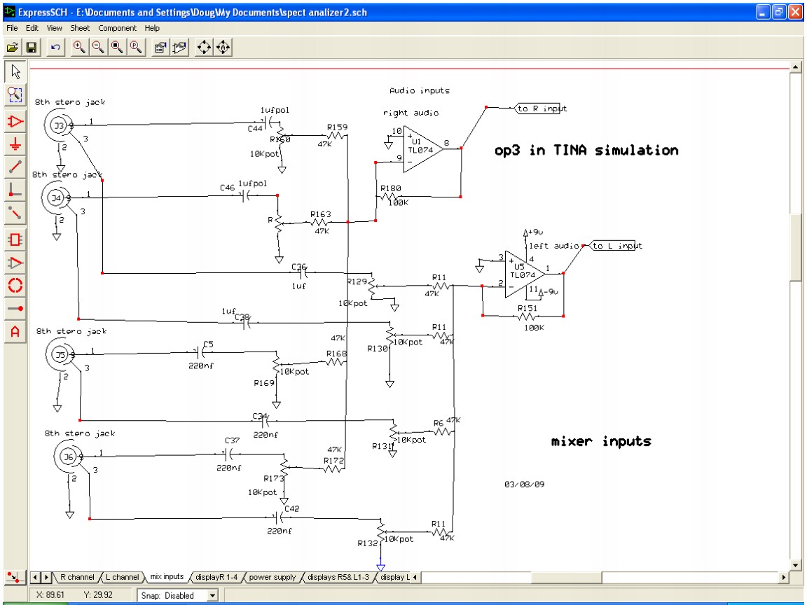

will make revisions on schematic and post later today.

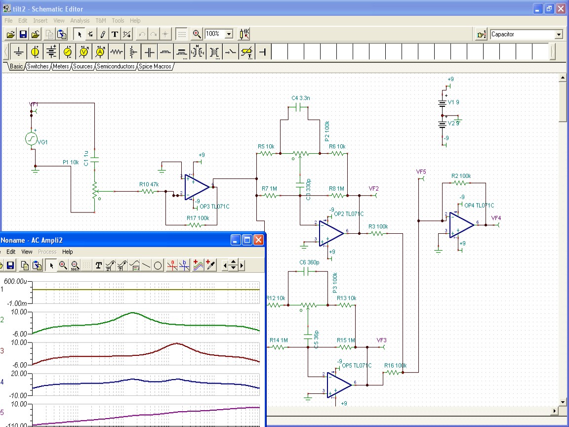

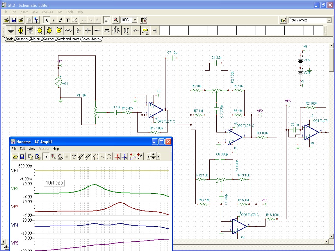

TINA looks good??
redrew simulation and it is back up to 10+Db
seperate output waves per filter
input mixer (only one showing is still under design

Tina & schematic are the same
changed the schematic to match TINA on the op amp #'s
turned off grid as well

I guess OP4 is the output mixer. Please label it as a mixer.
The input level control is only 10k ohms and the input opamp has an input impedance of only 47k ohms (is it a mixer too?). Thebn the small value of the 220nf input capacitor cause 89Hz to be reduced -3db and frequencies below 445Hz to be reduced (no deep bass). if the volume control is 100k and the resistors on the first opamp are also 100k then the cutoof frequency will be 14.5Hz when the capacitor is 220nF and will be 9.7Hz when the capacitor is 330nF. Flat down to 48Hz.

the output "mixer has 5 filter inputs (never really thought of it as a mixer??)
will make suggested changes

The mic mixer you posted has a response that is -3dB at 19.4Hz for the 1uF coupling capacitor into the 10k volume control and each 10uF coupling capacitor into the 1k input resistor. For a voice from a mic this is fine. For music then the deep bass frequencies are reduced.

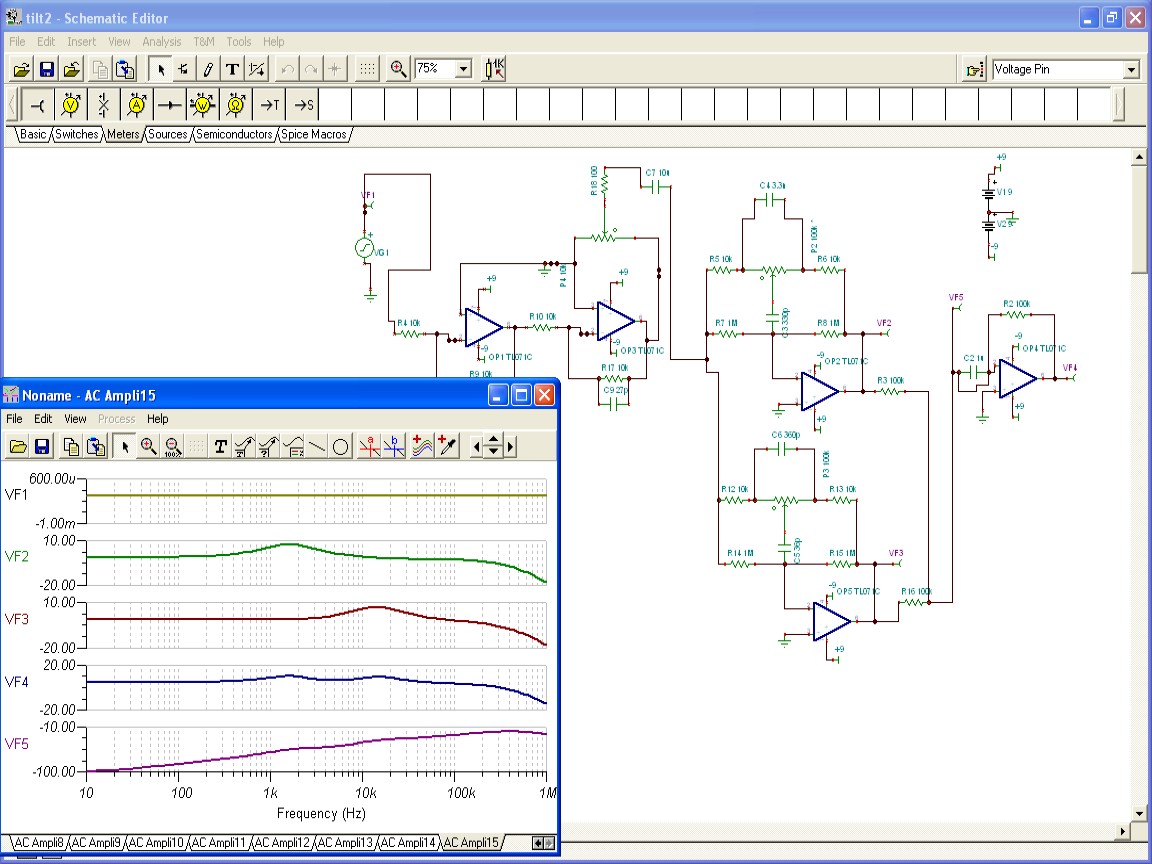

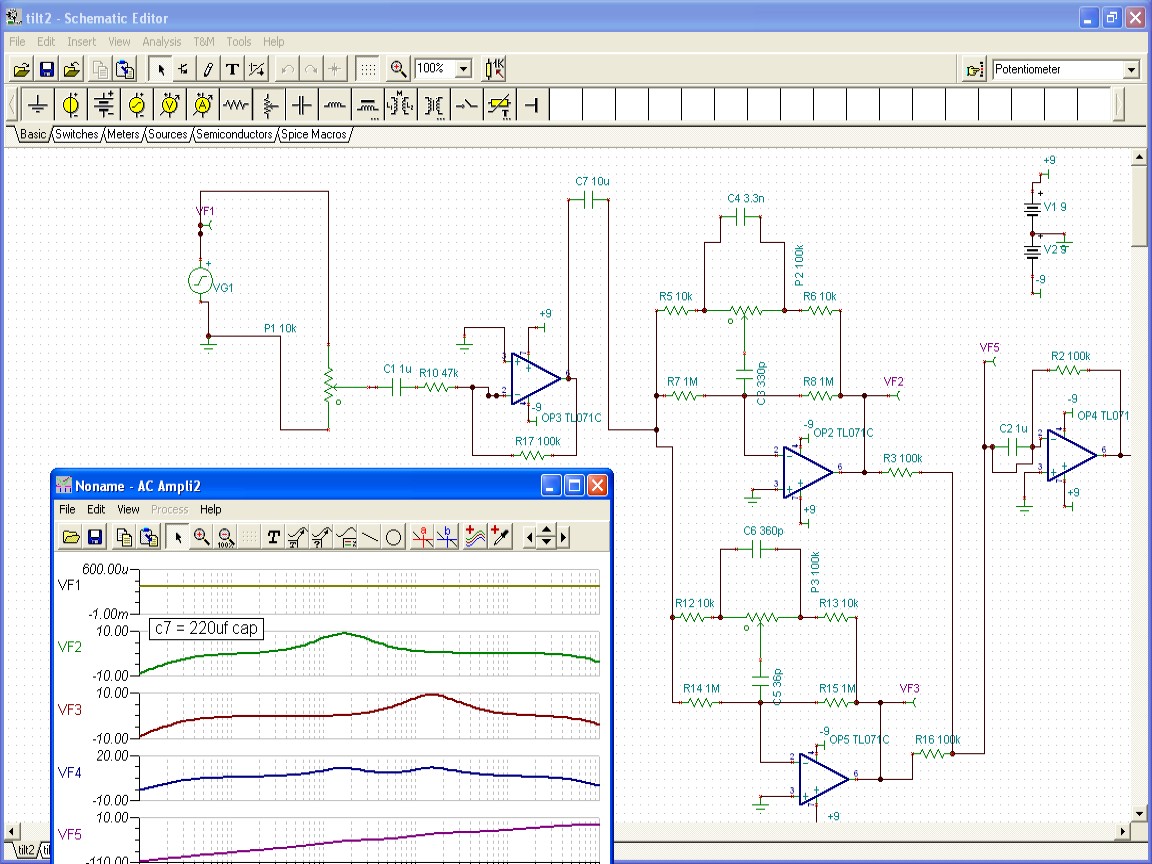

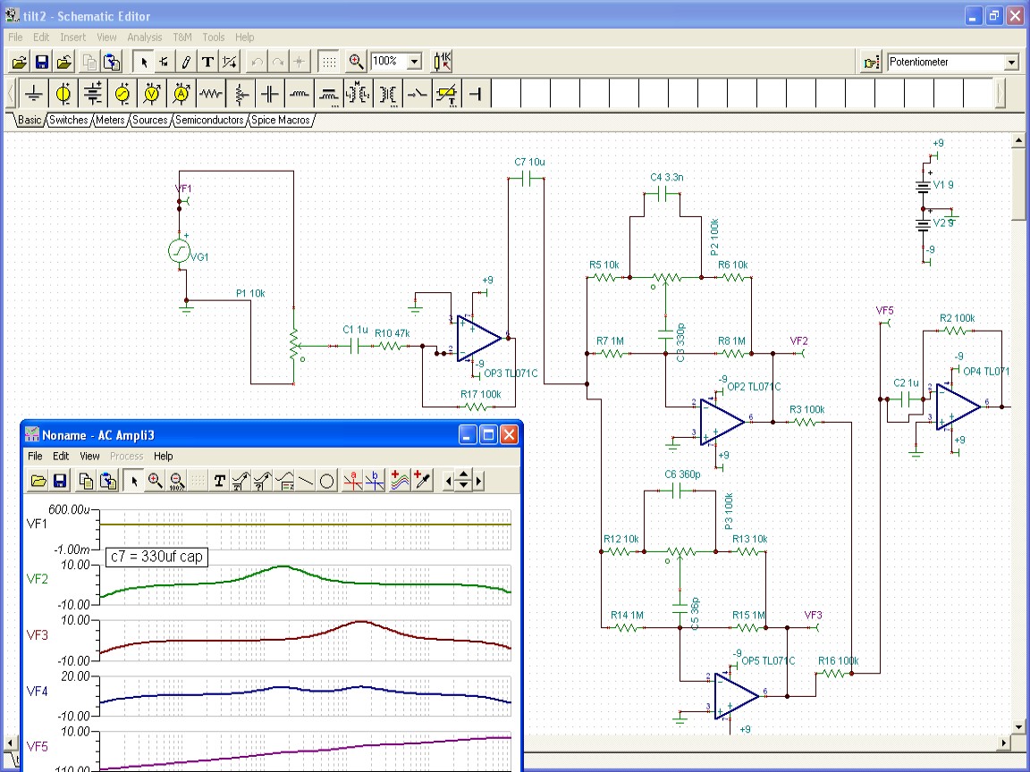

I revised simulation mixer input
arranged circuit as per link (line not mic)
then tried different caps for c7 (see attached)
not sure which is best??

You do not need C7. Direct-couple the signal from OP3 to the filters.
hot dang your good!!
I took it out and simulation is same, no change.
how does the rest of that input look??
remember there are 4 duel pots, 4 - 47 K resistors, 4-1uf caps that all connect to the op3
just like the link **broken link removed**

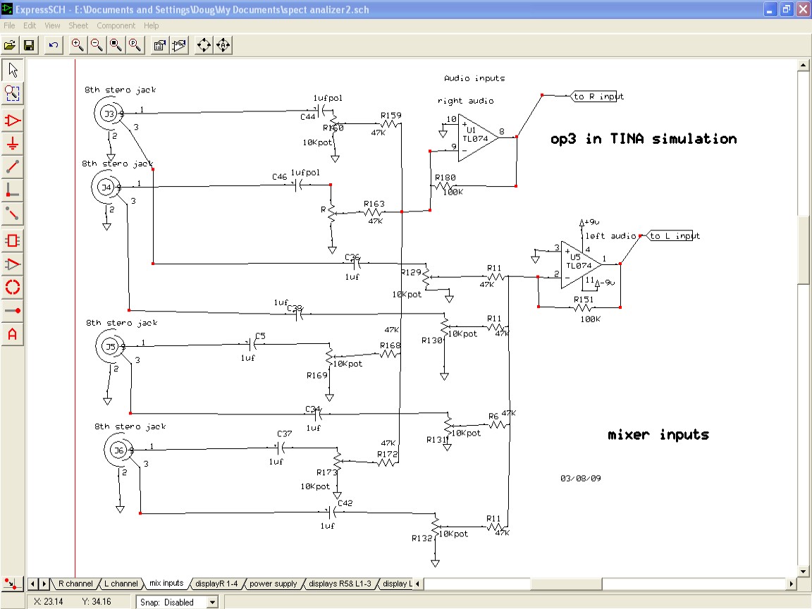

been redoing the full schematic mixer section.
not sure if I want plugs w/ tails to connect to pots/circuit(hard wire each pot (5 wires to main board per pot) or make a circuit board just for the pots and run one pigtail from pot board to main board (3 wires total (grd, L,R))
the circuit board sound easy but it would need to be double sided.
The capacitor C1 should feed each pot, not feed the inverting opamp.
You have two different schematics. One of them was correct a few hours ago except the value of the input capacitor was too low.
VERY confusing.
Moved C1 -is this what you mean?
different schematics?? hope this one is the one your refering to.
mixer schematic is done??
I made all the suggested revisions etc.
now it looks like a mixer?
note that the 2 op amps are op3 in TINA simulation (only one in simulation)

The mixer is fine except some of the input capacitor values are only 220nF instead of 1uF.
will take a second look see
boy you amaze me - you catch any error
thanks

QUESTION not that it matters but why does the curve change when a different cap goes in for c7?
seems like it changes dramatically
Your two or three schematics all have different part numbers so when I said "C7" for one schematic then you are thinking about "C7" on a different schematic.
It is extremely confusing.
The capacitor that feeds the filters is not needed so short it and remove it.
The other "C7" fed the output mixer and your latest schematic has it properly shorted and removed.
The schematic you posted this morning has both capacitors removed.
The VF5 curve changed because it is not an output. It is a virtual ground.

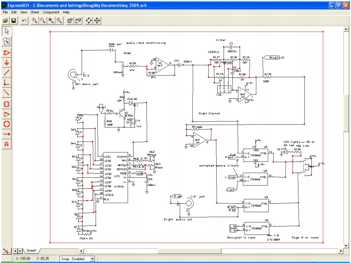

Here is the schematic that has the cap values correct?, caps removed as per suggestions

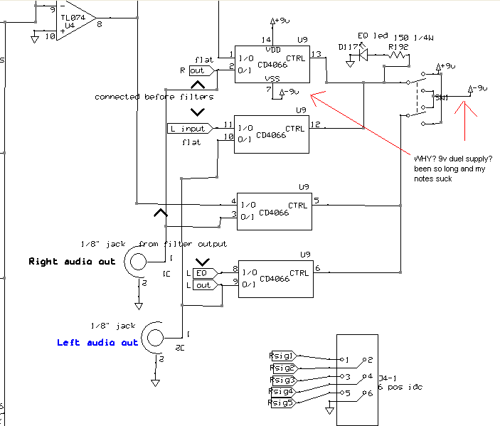

why the duel supply? for cd4066
Been so long and presently redoing the pcboard using suggestions from this link
Digital Electronics Forum • View topic - A Good PCB Design Reference
The board design is neater and easier to see the circuit instead of a jumbled mess (found a couple of mistakes) but got to the cd4066 and can't recall why use a duel supply?
Something about the input needs to be higher in order for the 4066 to work right?

Your entire project has a dual-polarity supply (it can be re-designed to use only a positive supply). Then the signal averages 0V and swings above (positive) and below (negative).
The input signal to a CD4066 must never be more negative than its supply so since the input signal goes negative then the CD4066 needs a negative supply in addition to its positive supply.
In this app using a TL074, a duel supply is better? or am I in need of different op amps for single supply?
Advantages of duel over single supply?
I'm under impression a duel supply has less noise?
The power supply for an audio circuit does not cause noise. Single or dual polarity supplies create the same low noise levels.
A single supply circuit has many coupling capacitors to charge so it might cause a POP when the power is turned on or turned off.
A dual polarity supply has coupling capacitors that do not need to charge so there is no POP.
Any opamp can operate from a single supply when it is biased at half the supply voltage.
