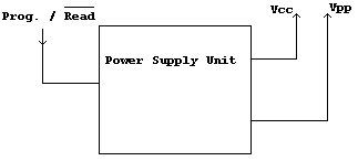

The EPROM programmer that I am designing has got two modes. viz Read / Programme.
The read mode has the following requirements:
Vcc=5v
Vpp=5v (programming voltage)
The programming mode has the following requirements:
Vcc=6v
Vpp=12v
The datasheet of the EPROM in question(M27256 8Kb) instructs that the Vpp be applied simultaneously or after Vcc. The VIL=Vss-0.1v and VIH=Vcc+1v
The solution I see to the problem is by using a 555 to provide the Vpp a short time (delayed start) after the switch is moved from the Read<->Prog. mode.

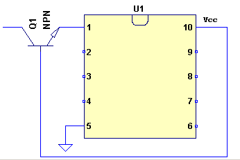

In the mean time the data and address from the counter shall be on the respective buses of the ROM. Can this potentially damage the ROM? ie. Supplying signals without the Vcc and Vpp. (I read that is is true for op-amps). Is the given protection circuit any good?
Could using a delayed start Vss be a solution? I guess not.
Can anyone please help me with my power supply unit....
Any tips or sample circuits will guide me.
Thank you.

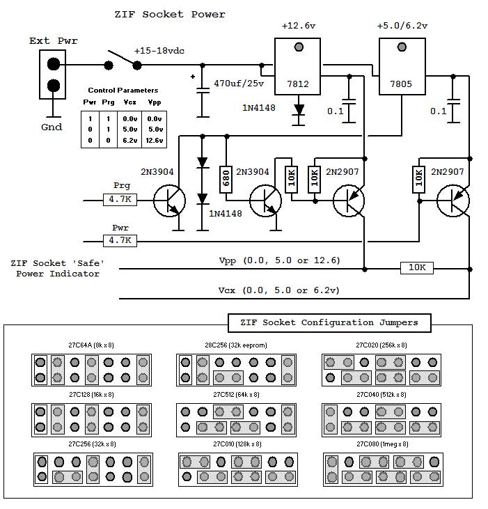

Do you mean for switching the programming voltage to the EPROM?, if so you can do it with an NPN transistor and a PNP one, plus three resistors.
What is the best solution that I could go for in my existing project.
We don't know what the limitations of your project are?, a simple answer would be to program a suitable PIC as an EPROM programmer, a 16F877 would probably have enough pins?.
Not sure if this will help but you're welcome to glean whatever useful info' you can from this circuit excerpt from a 'burner' I made several years ago (yeah, I know it's crude)...
Good luck with your project... Regards, Mike

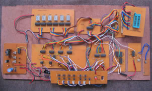

Well, Nigel, here is the final result of all discussions.
http://lord.loh.googlepages.com/eprom.html
You can see the picture of the EPROM Writer (Large Size Image) here and also the project report and circuit diagrams.
