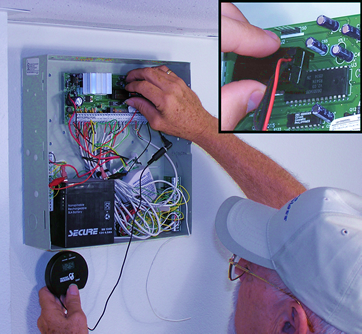

About 13 years ago while in an alarm industry distributors store they had an "alarm panel reset kit" for panels where the "programmers lockout" was activated.
It used what i can only describe as up-side-down ic sockets to fit over the ic and connect to testing device.

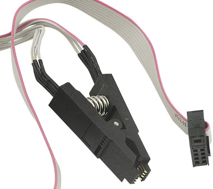

You didn't answer alec_t's question and all the suggestions are clips for SOP (Small Outline Plastic) packages with pins that are 0.05 " apart.
This sort of thing? What format IC (DIP, SOIC, other)?

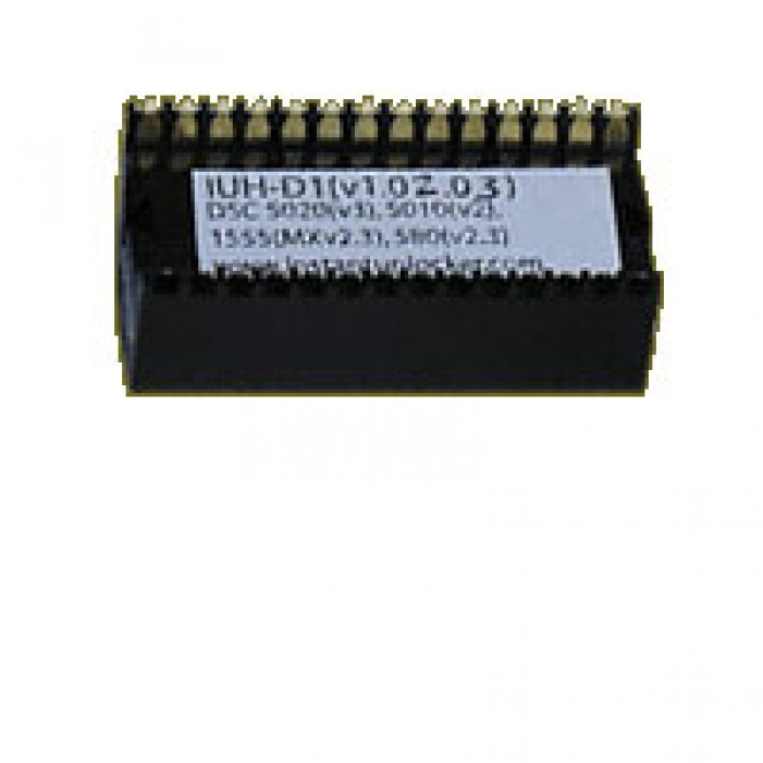

The socket is pressed down onto an IC, it has a circuit board soldered on top with a connector that via a cable goes to a "programmer" device.
Actually, THIS:
(product discontinued, these links will die soon...)
I don't think they had them made for this kit, that they were production.
Some guy found them in a catalog, and turned it into a product, and sold it to Linear (Nortek, IEI, etc).
The wayback machine suggests 2007, the products site was active.

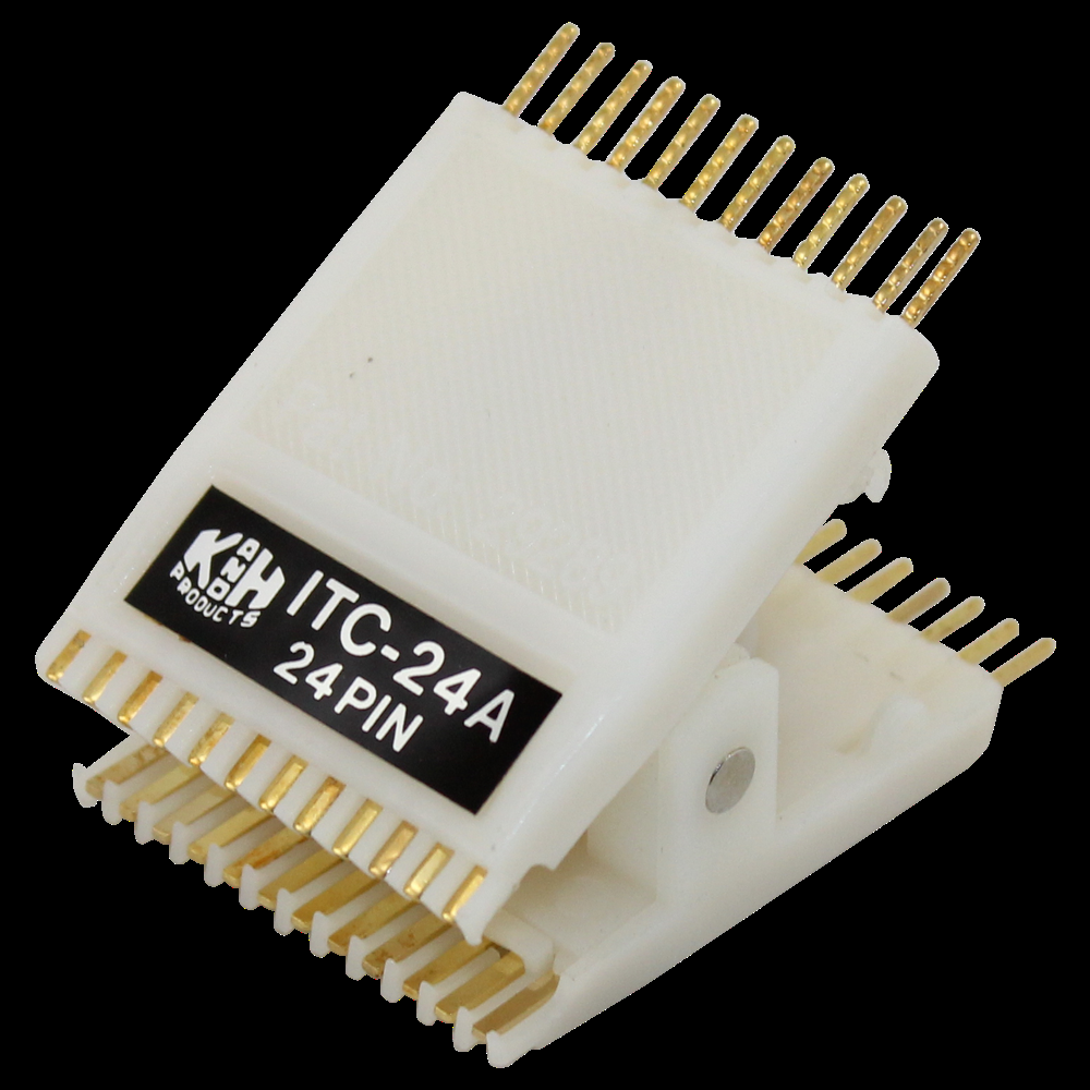

I've seen them many many years ago. I suspect they've been out of production for a very long time. The clip-on type as shown in ronsimpson's photos are what is used now.
What I was commenting on in my last post is the type of socket shown in Click-Here's photo in post #8.

What the Op wants is made by the alarm distributor
You press it over the chip and it clears the password
Good luck finding one for a old alarm
