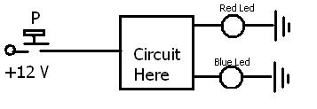

I have a push button and two LEDs (red and blue).
I want them to be assembelled such that
1. When I press the push button, one of the LED is turned on and glows. It stops after I release the button.
2. When I press the push button again, another LED is turned on. It also stops after I release the button.
3. Repeat 2.
Here is a pic for help.
forquestion-jpg.36334
I think I need to use things such as Flip-flop, But I don't know how to use them. Any help will be greatly appriciated.

I think, my question was too much confusing.
What I am basically asking is --> how to make a single push button turn on two different LEDs turn by turn?

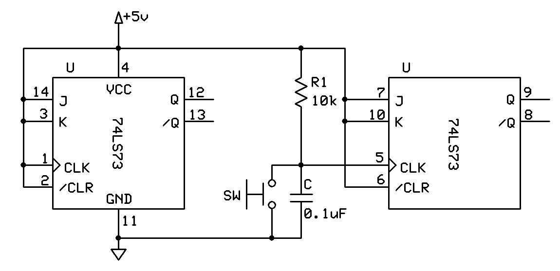

How do I create a clock signal??? Does pressing a momentary switch simulate the clock signal?
The "clock" is just a switch closure in your case. It either pulls the clock input high then low, oo low and then high, depending on the particular flip flop logic or chip. Mechanical switches actually bounce open and closed several times, very quickly as they close. To prevent this from toggling you FF several times you add a "debounce" circuit to your switch: How to debounce a switch

Can you provide a schematic of how you hooked it up? Unused inputs need to tied appropriately to +5 or ground.

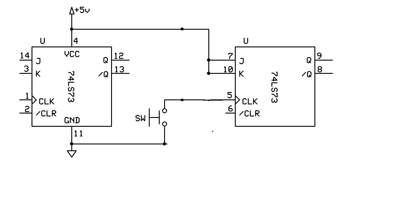

I had been using almost the same cicuit you provided but leaving the unused pin vaccant. I also didn't use the Capacitor and Resistor.
(see some modification)
modified-jpg.36388
KMoffett, I tried what you told and it worked!!! Thanks a lot.
(At first I was quite lazy to tie unused pin of the unused FF2 to +5 Volts. But it didn't work. So, finally I gave a last try by connecting all of the unused pins to +5 volts or GND (except outputs). And my last try paid me off.)
Leaving inputs floating on CMOS ICs can cause all kinds of unexpected results. Pullup or pulldown resistors assure the inputs maintain their

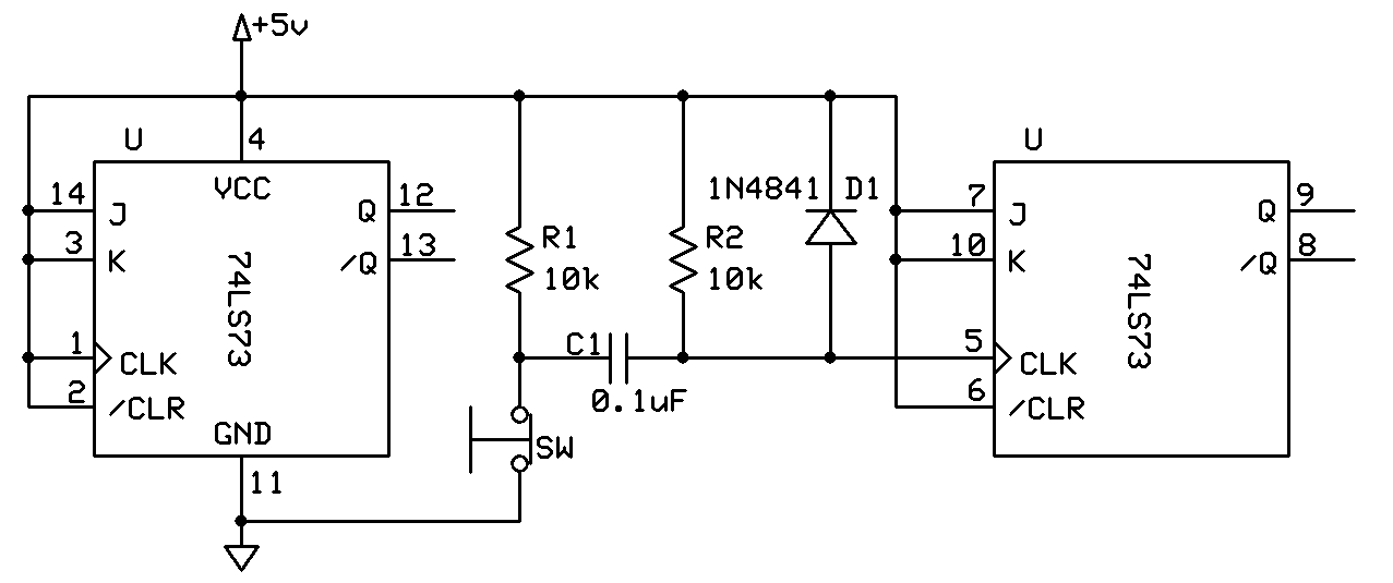

The circuit you provided is triggered on push. How can I modify it to be triggered on release???
I think that this will work. Note that the switch is a "normally-closed" pushbutton, where the original was a "normally-open".
Ken
I am sorry but I needed to use push to make switch. (Actually, I will be using a +5 Volt pulse that comes from another circuit. I want this circuit to be triggered on the end of the pulse)
