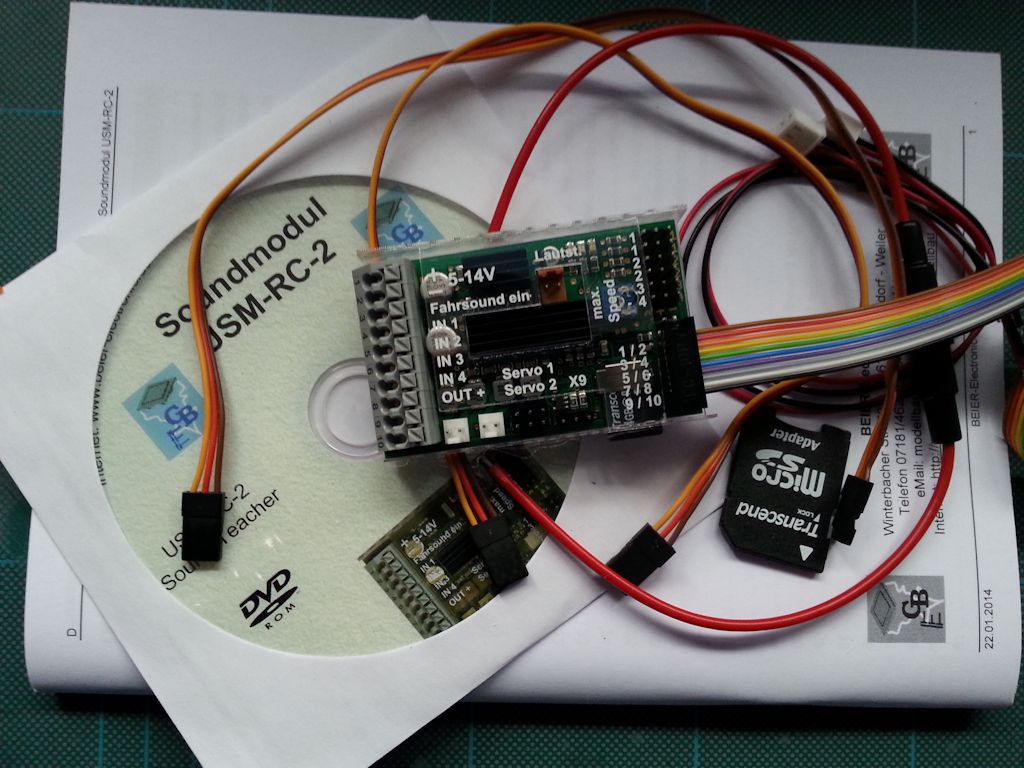

There is a electronic sound and light module that I would love to use BUT the manufacturer presumes you/I know about such!
I Have found some vids about the module and would be capable of power connection and programing BUT its the led connection I am really stuck on.

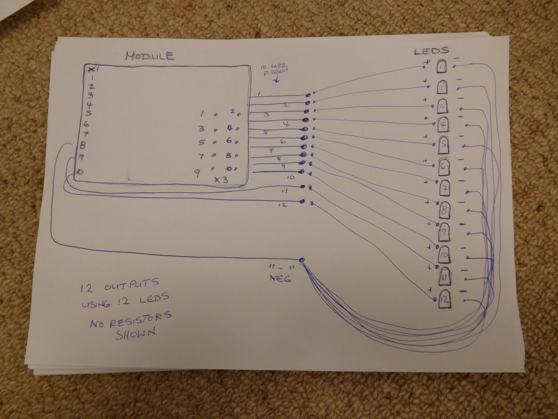

I need to find out how to wire led`s to a light and sound module, I will post a picture of the module. I am a complete electronic novice. I only need this because its for a Radio control truck I have just bought. I can solder BUT do not understand circuits,series,parallel or understand schematics. I will also post a hand drawn diagram of how I think its done. In my diagram I have only connected 1 led to each of the 12 outputs. I would need several with 2 leds,for headlights and tail lights etc.
The module has connections down the left side "8" is a +, "9 + 10" are also included as outputs 11 + 12
The bottom left of module has a ribbon cable,this has 10 wires,for 10 outputs.
So a total of 12 outputs for lights can be had.
I hope I have explained this so its understandable?
The diagrame I have drawn I can understand, if anyone has the time to draw a similar one showing 5 single led take offs AND 5 double led take offs I will able to work that out,i think!

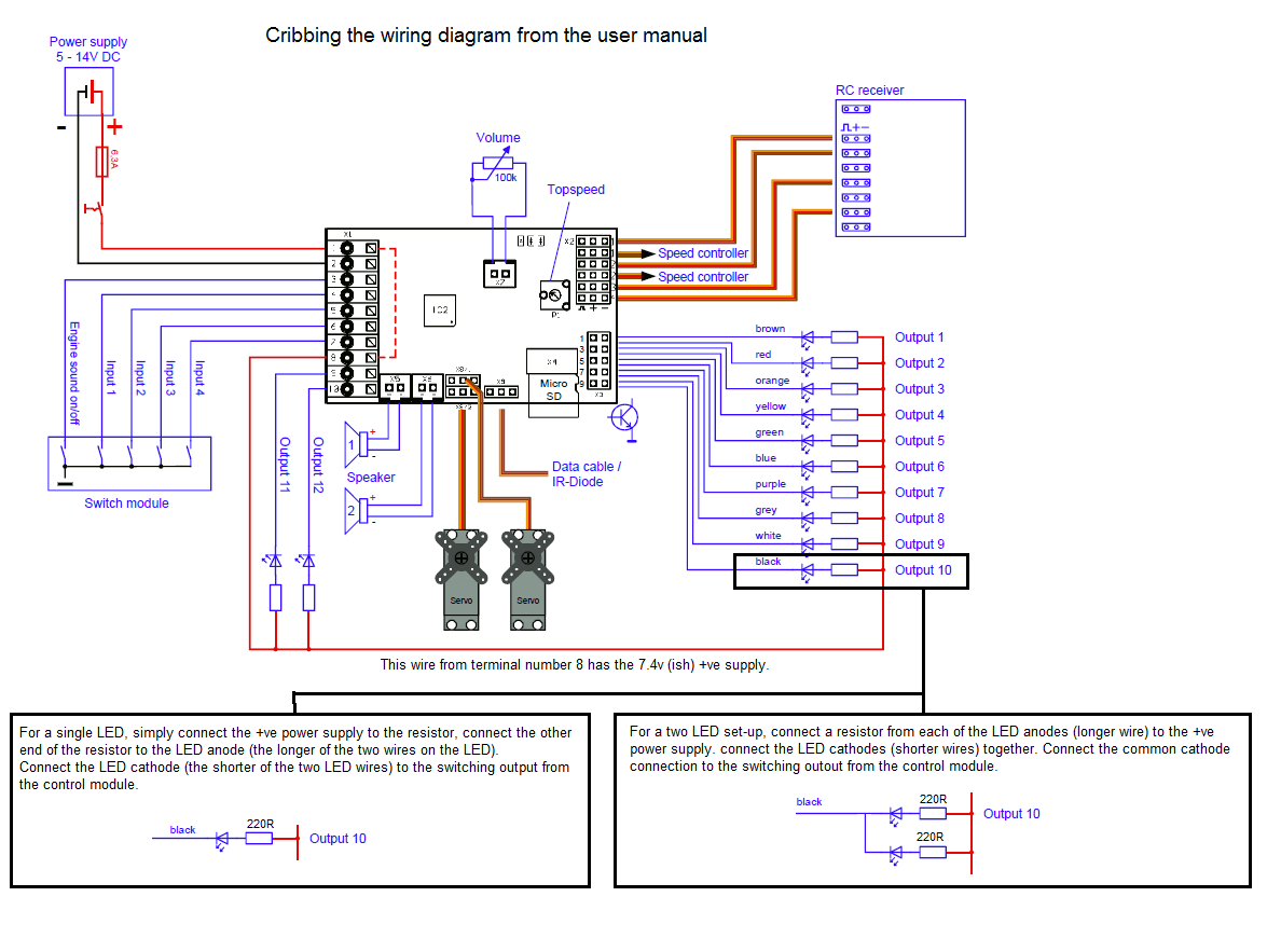

The sound/light module has an English language Manual available for download as a pdf from the manufacturer's site.
This explains that the switched outputs are NPN open-collector type, so switch the negative side of any load. The cathode of a LED could be connected to an output. The anode of the LED would connect via a current-limiting resistor to the module's positive supply terminal. Your schematic appears to show the positive sides of the LEDs being switched.
If the module supply voltage (in the 5V-14V range) is Vs, the rated forward voltage drop of the LED is Vf and the desired LED current is I mA, then the resistor value would be 1000 x (Vs-Vf)/I Ohms.

OK, let's try this for a wiring diagram:
Does this make sense?

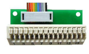

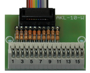

Jim, on the module makers site I found 2 connector blocks that might help me with a neater connection. One has system for the resistors but don't think this will work for the dual bulb runs.
