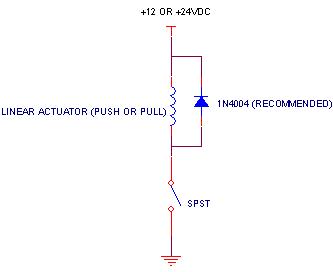

Here's a diagram to what pebe said. It's really just this simple (and sometimes the simplest answer is often the best). Just determine whether you want the door to be locked or unlocked when power is applied to the solenoid, and keep that in mind when buying the solenoid. For linear actuators, it's sometimes called push or pull, meaning the rod is either pushed out when power is applied or it is pulled in when power is applied. For safety reasons and to follow fire code, I would highly recommend that the door be unlocked when power is NOT applied (so probably a push-type). Also, whatever SPST switch you get, make sure it can handle the current that the solenoid will draw. The diode is optional, but I would recommend it to protect your DC power source. Here's a manufacturer for solenoid driven linear actuators:
http://www.ledex.com/
No offence tdb but i think mine is the simpler solution, its alot easyer to get a relay then it is to get a diode.
