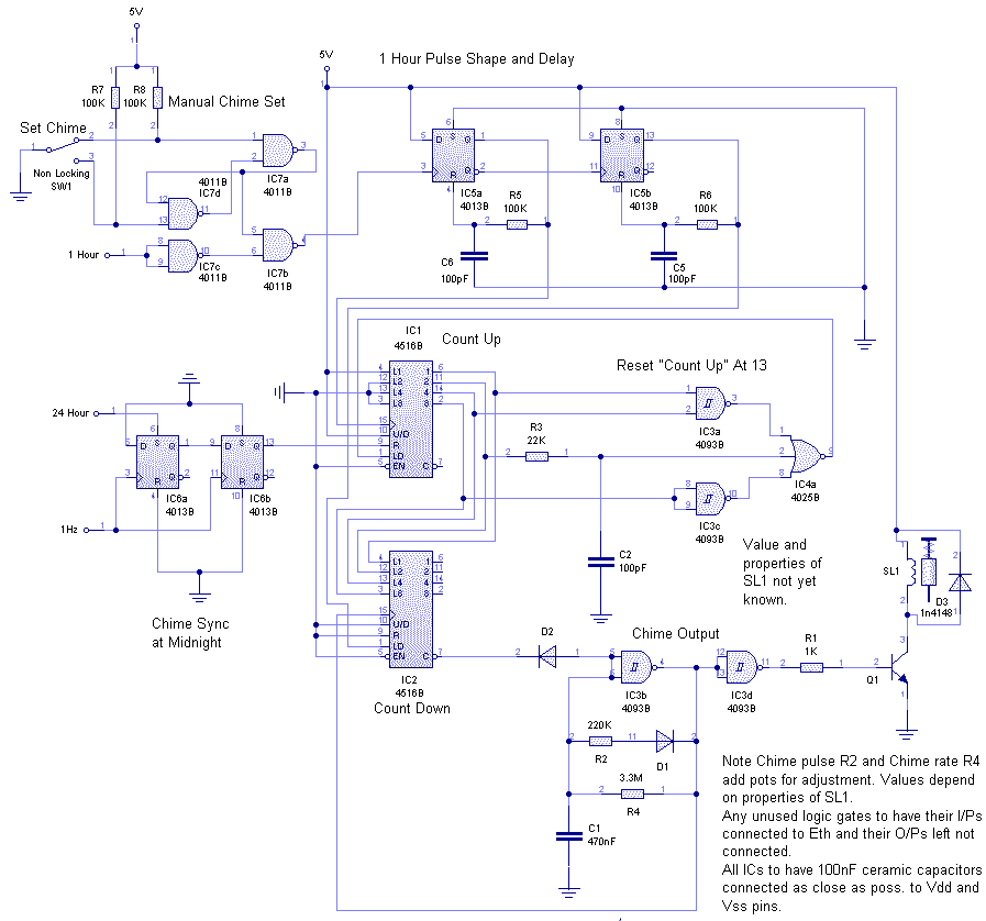

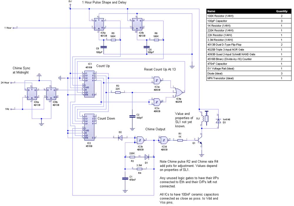

Corrected diagram enclosed.
I have added the missing diode. The slow release will be good as it will tend to remove any release noise (audio)from the relay as the bell is sounding.
I prefer your idea of using 4013s and have ammended the diagram.
I have added a note about unsued I/P pins on the logic gates but will add them into the fianl diagram when I know what is left unused from this and the digital clock cct.
I think when I used Orcad around 10 years ago it used to do this for you.
Brett.

I have not checked all of the IC pin numbers, but otherwise I can't see any errors.
You could use a MOS FET such as the 2N7000 for Q1 in lieu of the bipolar.
You should retain the 1k as FETs usually need a gate "stopper".

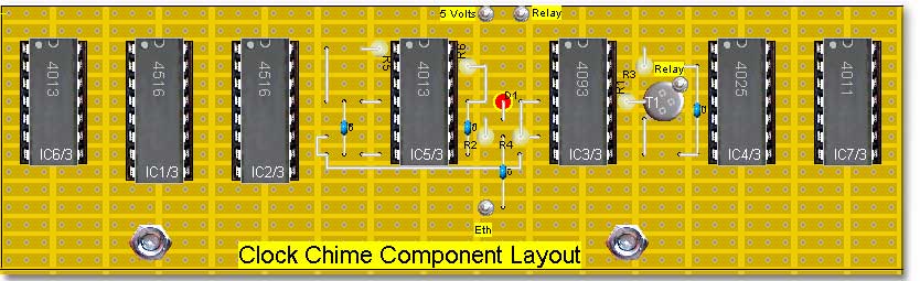

I have also drawn up a rough vero layout for the componets.

You may be able to buy a solenoid with a moving rod through the centre as suggested in your circuit.
As for the layout, if you rotated either IC1 or IC 2 through 180 degrees, it would make 2 of the connections shorter, eg. rotate IC2, then IC1/14 to IC2/13 and IC1/11 to IC2/12 would be short.
I did look at this due to the number of connections between IC1 and 2 but decided to keep all the ICs aligned to avoid errors when wiring. This is especially true when wiring the back of the board where you can't see the IC sockets.
I tend to position the ICs next to each other depending on the amount of interconects.

I do the wiring on the component side.

I tend to do all the short runs including the Batt and Earths on the solder side where you have access to all the copper under the ICs and the longer runs including to other boards, displays and switches etc on the conponent side.
On Tripad board you only get access to 1 hole on the conponent side.

A trick that I use when there are not enough holes for the wires is to drill out the hole to 1 mm and insert two 0.4 mm wires.

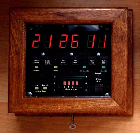

Update
I have just completed the Chime Cct and can confirm it all seems to work.
In the end I did not use the adjustable pulse generator but used the 1Hz pulse from the clock to drive the chime. I found this to be just right it also looks good as the chime is in sync with the seconds display.
I have added a chime on/off switch and an LED to indicate when the chime is off.
I will also add 4 LEDs to IC2 binary output so I can see what the chime cct is set to. This is handy when you want to sync the time to the chime.
I could have used a 7 segment display and decoder here but it is a lot of extra wiring when 4 LEDs wil work fine.
I have used a bell from an old telephone and have used a relay with a length of 2.5mm copper wire soldered to the armature as the hammer.
This give the nice soft chime I was looking for.

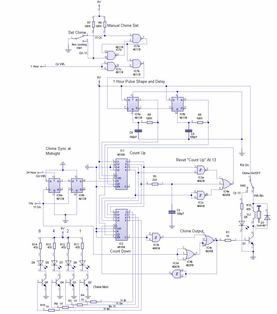

Here is the final diagram and picture of the front of the clock.
I have added a switch to turn off the chime. There is an LED to indicate when the chime is off.
LEDs are now connected to IC2 binary O/P so the chime can be set without waiting for the clock to chime out.
Brett.

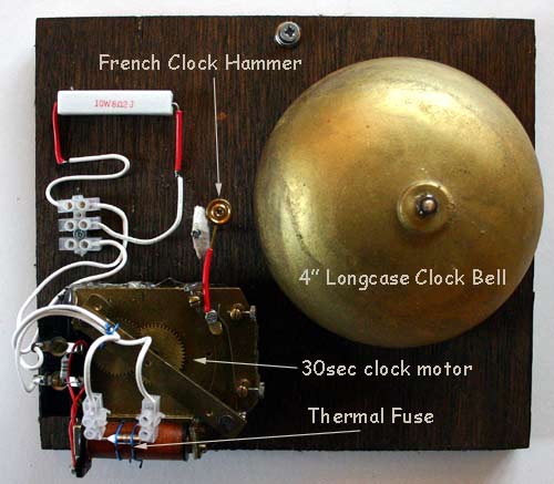

Clock Chime update
This circuit has been up and running for over a year now and I have now changed the chime bell to a larger unit driven by a 30sec slave clock motor. See below for pic. More details on the master clock link below.
