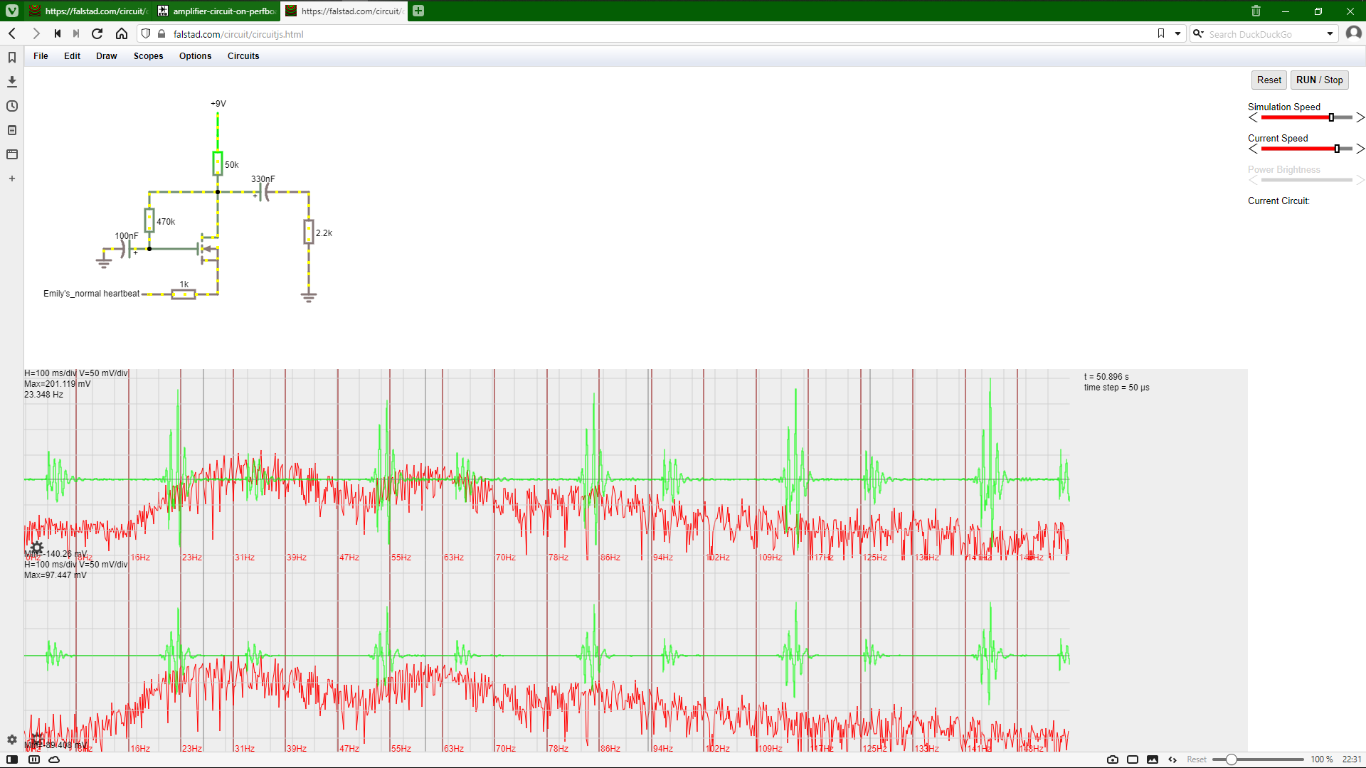

Now I show the perfect low distortion sinewaves at the output of my circuit
3 problems with that.
  1. Heartbeats are not perfect sinewaves; and certainly not 1kHz sinwaves. They are a mismash of frequencies ranging between ~10Hz and ~1000Hz; all mixed together.
  2. Your graphs -- I assume -- are the output waveforms; showing roughly 7V peak to peak; but the input stages of the phone are expecting the input from an unamplified electret mic. That's why everything is being clipped. Your circuit is designed to drive the 8 or 16 ohm input of a pair of headphones or speakers, not the input stages of smartphones.

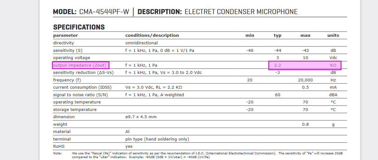

  3. Smart phones need to see an impedance of 800+ ohms(*)to recognise that an external mic is plugged in.
* Source of information
Further evidence:
By way of explanation of the sort of thing I think is required; a simple, ~2x amplification using a mosfet. Note I'm not recommending this as an actual solution, but it at least demonstrates the veracity of the simulator.
Note: how the input (lower trace) is somewhat less than 200mV peak to peak.
Note the output (upper trace) into 2.2k Ohms is ~350mV peak to peak.
Note how closely the amplified output waveform (upper green) tracks the input waveform (lower green).
Note how closeley the spectrum of the output matches that of the input.
It would need a low-pass filter; and probably a switchable or variable pass frequency depending upon heart sounds or breath sounds.
Feel free to tear the circuit apart; but please at least offer explanations and corrections.

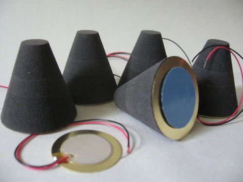

Interesting.. That sounds vaguely similar to the construction of a "drum trigger" using a piezo disc and foam cone as a contact point.
Those are designed to stand high impacts and long movements of the surface being sensed, so have a very tall foam block to absorb the impact.
Piezo discs are available in various diameters and very cheap - around 20p - 40p or so each when bought in 10s.
A piezo disc mounted in a shallow container such as a bottle cap, with a small self-adhesive foam pad eg. 3mm thick in the centre, just to give slight conformance to the skin, could give a similar effect as the piezo stethoscope pickup in the link?
You would need a high impedance preamp or buffer, but the output level should be quite high - it's in the volts to tens of volts range when piezo discs are used in drums!

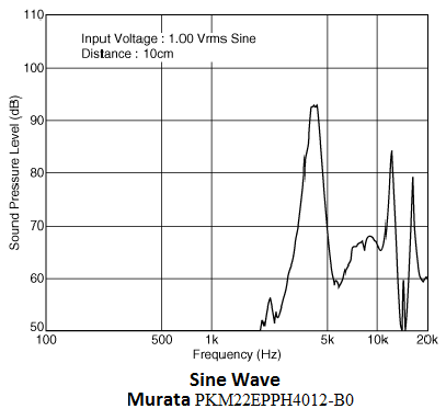

I never use a piezo transducer as a microphone because its frequency response is horrible.

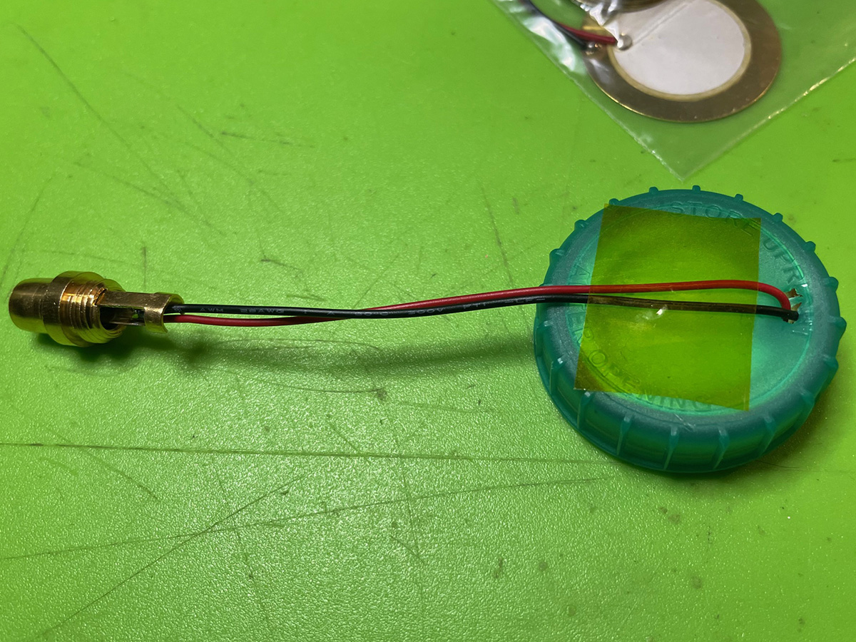

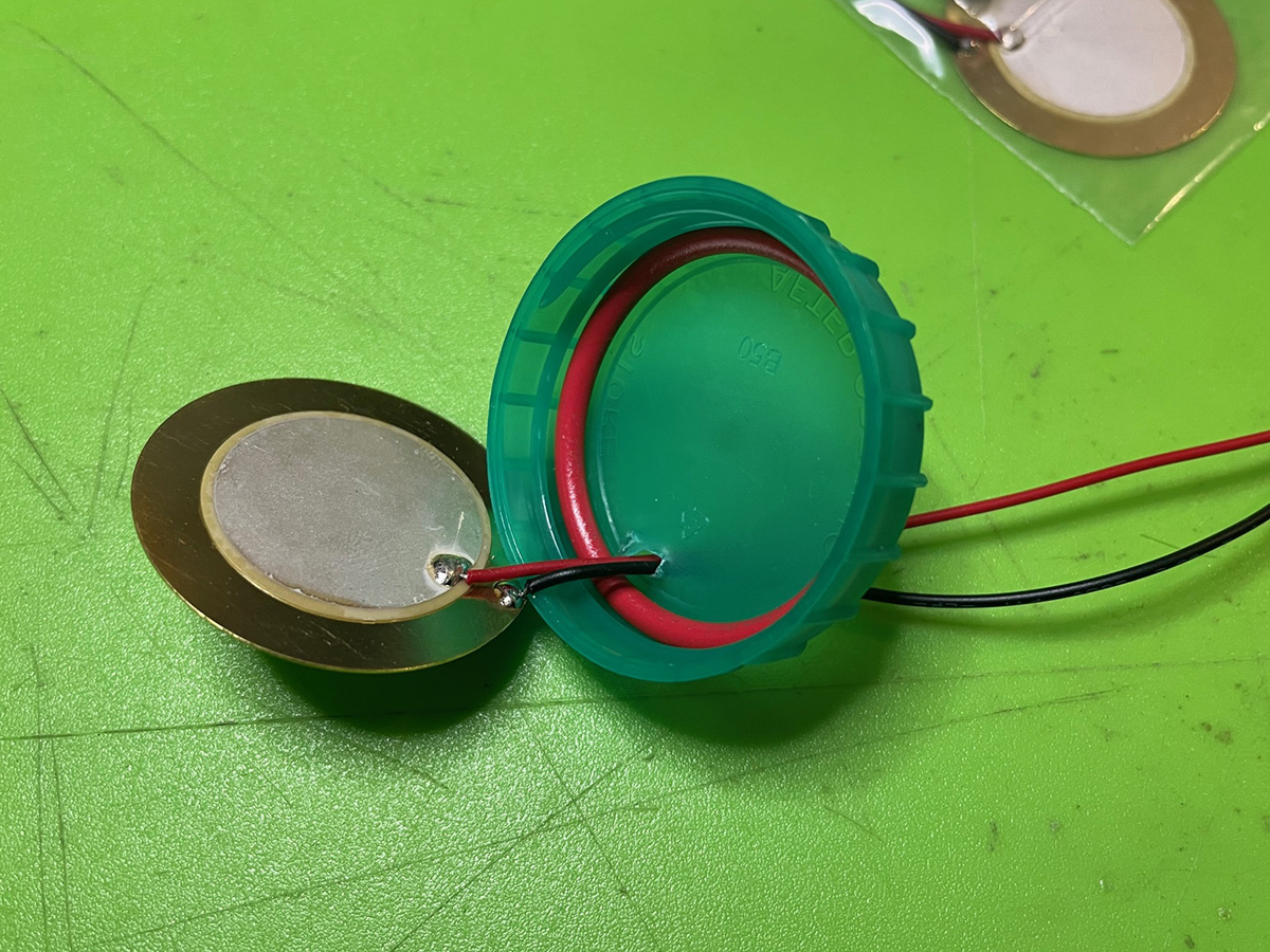

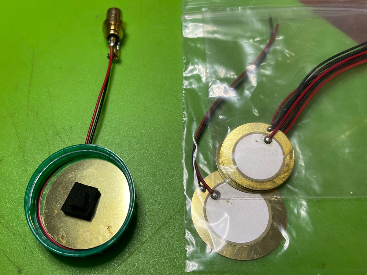

I could not resist testing that piezo idea..
It's a really basic, nasty setup - a plastic bottle cap with an offcut of thick wire fitted around the inside to support the edge of the piezo disc and a couple of bits of self-adhesive polyurethane foam panel gasket as a centre actuator, then tape over the wires at the back to stop it falling apart!
It works. Fed in to an audio interface set in "instrument" mode (eg. for a high impedance guitar pickup), it strongly picks up my heart when held against my chest. The output is almost entirely low frequency; not very audible but it makes my sub overtravel and thump if I turn the volume up much!.
The only processing was a 1KHz low pass before exporting it as a .wav, which actually did not make much difference.
I also tried a 50Hz low pass (-60db) out of curiosity & that also did not have much audible or visual effect on the waveform; I did not save that.
I suspect a much heavier casing, to add inertia and better restrain the disc edge, would improve output and reduce handling noise. I was holding it against my chest with one hand and operating the mouse with the other, so it's picking up movements from the hand holding it, the hanging cable that connects it & possibly a delayed pulse from my fingertips. Not an ideal test setup - but it's a proof of concept.
The .wav sample is here linked below; be careful with amp volume, use headphones, starting at low volume if you cannot hear anything . It may be inaudible on normal speakers but will send a subwoofer crazy..

A small piece of viscous "memory foam" may work well for the centre actuator? That should conform to the skin easily, but pass relatively rapid movements rather better than simple elastic foam.

Buk, the article you found is completely wrong about the electret mic and its low frequency response. It describes a condenser mic which is an electret mic minus the Jfet inside the electret mic. The Jfet in the electret mic already has the 1G ohms resistor biasing it. The article uses an old NE5534 opamp that has a minimum input resistance of only 30k ohms but at least 1M is needed. The OPA134 opamp I recommended has Jfet extremely high resistance inputs.

The frequency response of a piezo transducer is so bad that heartbeat problem sounds or lung sounds will be extremely distorted.

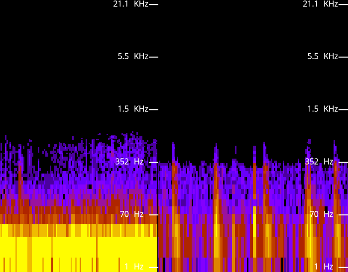

There is an aweful lot about that to like. It has a very strong signal right across the range that is needed.
This is it next to the the very clean 16 y/o heart from wikipedia:
If anything I'd say that you are overdriving the amp, perhaps try a lower voltage.
Also, try to mechanically isolate the pickup from handling. First pass simple suggestion would be something like this:

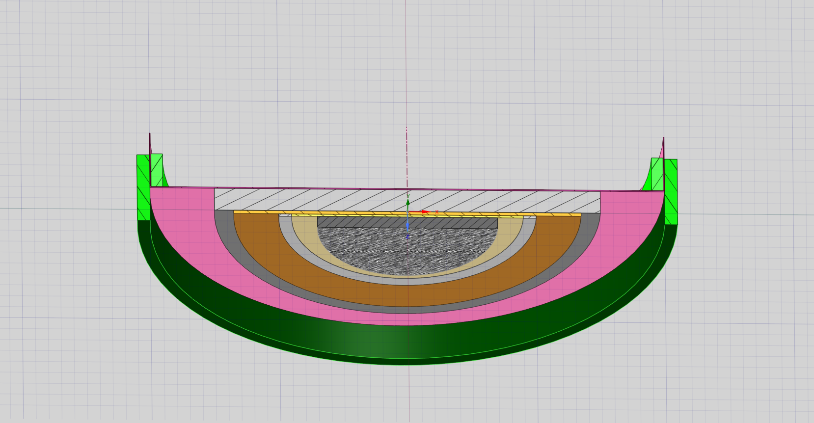

The pink is a rubber (glove?) membrane sandwiched (and glued) between two close-fitting peices of plastic (green) (bottle top and neck of the bottle it came from); the grey is a billet of something heavy -- steel/brass/UHMW PE -- glued to the membrane; the gold/silver/cream is the peizo glued to the billet; and the fuzzy grey is something comfortable to contact the skin. Could be foam, but I think silicone rubber would be better for sound transmission.

I liberated a 27mm peizo unit from a dead dect phone last night and I'm working on finding a suitable rubber for my membrane. I've gathered together materials for the other parts of my steth head design, but they'll need some fettling.
