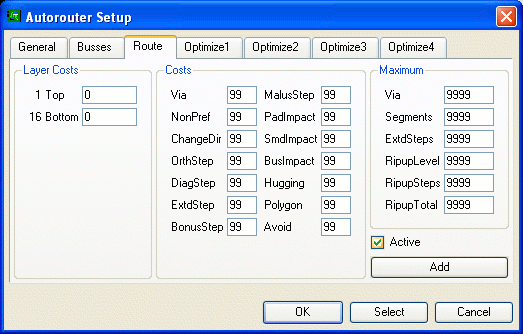

Was wondering, is there an option to make single sided boards, instead of the default double sided ones ?

Can't you just design using one layer instead of two? And then specify that it's a single-sided board? Nothing says you have to route stuff to the other side.
Yes, I use Eagle 4.15
When selecting the Autorouter icon, you will note on the General Tab,
the option preferred Directions. Simply select the "1 Top" layer to N/A
and there you go.
TIP, set all variables (as per attached image) to MAX.

The default autorouter settings for the free version is top and bottom. Just turn off the top layer (assuming you want bottom traces). Note that through hole components are connected to every layer.
