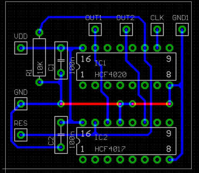

I have done a nice eagle schematic.
In schematic capture when doing the PCB there are some wires you cannot ROUTE anymore because they will overlap each other.
What you all doing for this UNROUTED wires? How do you place jumpers or pads for them?

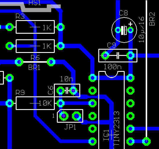

Hi Gayan,
first you should try to optimize component placing. This will allow for more bottom layer traces. If there are still unrouted traces manually route on the bottom and then switch to top. Continue routing on top until you get to a point to finish the trace on the bottom layer. The lop layer trace should be a straight line for a straight piece of wire to use for a jump.
If you want to make the PCB yourself just omit the top layer and make it single sided. If you turn the design into a PCB manufacturer's you should get rid of top layer traces - otherwise he'll make a double sided PCB.
In that case ripup the top trace with an unbroken connection between vias (air wire with same net name). Use layer21 (component) and draw a straight line between those vias to remind you there is a jump when placing the components. If possible also name them on the PCB like "BR1" (BR=German abbreviation for jump or bridge)
About like this: (attachment)

EDIT: This assumes you want to etch your own PCB>
Layout the board as if it were two sided but etch only the bottom. After etching jumpers on the top side will solder to the vias on the bottom.
The attachment is not a great layout but it does a good job of illustrating what to do. It shows the top layer in red. Each red trace becomes a jumper.
It also shows that you can run traces between pads but it requires good etching to make it work.

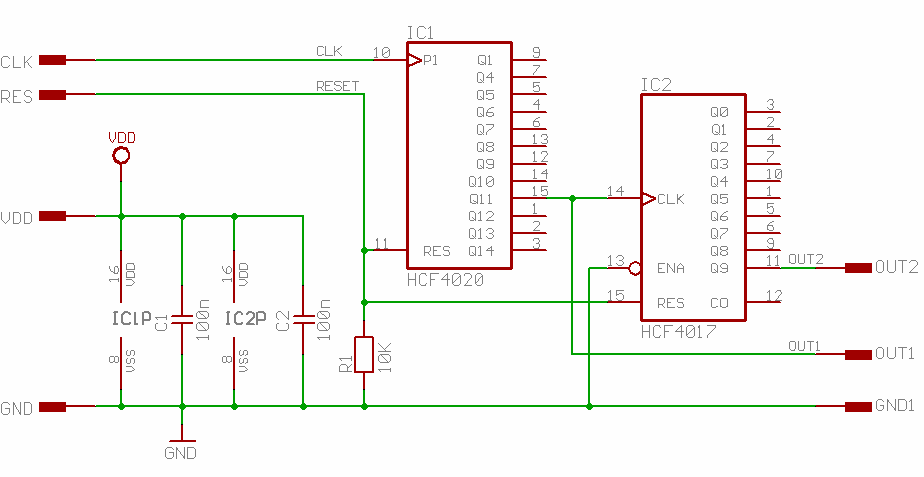

Hi Gayan,
the jumps in that post were vias. The difference between a via and a pad is this: A via is automatically generated changing layers when routing. A pad is component and consists of a symbol and a package.
Now please take a look both, the schematic and the PCB-layout. The schematic contains four invisible pads, all connected to ground. (Just because I wanted it that way for demonstration purposes.)
Does it look ugly? :)
The layout could of course be done using a single layer board by placing the components another way. However if you are forced for some reason to place the I/O pads on top of the circuit you'll be confronted with a pretty wierd ground trace.
Pads in a schematic are treated like components. They must be connected. (otherwise the ERC will fail.) :(
There is more than one advantage to using pads instead of vias: First, ripup stops at the pad, while it might also delete a "valuable" via. Secondly, you can move the pad all over your PCB and it is still connected (to bee seen by the air wire). Drop it where ever you want and route the trace between two pads using the top layer or omit routing and draw a layer21 line between those pads as a reminder for a physical jump.
Here is an easy way to make "jump-vias". :D

To use the "invisible" pin (pad) in the schematic switch to "Display" --> "pins". Grab a suitable pin out the libary and place it on the desired net. It connects automatically, so you won't have to worry about deleting and redrawing the net.
The sample circuit has no practical use. It was made for demonstration purposes only.

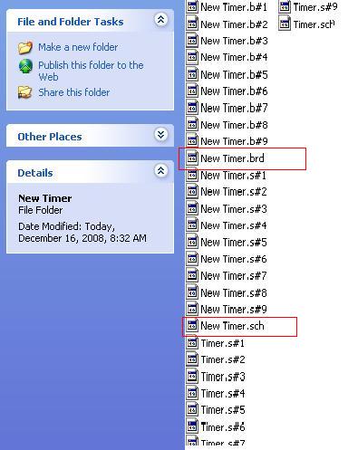

The thing was in my project directory if I create a project as "New Timer" then it saves files like this------>schematic = New Timer.sch & Board = New Timer.brd
But see my attachment it creates lots of duplicate files.Sometimes I'm deleting this files may be that cause to pop up that error message.

Hi Gayan,
to regain the full files (schematic and board) copy the latest backup files, e.g. timer.s#9 and timer.b#9 in a different folder. Then rename them for the suffix "sch" and "brd".
When loading the schematic the consistancy check should be alright unless you goofed already there. If schematic and board are consistant you just have to take care of the latest changes of your design - instead of redrawing the whole thing. :D
