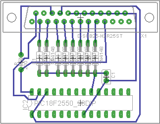

Hi, I wanted to know why the boards i make with eagle have the component outlines blocking the connections,i had to make them with a marker.Also there are some devices not available in my Eagle 5.3.0.Is it because i am using it as freeware?Like in another post a guy asked for some package and i didnt have it also but i guess he found it!And no library was missing!
Post a PDF of your PCB. It sounds like you are confused about what layers to enable. What package(s) are you looking for ?

Heres a sample its the ART2003 programmer.Thanks for your replies.

The display icon is the one just below the i (not the eye) on the toolbar. That would be the 2nd from the top on left.
It is just above the move tool.
Click on it. You will see a list of layers. Select the NONE button then go up into the list and turn on the BOTTOM PADS and DIMENSON layers. If you print now you should get what you need to do the bottom layer. (Be sure to select BLACK and SOLID in the print dialog).

Thanks 3V0,it works like a charm, now about making packages.Do you know of a good tutorial?
