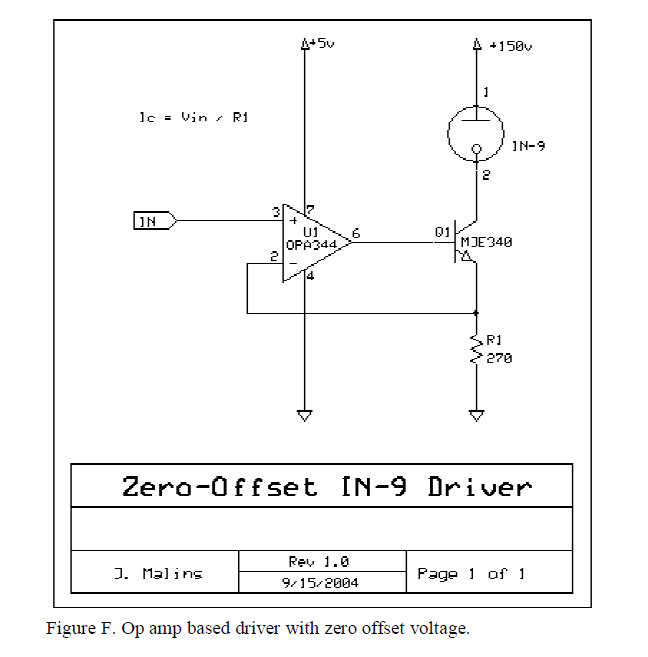

I like the above circuit.
This is more in line with my idea of driving with OpAmp's.
This way I can apply the ideas in this sheet about offsets to zeroing the tube etc.
Edit: this pdf also drives with PWM in figure 2 ....
Trouble is the arduino's don't have enough PWM outputs.
This schematic from your posted pdf is exactly the way I was suggesting the current generator transistors should be driven with an opamp. This will allow you to control the ionizing current to the n th degree.
From what I have seen so far, you should be able to lead the way with absolute precision control of the CC tube current using a micro and the circuit would should be relatively simple too.

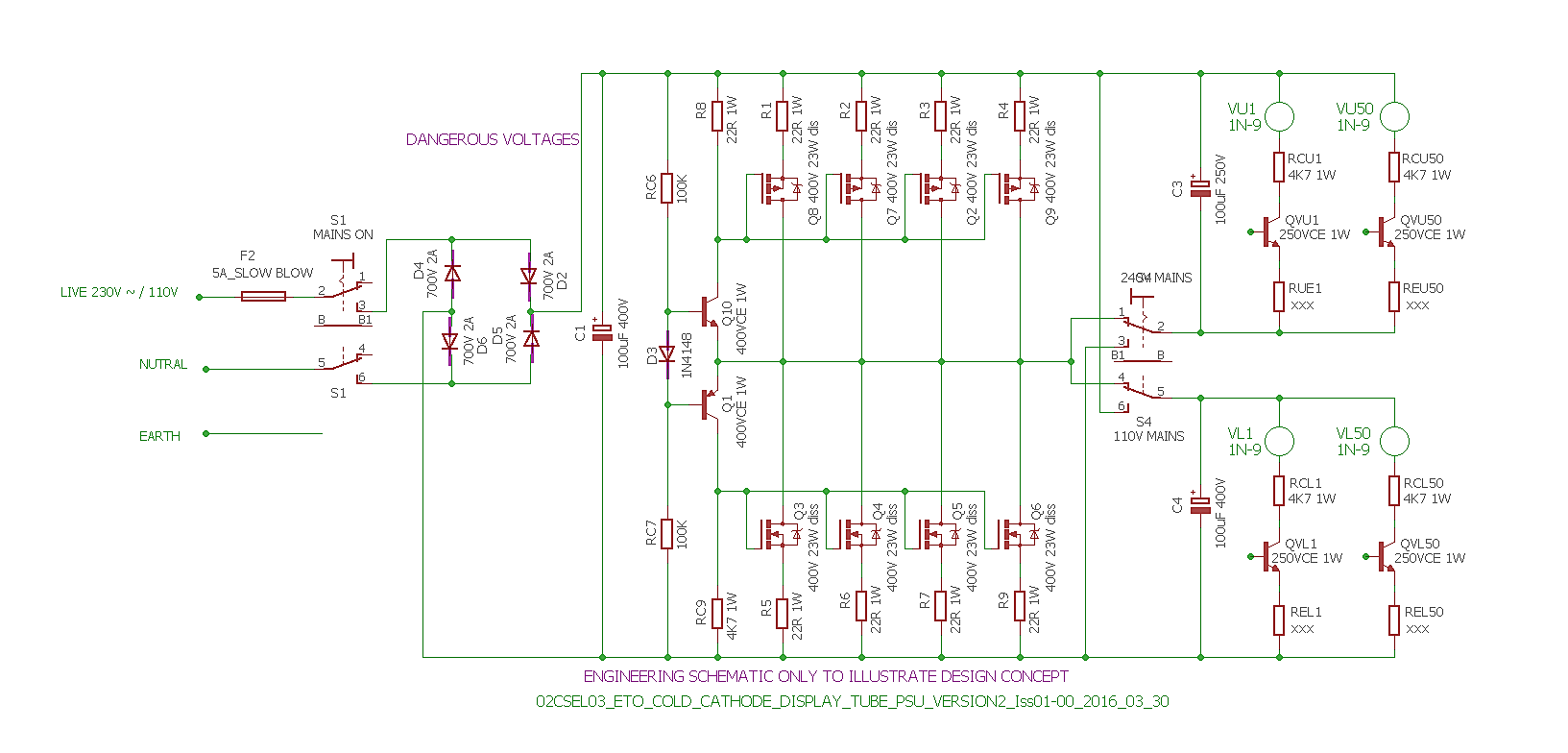

Hi again fire,
here is a transformerless CC display PSU which can be switched for 110V and 240V mains supplies. It is non isolated so the control signals for the tube current driver transistors would need to be isolated or the whole system referenced to the voltage rails.
For 110 V operation only, the two BJTs and eight MOSFETs would not be required.
spec
ERRATA
(1) R8 should be 4K7 not 22R
(2) For every 10 of CC display tubes (CCDTs) add another 100uF capacitor across the CCDT supply line, in parallel with C3 and C4 as appropriate.

Hey Spec,
Was wondering about this circuit.
Why have you used 8 Mosfets ? and mixed N and P types ?
Can't you do it with just 2 big fat ones.
400volt P channel ones at 23watts seem to be rare ?

Hy fire,
Because you obviously know about electronics, the circuits I have posted are only engineering outlines and have not been optimized.
The eight MOSFETs are just what I think can do the job without me having to do any thinking (I haven't even checked for suitable types of MOSFETs).
Sure, if suitable single MOSFETs can be found to dissipate 92W at 160V and withstand 400V that would work fine and would simplify the circuit. In fact, bipolar junction transistors or, more likely, IGBTs may be more suitable.
A couple of things to consider are:
(1) secondary breakdown and safe operating area (SOA) is often the limiting factor with power transistors rather than the data sheet max power rating which is a fairly meaningless parameter and is only really there for marketing purposes.
(2) The other limiting factor is maximum junction temperature: same comments as (1) above about transistor power rating.
(3) 92W is a lot to dissipate with one device and would require a huge heat sink with a low thermal resistance to air. So it would really be a trade-off between more transistors or a bigger heat sink. The more transistor approach is liable to be smaller and cheaper, but I haven't checked.
It would be possible to alter the circuit to use a single sex power transistor- NMOSFET for example.
Incidentally, the transistors would only dissipate 92W if one bank of 50 tubes were all off and the other bank of 50 tubes were all fully turned on with 12mA each.

Would love your input on a single sex.. N type Mosfet circuit.
I assume you would just chop out D3 and get rid of all the stuff at the bottom making the emitter of Q10 the common negative ? C1 Negative would also connect to this rail ?
Q10 biasing would be the same ? ... maybe ?
I think I have to go this way as the transformer is 2.2kg's .. and too dang big. .. and expensive.
Thanks for all the tips on picking a device .. mosfet of otherwise. No degree here. First I had ever heard of IGBT's ... looking at them now ... and they look GOOD !

Think you are right about the heatsink ... one point source of heat coming from a fat transistor would be harder to dissipate over a large heat sink using multiple devices.
You are on the right grounds but it is a bit more involved than that. With multiple devices you could run the heatsink at a higher temperature without exceeding the maximum junction temperature of typically 175 deg C which is the controlling factor.
I did a couple of calculations and a single devices (one NMOSFET and one PMOSFET) would need a single heat sink of around 0.75 degC/W. That would be a big expensive heat sink. You could probably get away with a single device on safe operating area grounds though. On the other hand, with four devices, a single heat sink of 4 * 0.75 degC/W = 3 deg C/W would probably do. This would be smaller and cheaper.

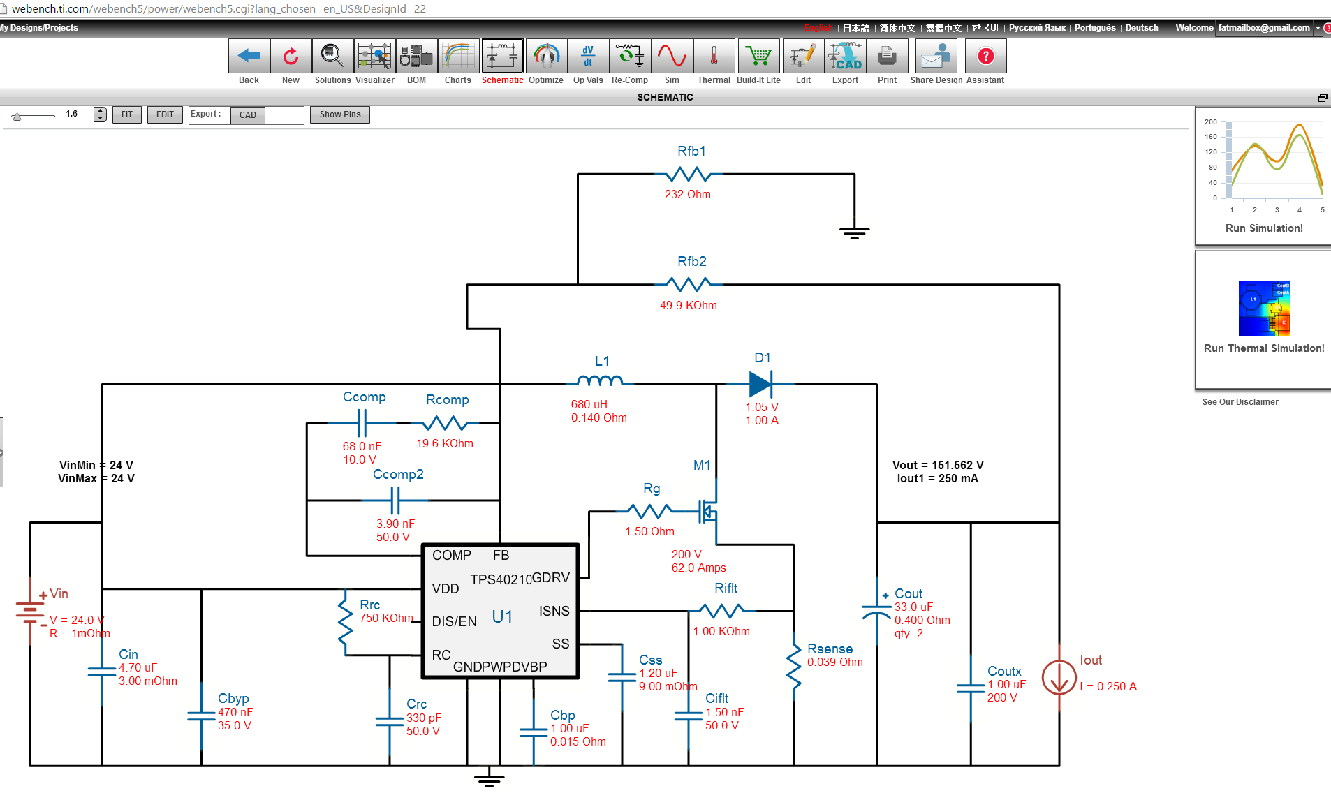

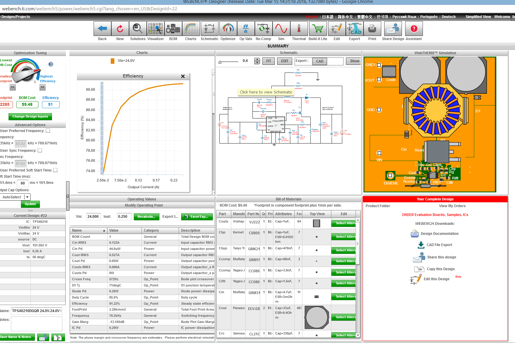

I have been playing around with TI Webbench design.
Auto SMPS design ... I think you still have to tweek the layout.

Check this site out ....
https://www.ti.com/lsds/ti/analog/w...DCMP=hpa_design_center&HQS=analogdesigncenter
It's almost magic for SMPS design....
