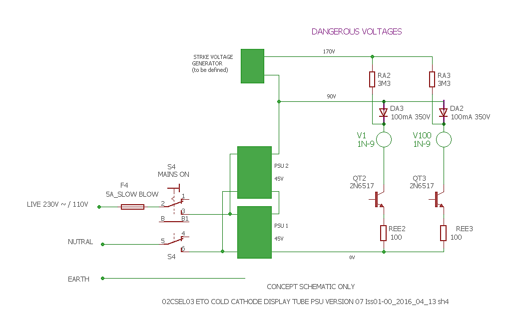

I have spent the day learning a little eagle cad and have fleshed out the Les Jones Bucker Circuit (made it pretty).
This circuit (if it works) could be the answer to all the problems ?
The way I see it .. limited amps for striking through the fat resistor he has put in. Eliminating heat problem.
Diode protection so we don't go back to the 78v side.
And .. it's so sweet that even the main sustaining voltage is above spec and will have plenty of current.
Waiting on some caps before I test build. Have no idea what I need so am just going to try a few smaller HV types.
This is my first eagle file .. so ignore all the values for now.
Will put the popper ones in if I can get it to spark up.
Wotchathink ?

I don't like being a killjoy, but afraid the circuit will not meet your specification.
The 55V transformer secondary windings have a tolerance of 57.25 +- 9% when all the variables are taken into account.
(1) 57.25 RMS - 9% = 52.095 RMS
(2) 52.095 RMS * 1.414= 73.67V peak - 1V for both rectifier diode forward drops (500mV each) gives, 72.67V peak.
(3) 72.67 peak - 5V ripple voltage = 67.67V trough.
This does not meet the tube running forward voltage of 70V. Neither does it give any voltage across the control transistor. If you allow 10V minimum across the transistor you need 85V minimum, taking ripple voltage, to run and modulate the tubes (I would put a tolerance of +-5% on the tube running voltage too).
Of course, the extra voltage required can be provided by an extra winding on the transformer core.
Because of the variation of the supply lines and the ripple voltage the circuit will not be as efficient as you might at first think. That was why I went for the simpler circuit in post #147
Incidentally, the Les boost strike supply can be reduced to one capacitor and one diode as a DC supply is not required to strike the tubes.
Al in all though, nice work
(1) 57.25 - 9% = 52.095
(2) 52.095 * 1.414= 73.67V - 1V for both rectifier diode forward drops gives, 72.67V
(3) 72.67 - 5V ripple voltage = 67.67V.
This does not meet the tube running forward voltage of 70V. Neither does it give any voltage across the control transistor. If you allow 10V minimum across the transistor you need 80V minimum to run and modulate the tubes.
Of course the extra voltage required can be provided by an extra winding on the transformer core.

Here is a saving the planet version of the tube PSU:
NOTES
(1) Almost certainly a 48V 2A version of the power supply could be procured. This would be smaller and possibly cheaper.
(2) The 48V PSU are adjusted to 45V
(3) There are many ways of implementing the strike voltage generator. This should be simple in view of the very low current requirement.
(4) There are no heat dissipating collector resistors.
(5) The transistors would only be dissipating 226mW maximum each.
DATA SHEETS & SOURCES
(1) 48V PSU
(2) Transistor 2N6517
https://www.onsemi.com/pub_link/Collateral/2N6515-D.PDF
ERRATA
(1) For every 5 tubes fitted, place 1 high frequency decoupling capacitor between the 106V supply line and 0V.
(2) For every 10 tubes fitted, place 1 high frequency decoupling capacitor between the 158V supply line and 0V.
Errr... I can't come up with an efficient power supply can I ?
