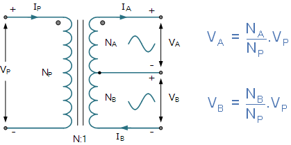

Is the ±23V input voltage two separate voltages measured to ground? You need separate voltages for a dual supply.
yes they are separate .I have a transformer with mid tap point, and between tap point and the other two wires i meassure around 18V ac which means around 23 v dc after filtering .
My english it is not so well so i will post a picture of the transformer:

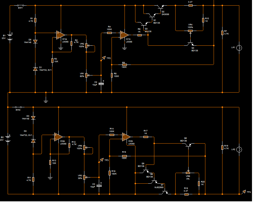

I also found a circuit with op amps for positive side and i adapted for negative side. I am not sure if LM358 is suitable for this. I will attach the circuit, and please let me know your opinion.
Thank you

If you look at the LM317 regulator data sheet, near the back where the applications are, you will see how to add a pass transistor(s) to the 317 to get higher output current. This is magnitudes simpler than the circuit you found and will probably work better too.
There is a negative regulator that is the 317's mate.
A negative regulator is 337. I know about that and i will probably build a psu with those two. But I was asking if the circuit that i posted is good and if it will work in real world.
From a cursory look it would appear that the circuit you posted would work, but of course it's has significantly more parts then the supplies using IC regulators.
