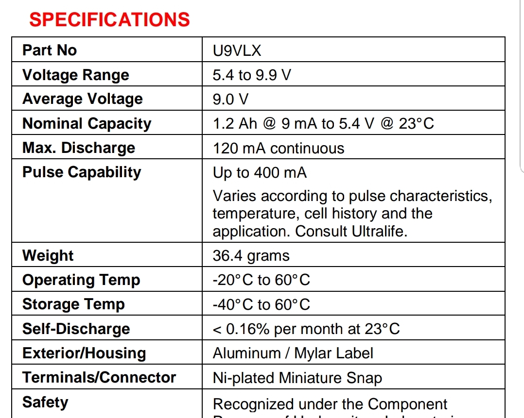

Here's the specs on a lithium "9 volt" battery. It's not the one linked above, but for a Ultralife 9 volt lithium battery.
The average voltage is 9 volts.
But look at the voltage range! From 9.9 volts down to 5.4 volts.
A 9 volt alkaline battery has a usable range of 9 volts max down to around 7 volts where it starts to drop quickly.

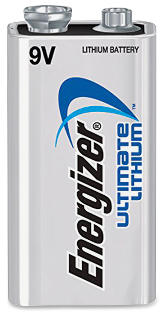

Energizer in North America has been selling their excellent long lasting 9V Lithium battery for years but it is expensive. I got free samples of their 1.5V AA Lithium batteries and they are also long lasting and expensive.
