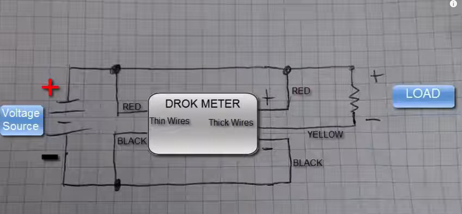

The issue I am having is when I try and set this up with a 12 Volt DC power source and a small 12 Volt light assembly nothing works, it is like it is dead.
The connection points are very basic that is why this is so embarrassing basically you connect all of the Red colored wires to a common positive and the Black colored wires to the the common negative. That leaves the yellow wire and that is connected to the negative of the light source.
Is this correct????

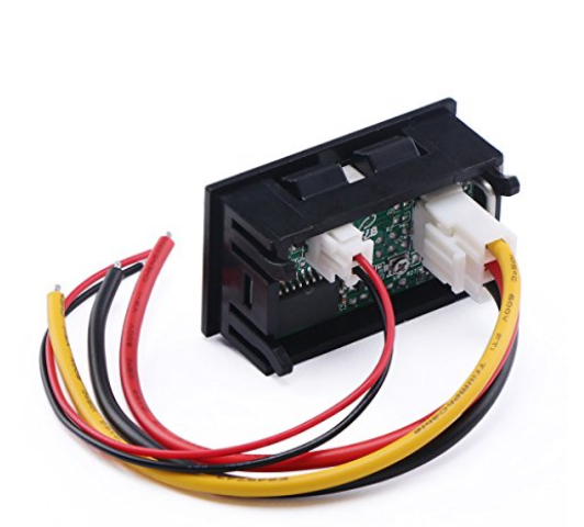

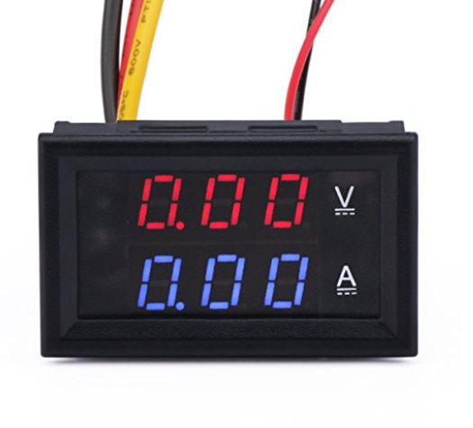

Hello again here is more information on this small meter. There are several versions mine does not have a Shunt with it as I has a built in shut that will handle to 10 Amps.
On the back of the meter it has some numbering (DSN-VC288). I am not sure if this will tell much but have more information below as well as images of the unit.
Working current: ≤20mA Display: 0.28 "Two color blue and red Measuring range: DC 0-100V 0-10A Minimum resolution (V): 0.1V Refresh rate: ≥100mS / times Measure accuracy: 1% (± 1 digit) Minimum resolution (A): 0.01A Operating temperature: -15 to 70 ° c Working pressure: 80 to 106 kPa size: 47 × 28 × 16 mm / 1.85 * 1.10 * 0.63 " Net Weight: 19 g Weight: 29 g

The two thin red/black wires must be wired to a separate power supply (or you should put a 100mA fuse in line with the red wire).
The Thick Yellow wire is Voltage sense (For the Volt meter part of this meter)
The Thick Red wire is + Current
The Thick Black wire is Ground (Common negative).
Remember that this is an AMP meter (red/black) so it should be wired in SERIES with the load that you want to measure
Now I am totally confused are you saying the the wiring diagram is wrong?
The wiring of the battery, Dork and out put device is done in Parallel?
For me it is the ability to measure Amps; voltage is of much lesser importance.
I have problably same one. In my case it needed aditional isolated power supply.
Winding diagram was wrong.
But as i rember it requiered external current sense resisitor.
The one in the photo has a built-in current shunt; the loop of heavy bare wire just behind the connectors.
From a quick search there are several variations of these with the same model number and different wiring.
Assuming yours matches the photo:
Try metering between the thick wires in different combinations - two should have a dead short (the current shunt) and one high or higher resistance to those?
That will at least determine the current and voltage parts.
