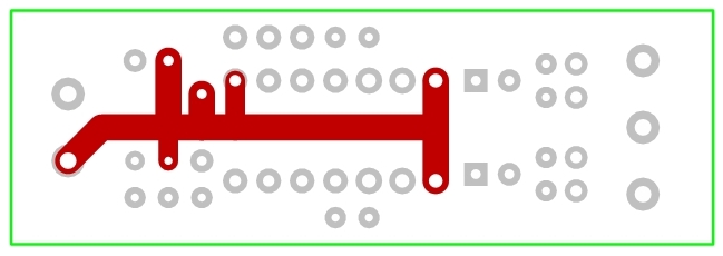

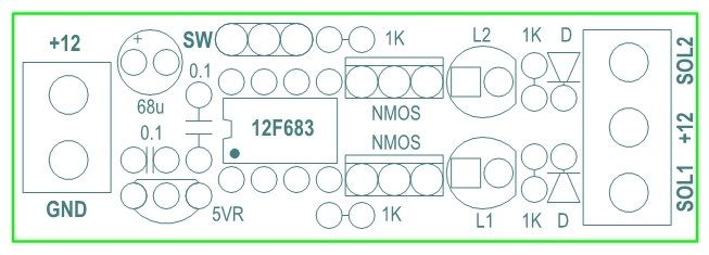

Here is an idea with a simple Microcontroller with two switches to control the speed up or down.

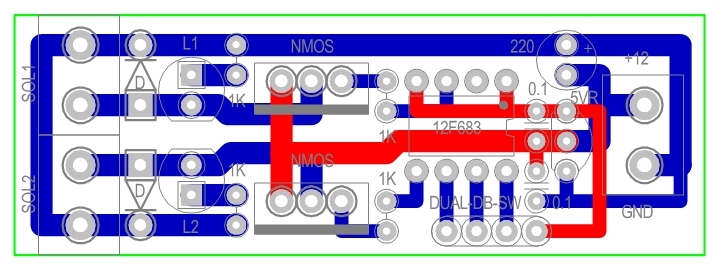

Updated Circuit Using a uC (PIC12F683). With two switches (up, down) the timing range could be set by increments of 1 seconds. Timer range from 1 seconds to 24 hours. Board size: 0.75"x 2"
project cost $3.00. The whole board can be placed in a small project box or placed in a shrink tube to protect it from the elements.

Hi RF
I have not written the assembly code since I got busy with work. But the concept is very simple. It first sets a delay time. Then program will check both SW inputs for SW push. If up is pushed, delay is incremented. If down is pushed then delay is decremented. The third option is when SW1 and SW2 are both pushed which will set the delay in minutes. Then up or down sw push will change the minutes.
After the delay is set and the value is saved, the code will proceed with Sol1-on Sol2-off, then the saved delay, then Sol1-off Sol2-on, then delay again. Then it goes back and checks SW's status again.
Instead of PIC12F (small package), you can switch to PIC16F (more outputs). Use 7 bits for 7-segment, 3 outputs for positive feeds of 3-digit 7-seg (multiplexing 3x 7-seg). 2 Outputs for NMOS drivers. Push buttons for Up and Down, Push buttons for Minutes/Seconds mode change.

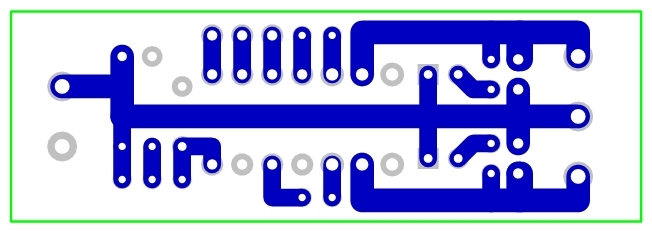

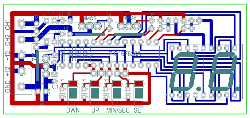

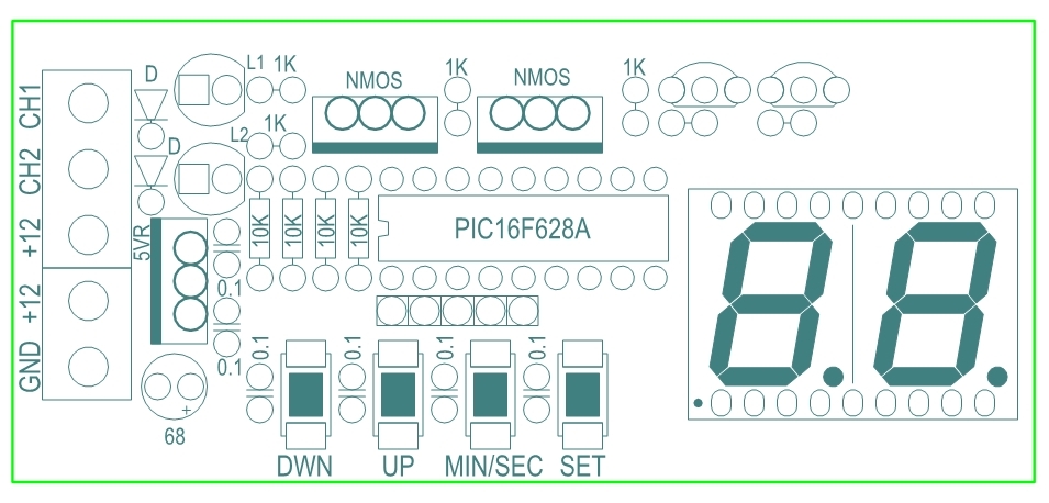

As Suggested Above. 2-Digit NMOS version with 7-segment and PIC16F628a.
Although two digits only displays up to 99, the timer can be extended beyond that in minutes and seconds.
Press set (display single flash indicating program mode), enter minutes, press set, enter seconds, press set and hold until display double flashes indicating time is saved to memory. This puts a default time in the memory and on power-up this time is loaded.
Press up or down to change seconds during operation. Press min/sec button to toggle between minutes and seconds, allowing up/down adjustment.
Edit: Board dimensions are approx. 1.5"x3"

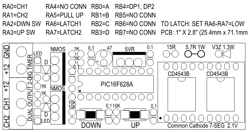

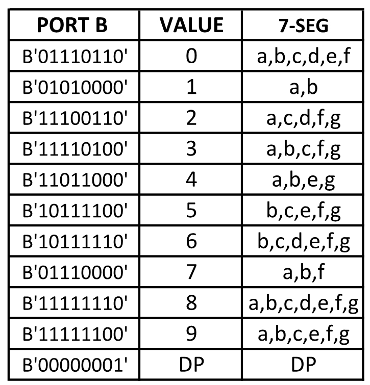

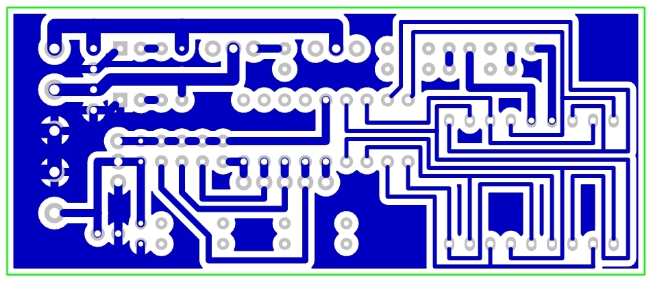

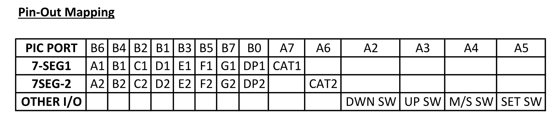

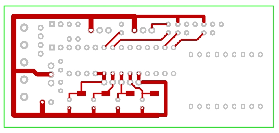

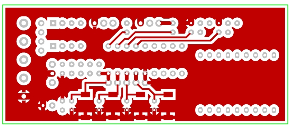

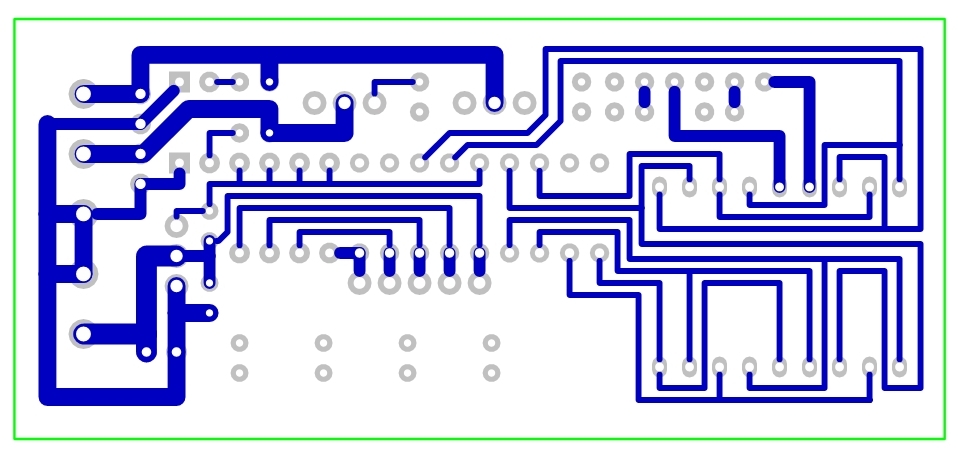

Here is the optimized PCB. If anyone is interested, I can create the Schematics, BOM and Gerber files in Kicad.

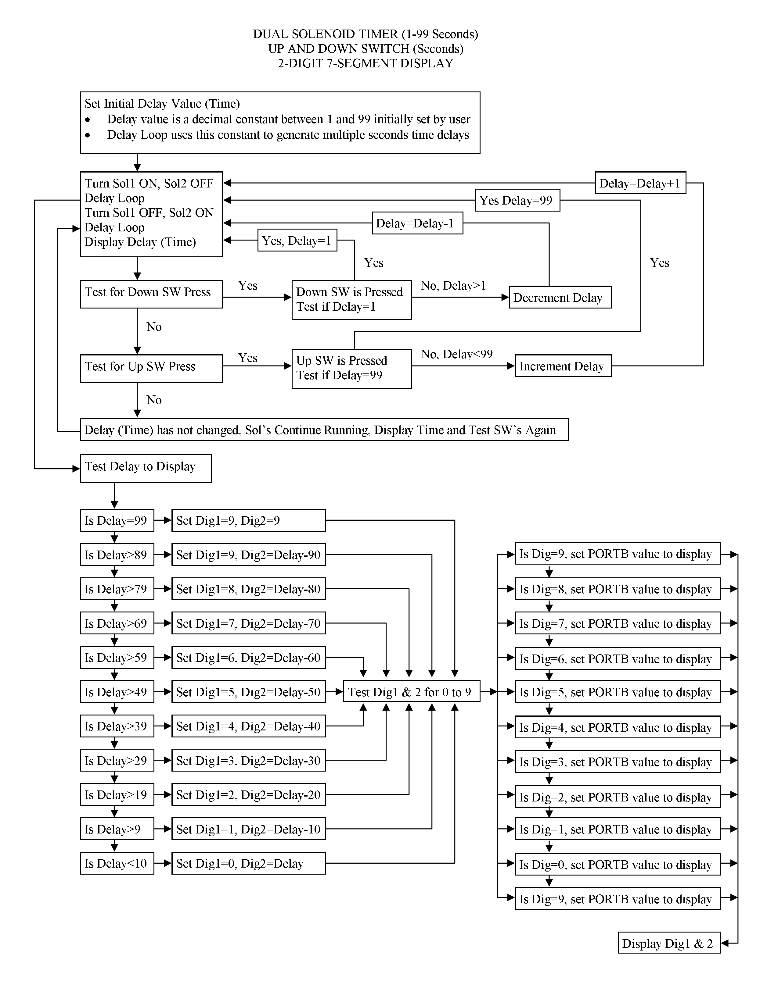

Edit 2/1/2017: Flowchart for Simplified Timer upload. 2 Switches Only (Up & Down), PCB to be modified, Two digit timer 1-99 seconds (no minutes). User sets the default time delay, from there on up and down sw's adjust the timer in seconds. Upon power down (reset), timer goes back to the default time delay.

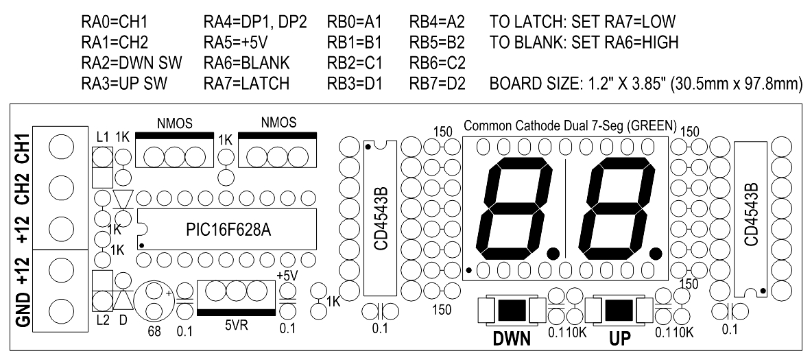

Hardware Updated, two LED Drivers and series resistors added. This removes requirement for multiplexing of 7-segments. Each digit is driven with a BCD to 7-Segment Latching (and blanking) driver. This mean once time is read and displayed, it can be latched to free up PIC to rapidly test SW-presses and run the solenoids without any timing constraints. Also DP LED of both digits are tied together and will blink each second during operation. Next I will be working on the code
Updated Version uploaded. In this version, the drivers are nicely tucked in under the 7-seg.

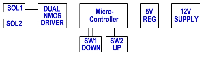

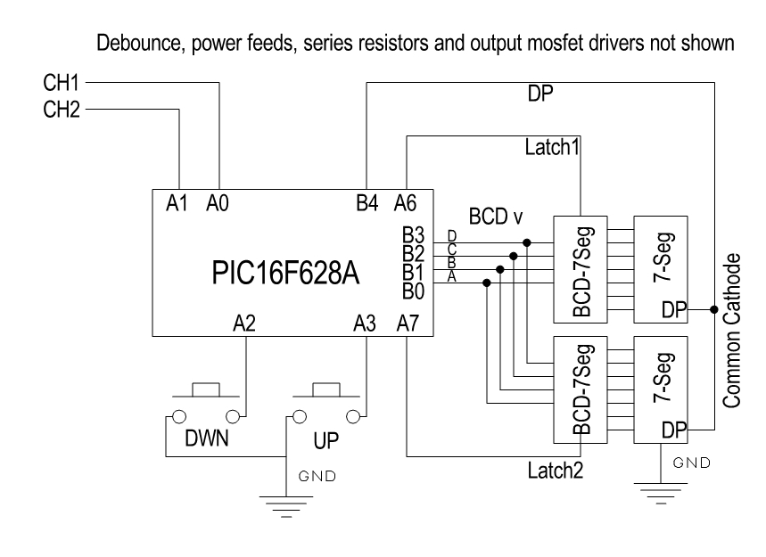

Here is a simplified circuit from logic point of view.
