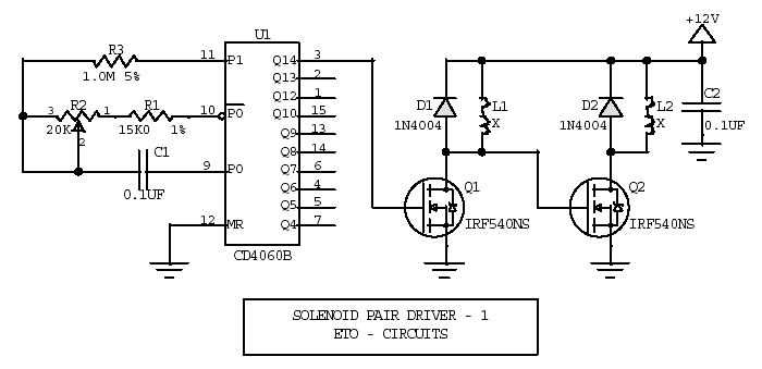

AK's suggestion of using a digital period generator would provide a Rolls Royce plus performance but with more cost and complexity.
Don't think so, especially when relying on a tantalum capacitor for long-term stability. Here is a first pass at the RR of timing circuits. The adjustment range for the on time for either solenoid is 27 s to 63 s according to this equation (derived from the 4060 datasheet):
t = 1.1 x R x C x 16384
Note that the number of timing components is the same as with a 555.

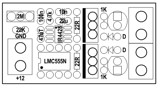

Here is a board in its beginning stages. It should give you a good feel of the part sizes and how close they could possibly get. This is with SOIC-8. I can change it to DIP-8. Also you have several choices of pitch for all caps including 47u-T. I am leaning toward o.1P to compact the circuit. Board is roughly 1inch x 2 inches.
ak
Very neat AG- I like your timing approach.
You missed one important plus of your design: accurate and consistent 1:1 mark to space ratio.:)
spec
I didn't miss it. I just thought the 555 crowd didn't need any more piling on.
Why does the 555 circuit have a 92:1 timing range? 1.3 s to 103 s seems a bit broad for a 2:1 requirement. A 1 M pot and 470 K fixed resistor gives a much more adjustable range.
Recommendations:
1. Open up the component spacing. This makes the board easier to assemble and much easier to troubleshoot.
2. Eliminate all component values.
3. Place a reference designator for each component somewhere where it can be seen after the board is fully assembled. Contrary to intuition, placing component values under the parts does not speed assembly or reduce errors, and makes diagnosis much more difficult.
ak
ak

Recommendations:
ak
ak
Steady on now.
Why not provide a wider range?
spec
Adjustability. The range in post #1 occurs over less than 30% of the 2 M pot's value, or about 78 degrees of rotation. Plus, depending on the pot being used, mechanical repeatability can be as bad as 20%. Minor component value adjustments triple the mechanical spread for the same circuit performance. Or, if you stay with the 2 M pot, you can eliminate the 22 K resistor.
ak
EDIT: never mind.
Adjustability. The range in post #1 occurs over less than 30% of the 2 M pot's value, or about 78 degrees of rotation. If you stay with the 2 M pot, you can eliminate the 22 K resistor.
ak
But that is just the intention- to give a wide range of adjustment as I said previously.
spec
I think we're talking past each other. Note - all of this is just opinion; no attitude expressed or implied.
An adjustment range that is a little wider that the requirements is good - it covers component tolerances. But one that is almost 50 times wider that the req can turn lots of adjustability into no *useful* adjustability at all. If the req range is a small percentage of the total range, selecting individual values (like 35 seconds vs. 40 seconds) can be very difficult (again, depending on the physical construction of the pot).

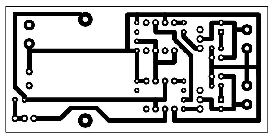

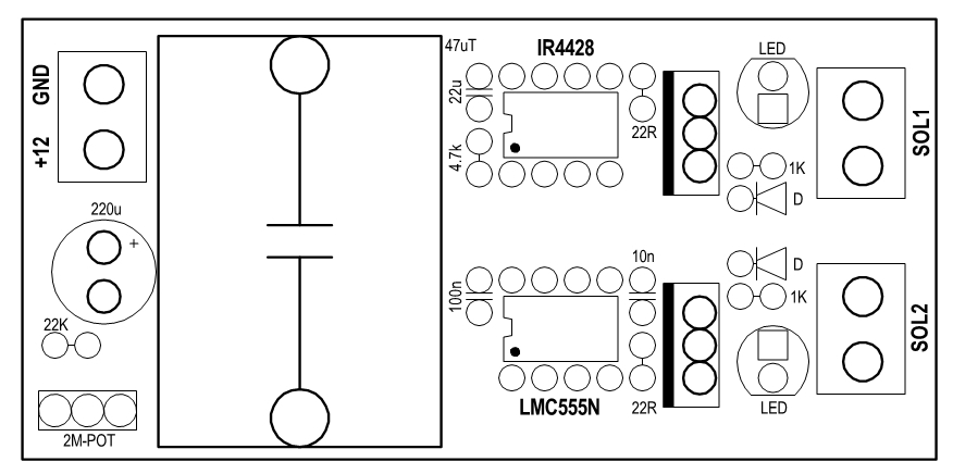

Here is a updated PCB.

Hi EG,
Can you please just check that you are working with the latest issue of the schematic of post #38.
