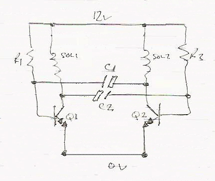

How about a traditional cross coupled-multivibrator with the solenoids as the collector loads.
You could do the whole thing with a couple of Darlington transistors (TIP120C), two resistors and two capacitors (and a prayer).:D
Also thought of that, but - the circuit puts -12 V across the base-emitter junction, and most transistors don't like that. You can clamp it at -5.1 V with a zener, but now you have a forward-biased diode in parallel with the base-emitter junction, which will make the large timing capacitors larger with single transistors, and really mess up the circuit with darlingtons. Almost done with my sch.

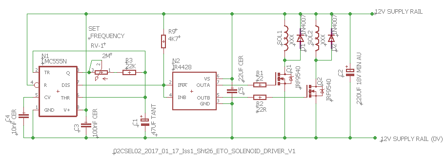

Spec. I am leaning toward using your circuit as its pretty simple and fits the requirements. Robust enough to use on higher current demands if needed. Could you add a couple of led's to indicate when the solenoids are powered on?
A good move I would suggest. It is a pretty standard configuration and provides good flexibility is terms of devices that can be driven and at high speed too if necessary.
Think I can manage that.:D

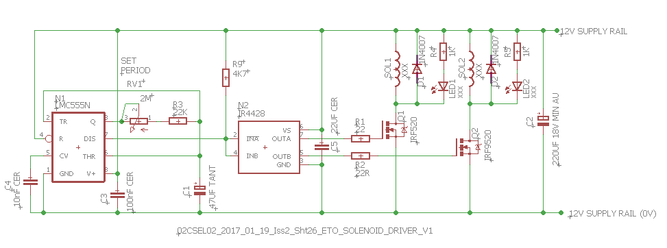

POST ISSUE 8 of 2017_01_22
Hi again RF,
Below is the latest schematic for the solenoid driver which includes LEDs to indicate when the solenoids are energized.
The LED forward current is set to around 10mA by the 1K resistors which can be changed to alter the LED brightness that you want. The working formula for choosing the resistor value is 10V/R = LED If.
ERRATA
(1) Change N2 to TC4428A
(2) Change C1 to metal film type, Kemet #: R60DR5470D50K
(3) Q2 should read IRF520
NOTES
(1) If the potentiometer is to be mounted remotely on long leads, as RF has indicated, the two signal leads must be twisted in a screened cable. The screen must be connected to the timer chip power supply OV line as close as possible to the timer chip Ov supply pin.
DATASHEETS
(1) http://www.ti.com/lit/ds/symlink/lmc555.pdf
(2) http://ww1.microchip.com/downloads/en/DeviceDoc/20001423J.pdf
(3) **broken link removed**
(4) **broken link removed**
(5) http://www.digikey.co.uk/product-detail/en/kemet/C1210C226K3RAC7800/399-11958-1-ND/5267671
SUPPLIERS
(1) C1 (47uF): http://www.digikey.co.uk/product-detail/en/kemet/R60DR54705050K/399-12459-ND/5730950
(2) C2 22uF, 25V, X7R, +-10% ceramic capacitor: http://www.digikey.co.uk/product-detail/en/kemet/C1210C226K3RAC7800/399-11958-1-ND/5267671

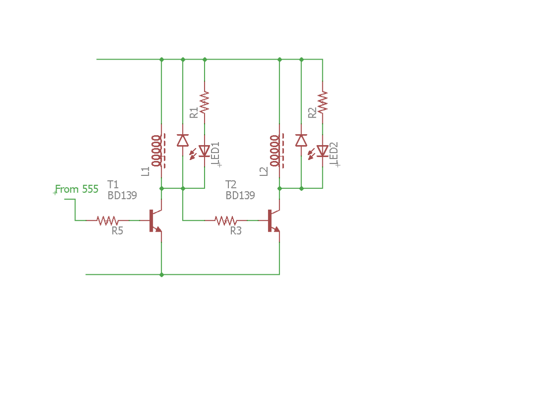

Personally, the way I would do the output would be the good old fashioned way. Something like,
Base resistors around 470R LED resistors to suit (800R or there abouts).
Edit, just checked data sheet and to get BD139 into saturation needs 50mA so if problematic change base resistors to 270R.

Is the pinout of 555 correct in this digram? Looks like pin7 and pin3 are swapped. Also no resistor between pin7 and 8 intentional?
Hi EG,
No that pin arrangement is intended.
Discharge gives a nice fast clean drive for the gate driver chip and the CMOS 555 Q output swings rail to rail so it generates accurate timing.
Good observation though.:)
spec
