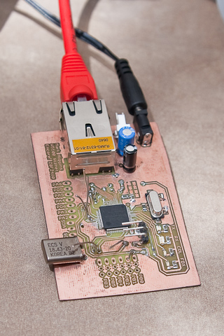

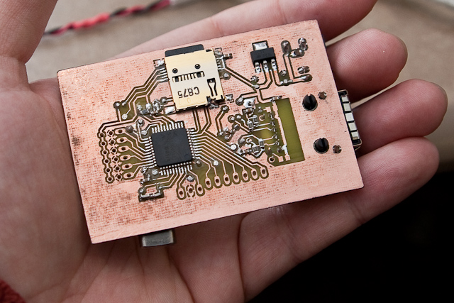

I don't know, this isn't all that complicated for me. I use the 'pocket' method, but I only tape two sides.
I use regular photo paper and I use a lightbulb to see through both pages. I usually keep my dimensions line on the print, which is a thin line all around the board; with lining up the via's as well, I can get it very well lined up.
I tape the two sides and place the board in it. Iron one side, then flip it and iron the other. I haven't found any need to 'pin' it to the board before ironing.

@ DirtyLude, nice looking boards you made there..
