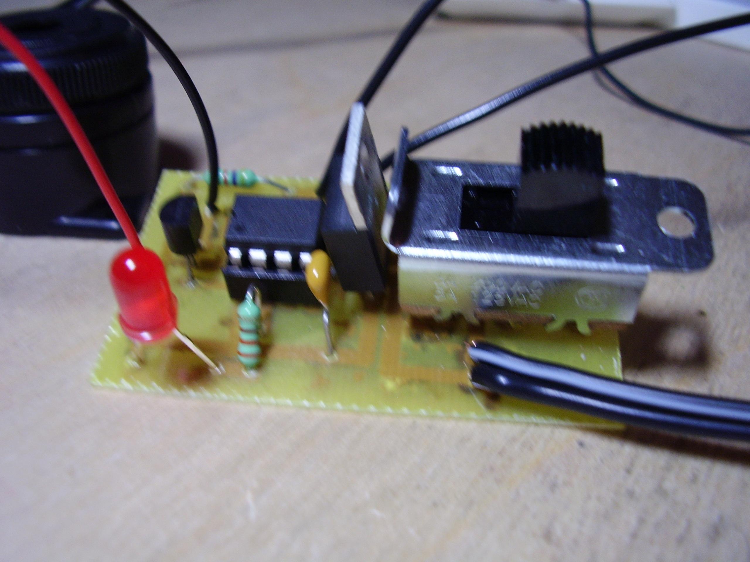

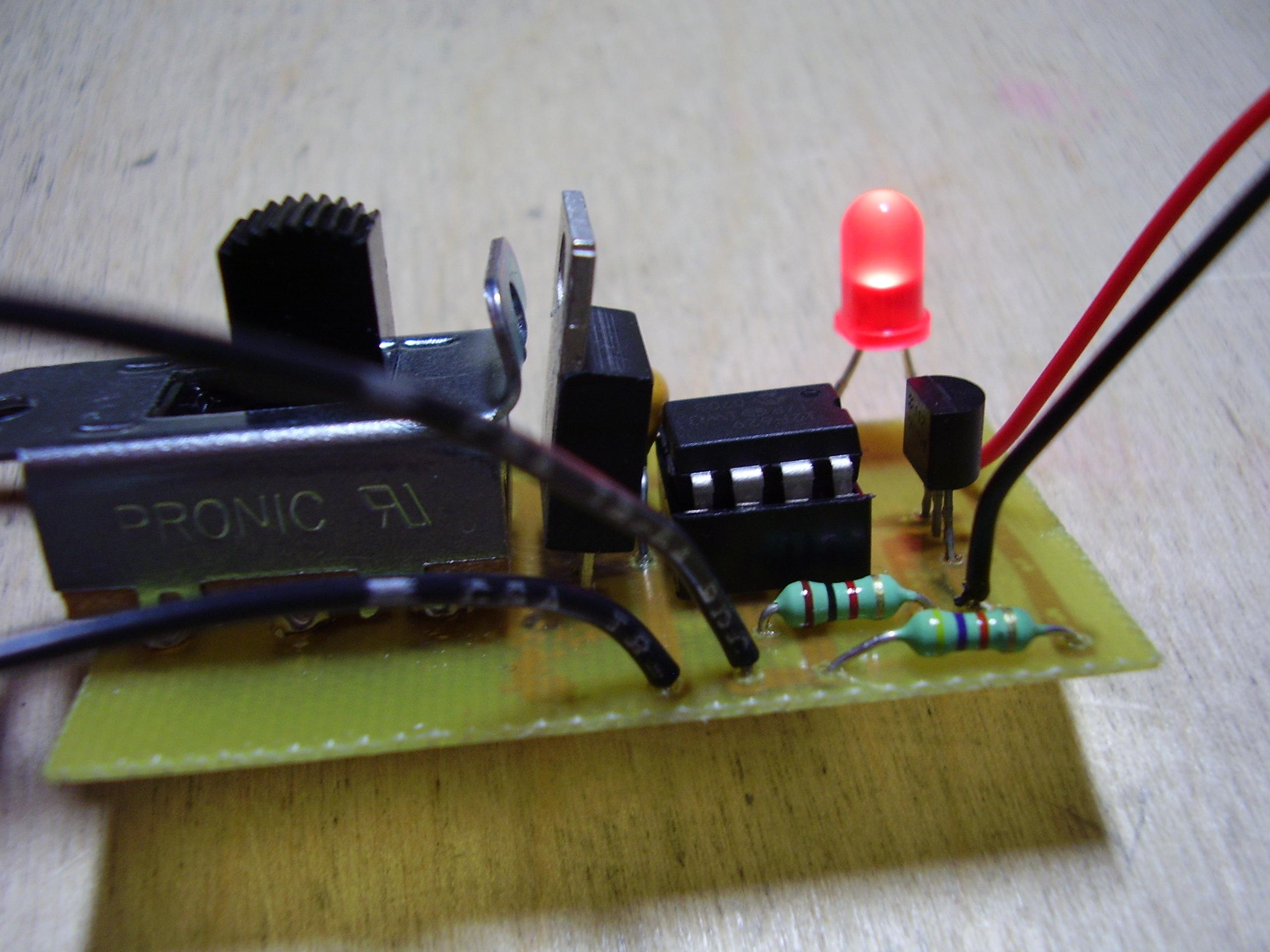

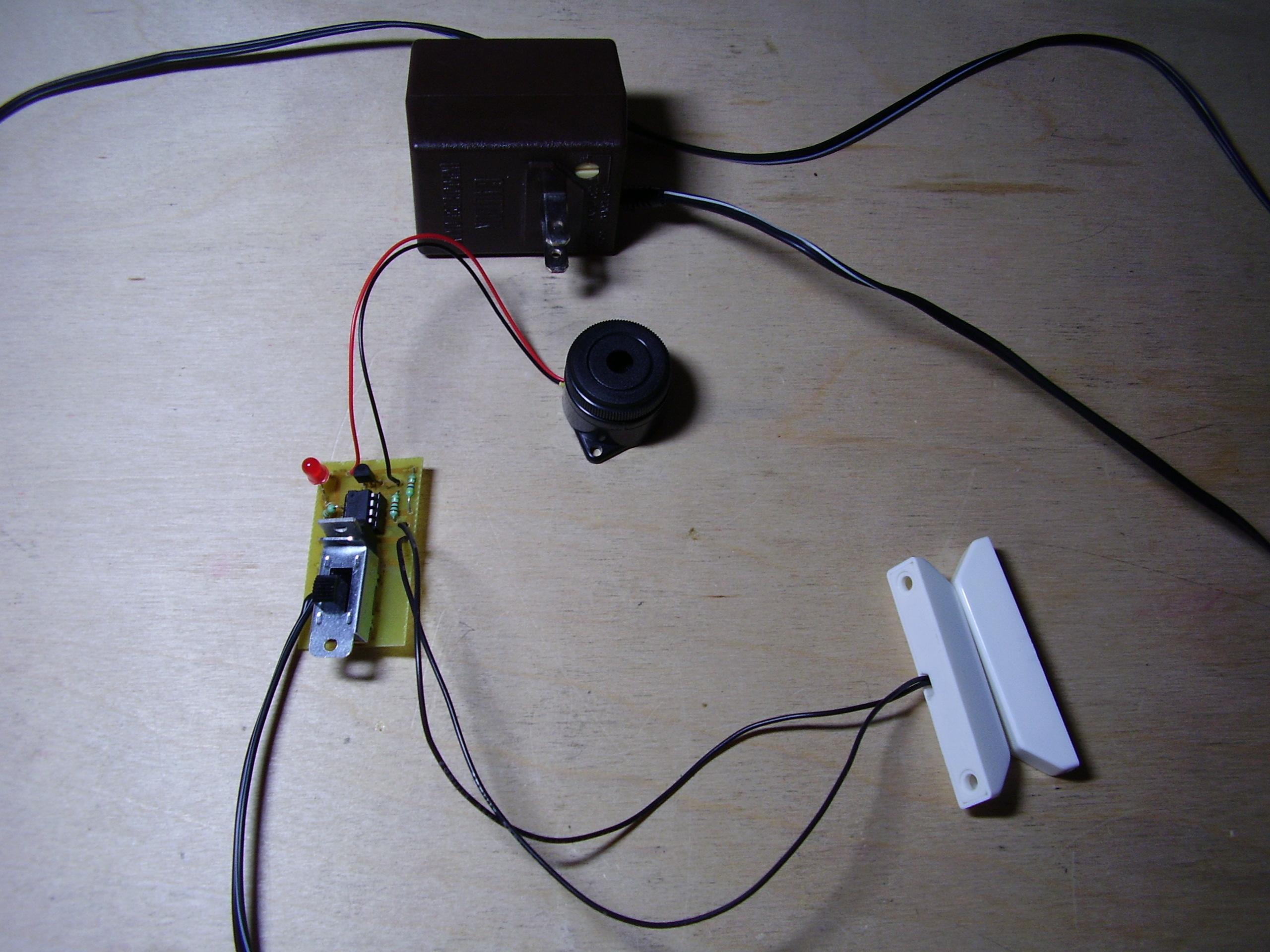

Here are some pictures before I give it away.

I made sure to ask the customer questions such as this.. He told me that since he runs his air conditioning throughout the summer months his door is is always closed waiting to be opened. (Like all closed doors do :p )
ARGH
This guy wont give me a break!
I just brought him the reed switch circuit.. all was good and he liked it..
THEN!
He explains it is for his back door! He is using that circuit to monitor his employees entering and leaving the store!
