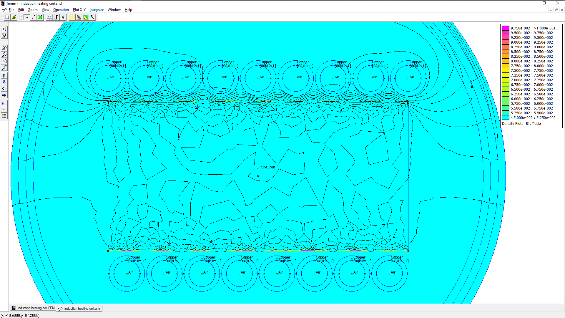

(I've been running a few sims to see if I could verify/demonstrate the skin effect:
Turns out the math is rather complex.

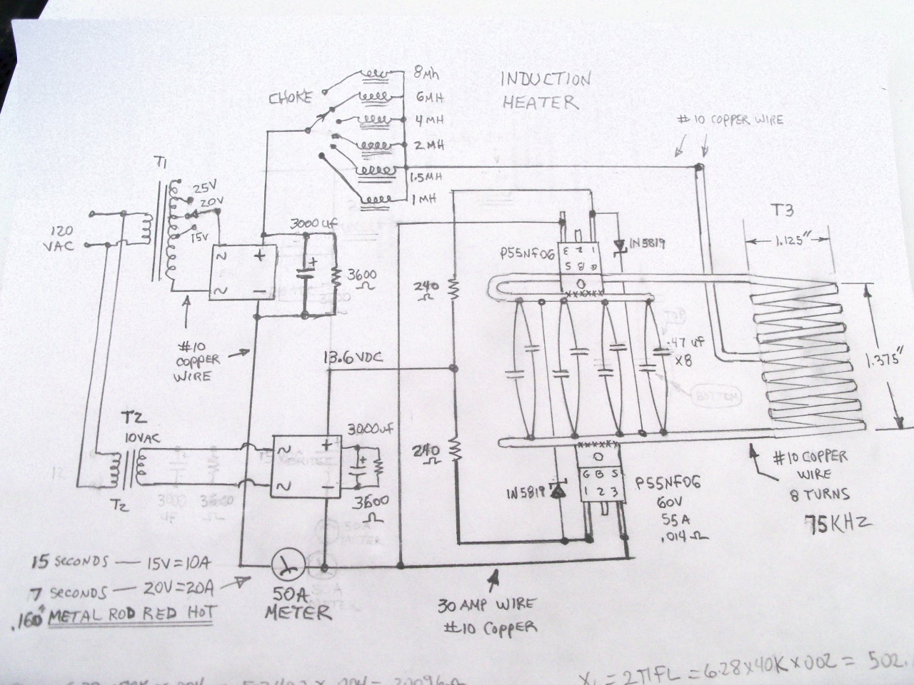

Induction heater testing circuit for a better H circuit. It runs good with 21v 34a. It is tricky to run it at 25v 34a current wants to suddenly jump to 52a then mosfets go BOOM. I have not had time yet to make a 8mh choke. Several other projects are top priority. I was sick 2 days now I am alive again, almost.

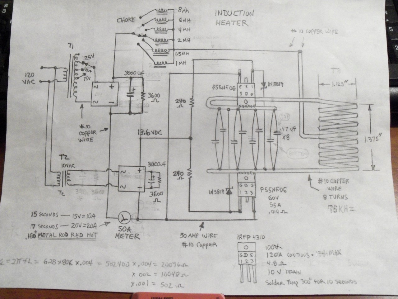

Today I was able to test circuit a little bit before taking wife to doctor. The IRFP4310 mosfets work better than the P55NF06. The 8 turn RF coil does not over heat just setting there with no load. I have no problem running the circuit on 20vdc 40a. Circuit runs good on 25vdc 40a & 2uh choke but if amps goes up to 45a the amp meter suddenly pegs out above 60a loud hum sound it must be pulling 150a when both mosfets explode. This circuit needs some type of safety over load current limiting??? I tried all the choke coils 8uh lowers the general overall current but circuit can still peg the meter at maximum amps and explode the mosfets. I think I need to solve this over load problem before building the H circuit. I had no volt meter on the PS so I don't know if 25vdc PS dropped lower when the circuit over loads, it probably did.
It sounds to me like you're reaching a point where one mosfet is not fully of when the other turns on. At that point you've got a dead short through the mosfets.
What do the waveforms look like for the two mosfet drain terminals as you raise the current to the point of failure?
