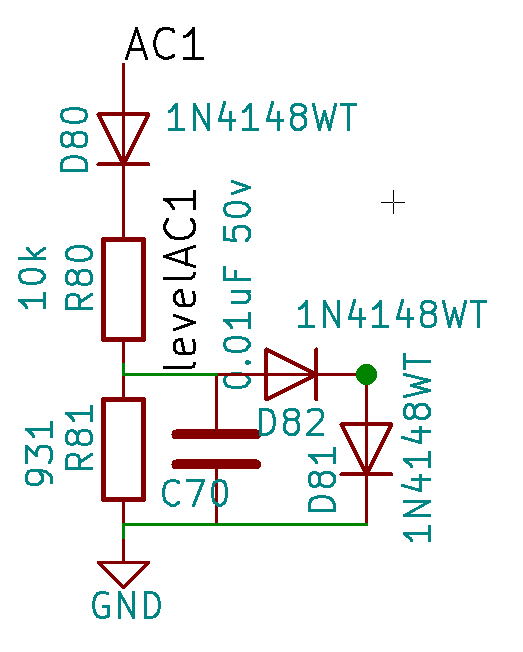

Hi, I have a requirement to measure a voltage between 0-8.2V (approx) from an AC line which swings up to 100V. The ADC takes 1.024v.
I came up with the following circuit:
The 10K is the highest the PIC recommends, the two diodes are a cheap way of ensuring the voltage doesn't rise above the PIC's. Everything withstands 1W. Resistors are 0.1 %. Resistor values are rough for now.
One area I haven't considered is the diode D80 and it's voltage drop, which I have to ensure is accurate across the current draw - this is 0 to 0.71mA.
While resistors have tolerance what's the diode equivalent? If there isn't one per say, which type of diode is the most suitable?
But diode wise is it possible to purchase with a tight voltage drop tolerance at a particular current/temperature?
No.
Lack of isolation aside, might I suggest you stepdown the AC with a resistive divider and THEN rectify it with an ideal diode (an op-amp circuit)? If the ideal diode circuit (which I assume will be using a unpolar supply) can't tolerate the negative swing, then place a series current limiting resistor and clamp diode in front of the ideal diode circuit so the stepped down AC can't swing in the negative direction.
Another consideration is how low a voltage a meaningful measurement on the AC actually has to be? Because 0.7V out of 100V is 0.7% error which might be acceptable and if the lowest voltage you expect to measure is something like 20Vp, then that 3.5% error might also be acceptable.
Why not put the reverse diode across the capacitor, rather than in series.
That limits the reverse voltage and the other forward diode (D82) blocks that from the ADC.

Diode drops are not accurately predictable under normal circumstances. That's because their drop depends both on current and on temperature. For sure the drop is not constant under most conditions because current and temperature both usually change significantly. This all is however relative to the application as i will explain.
For example, at 0 amps the diode drop is very nearly zero, and for a small current like 10ua it might be 0.5v and at 100ua it might be 0.6v. For a temperature increase near 25 C we see roughly a change in voltage of -2.2mv per degree C.
As you can guess, these changes are not significant for some applications.
For example, as a rectifier that must rectify very low voltages like 1vac, the diode drop is comparatively close to the signal voltage so there will be a large effect on any measurement. With a larger voltage however like 100vac the diode change in voltage, even if in full such as 0.7v, represents a change of less than 1 percent and so it may be entirely acceptable.
So the change in diode voltage is subject to a comparative analysis relative to the application.
The easiest way to get a handle on this is to replace the diode with a zero volt drop and analyze the result, then replace it with a 0.7v drop and do the analysis again. If the two results do not affect the application significantly then you can probably put your worries aside. If not, then you need to seek some other solution.

"Diode voltage drop" and "accurate" don't even belong in the same sentence: the forward voltage drop across any diode, no matter what type, varies drastically from unit to unit, even within the same production run from the same manufacturer.
NEVER use a forward-biased diode as a reference voltage. EVER.

The second diode will always clamp the output voltage to only about 0.7 volts. I am assuming that the monitored node is where the green dot is drawn.
No, the green dot can be ignored, the reading is taken at "levelAC1"
To clarify, the ADC is 10 bit from 0 to 1.024v. I'm working with an AC voltage up to 100V. I only care about 0-8.4V (or similar I can't recall the exact voltage right now).
The 10K resistor is the max the PIC recommends.

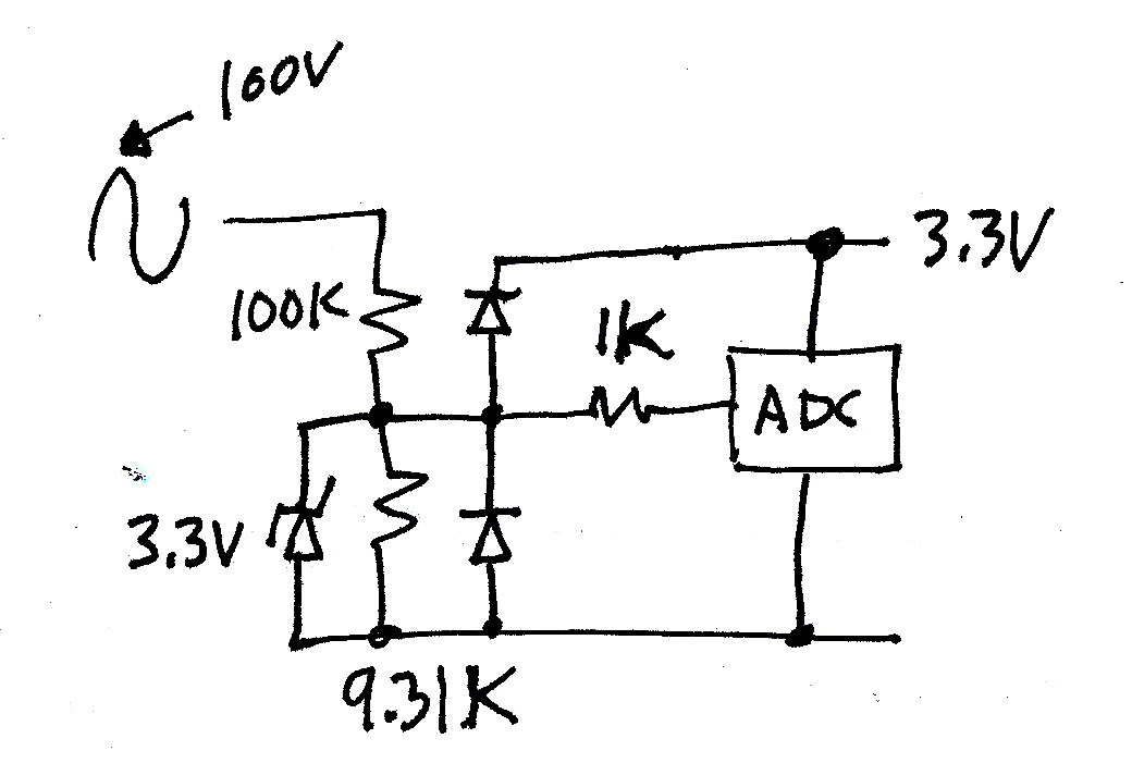

I used higher values than you. Even now the input impedance is about 10k.
The ADC input should be limited to -0.6 to about the supply voltage. (see zener or the the two diodes)
Any voltage above or below range will be shunted off to ground or supply or to the Zener.
edited----
Use Zener or the two diodes. You do not need both. Both is OK. Look at the input range "absolute max". Most likely slightly negative to slightly above the supply.
The signal you are measuring dose not pass through a diode so the diode drop does not matter.
The 100k impedence is far too high, acceptable at 100V but nominal is between 0 and ~8v. At this voltage the ADC won't get current fast enough to be accurate. I went to the end of acceptability to reduce loss at 100V as much as possible (even then it's a big resistor). Microchip say 10k max at the voltage of interest.
The 3.3V zener won't have enough current to be operational at lower voltages. An LM4040 or similar would be more likely to work but I've been there before with this and 47k was max. Assuming it doesn't work too well at say 7v the voltage would go through the top diode and cause problems.
The ADC (PIC) pin is rated -0.3v below ground. The bottom diodes limits it to -0.7v, which seems close.
