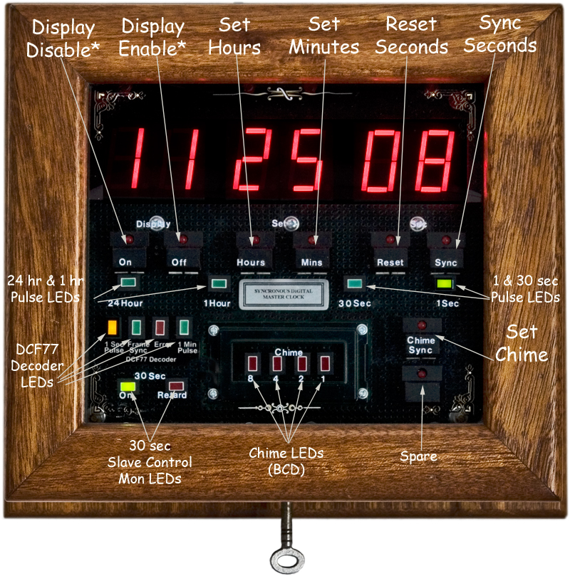

Master Clock pics
Here are a couple of pics of the modified Master showing main display panel contols and also a view from below showing control switches.
Note I have added these pics to my Masterclock Word doc see temp download link above.

Master Clock with DIY Slave Clock made using 30 sec movement from an old office clock. you can connect as many of these slave as you wish using extra relays or transistors as required.
All slaves can be advanced or retarded from the master clock.
Also 2 large 12" dial clocks with 30 sec and 1 sec syncronized movements. 1 sec quartz clock driver diagram also included.
The clock now chimes via a 4" longcase clock bell and 30sec clock movement(see pic).
