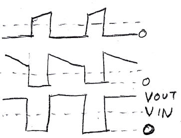

There are two different types of boost power supplies. This is very important.
Continuous:
Switch current, Diode current, and switch voltage.
Discontinuous:
Switch current starts at zero and ramps up. (slope is set by input voltage/inductance)
Diode current starts high and ramps down to zero.
Voltage has three states.
There are three times. Input power, output power, dead time.
Dead time = no current.

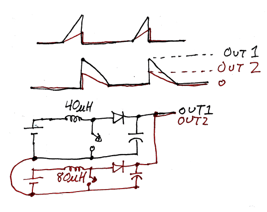

Continuous:
The red circuit has 80uH so the current ramps up slow. The black circuit has 40uH so the current ramps up faster.
Assuming that the two batteries are of the same voltage. The input current is set by the inductor.
Both switches have the same duty cycle.
The two batteries are your two sources of power. (solar & wind)
The two outputs are connected together to charge up one battery.

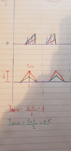

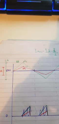

These are great drawings thanks! So looking at your drawings, it seems to me that the rms voltage of both(red and black) is clearly different. The red one will have much lower RMS current and less contribution towards the load. Am I right?
I am still a little bit confused how does changing the ripple change the boost converter output current. I understand that
I believe I am confusing the continous and discountinous mode. In continous mode, the changing the ripple current does not change the rms current value because it is compensated by the negative side of the ripple.
https://www.facebook.com/#
But in discontinous mode, twice larger ripple would mean twice larger rms current isnt it?
49763031_2151028658291829_6590979623289356288_n.jpg49810334_229533031258982_2353064186063355904_n.jpg
If a boost converter is working in a discontinous mode, I can apply the triangle area formula or integrate it to calculate the average current. It is clear that the average current is twice bigger in red case. But continous mode is not the same. Am I right?
Right.
