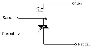

Referring to the attached graphic, I think you could detect a blown or removed bulb by monitoring the voltage at the line identified as "sense" while the triac is turned off. You could periodically but briefly command the triac to stop conducting and monitor the "sense" voltage while the triac off. If the line voltage is present, the bulb is OK. If there is no voltage present, the bulb is blown or removed.

I was not suggesting connecting the mains directly back to the PIC. I was attempting to convey the concept of monitoring a sense voltage to sense a blown bulb. Of course isolation is a consideration and in this particular case I would use opto isolation.
Hmm i dont understand about checkin the triac when its off.. what if i have commanded the triac to be on all the time...i.e. 100% brightness... and i thought after a triac has been triggered, u cant turn it off until it passes zero (where it turns off anyway)
At 50 Hz, there is a pass through zero every 10 mS and at 60 Hz it occurs every 8.3 mS. You should be able to periodically command the triac to turn off, read the sense line and turn the triac on again without noticing that the light was off for a fraction of a second.

The triac can be turn off by removing the gate voltage. When the gate voltage is removed the triac will turn off on the next transition through zero.
With the triac off and a good bulb installed, the full line voltage will be present at the sense line when measured with respect to the neutral.
If the bulb is blown, the sense voltage will be zero when measured with respect to the neutral.
The circuit will work with the triac in the neutral line and I've shown it there specifically to allow measurement of the sense line with respect to the neutral.
I could have shown the triac in the line side but that would necessitate measuring of the sense with respect to the high side of the line.

The line voltage does not have to be connected back to the PIC. An opto-isolator can be used here. As you suggest, a transformer connected across the triac would provide isolation but unless the transformer primary was a high impedance, there would a current draw when the triac is off, resulting in the bulb be slightly illuminated even when the PIC has commanded the bulb off.
